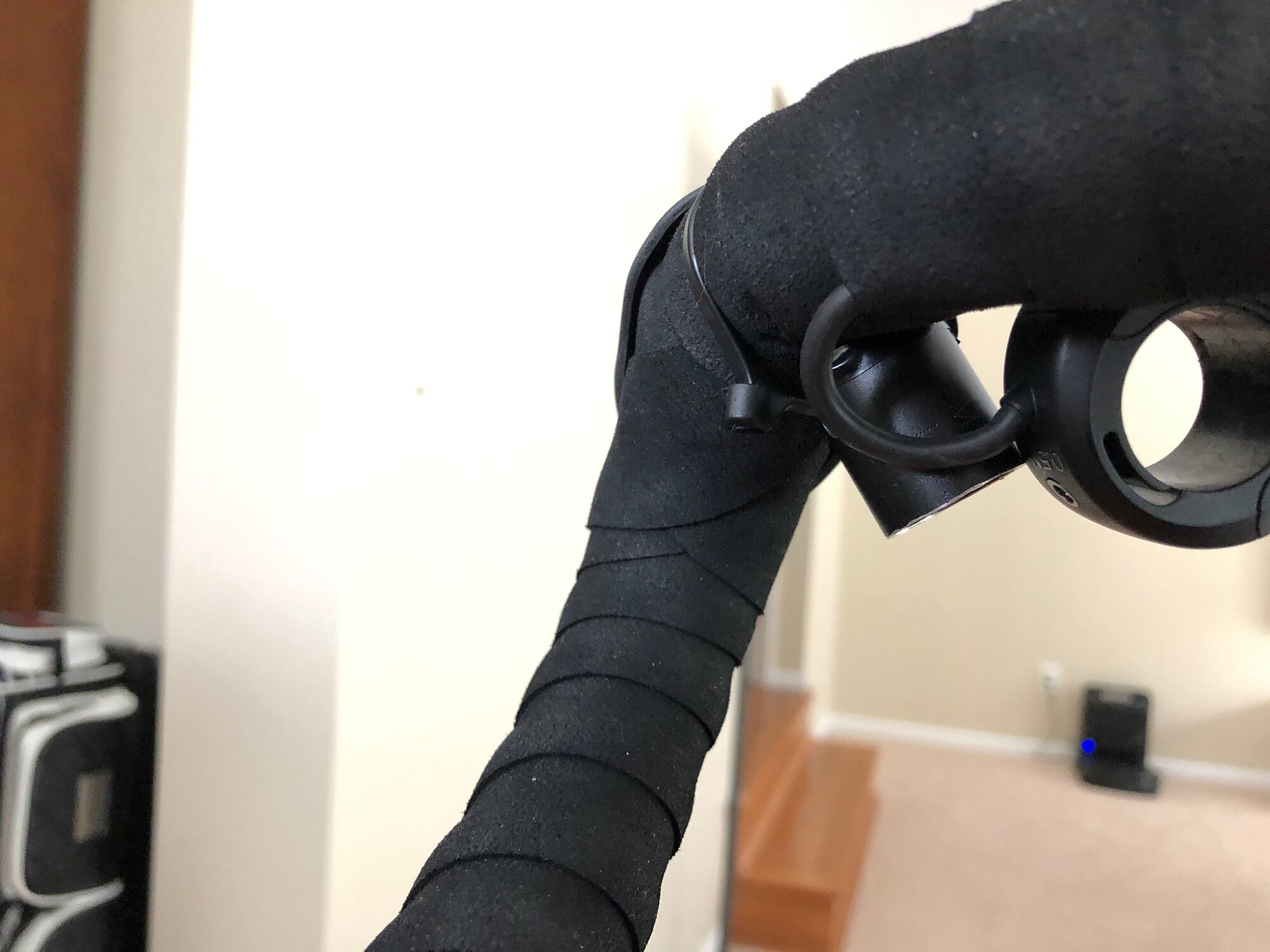

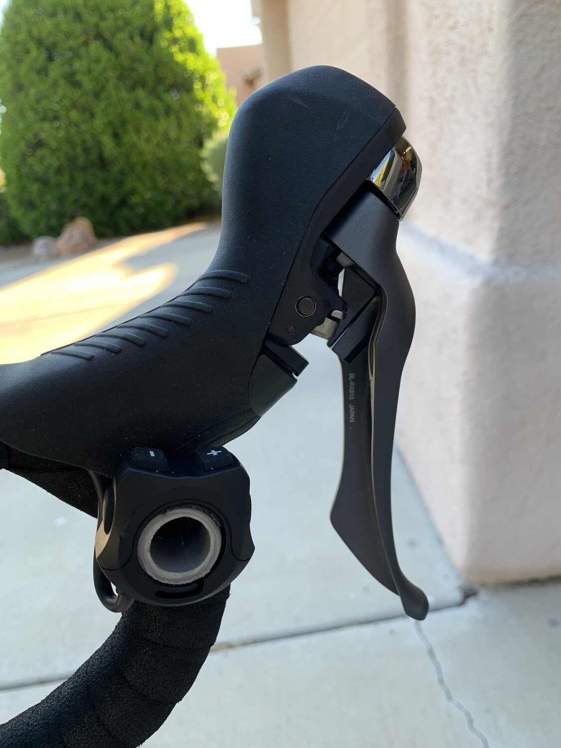

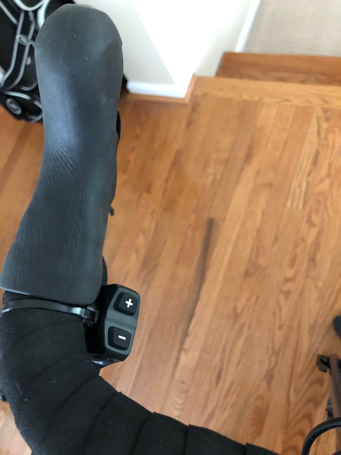

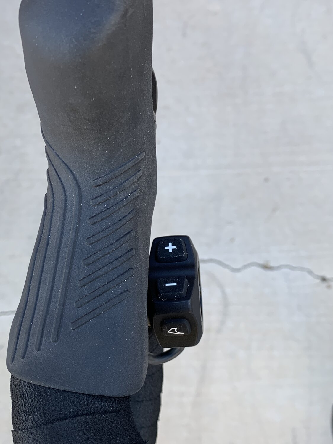

Hi everyone, I was able to get this working and put a test ride on it. Everything works as expected. The remote (Specialized PN S194200007) let's you run up "+" the modes 0 (no assist), 1, 2, 3 and back down again with the "-". Also intact is the Turbo button at the top which takes you from any mode to Turbo. And at the bottom is the walk assist button if you want to walk along side up a hill, etc.

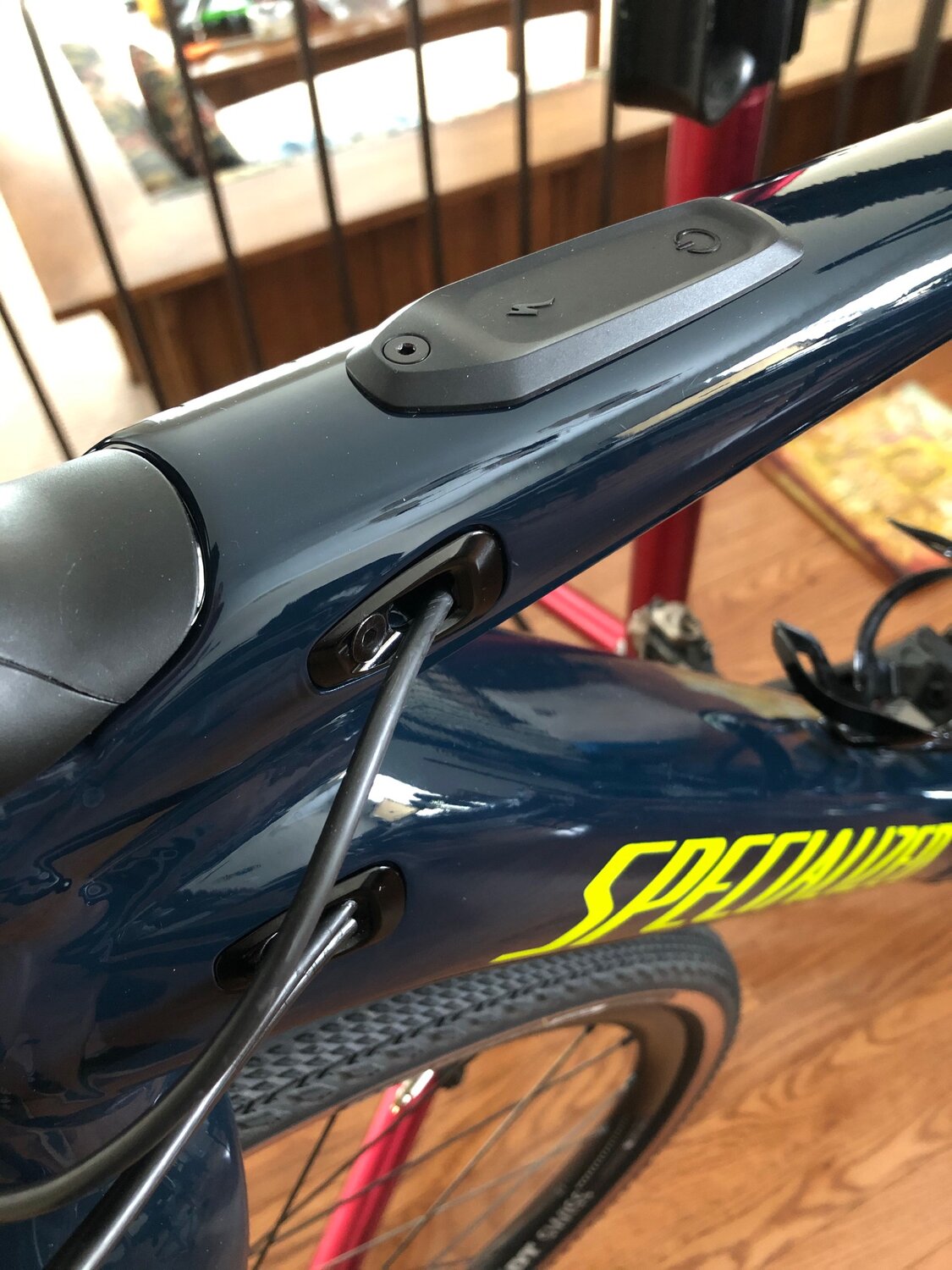

How do you do this? I'm not going into ever excruciating detail but basically here it goes. The remote will plug into the open connector on your TCU (the unit in the top tube)[you need a Torx T-10 to get that open]. I removed the unused port on the left top tube and basically milled it out so that the connector could pass through (too small as it is on the bike).

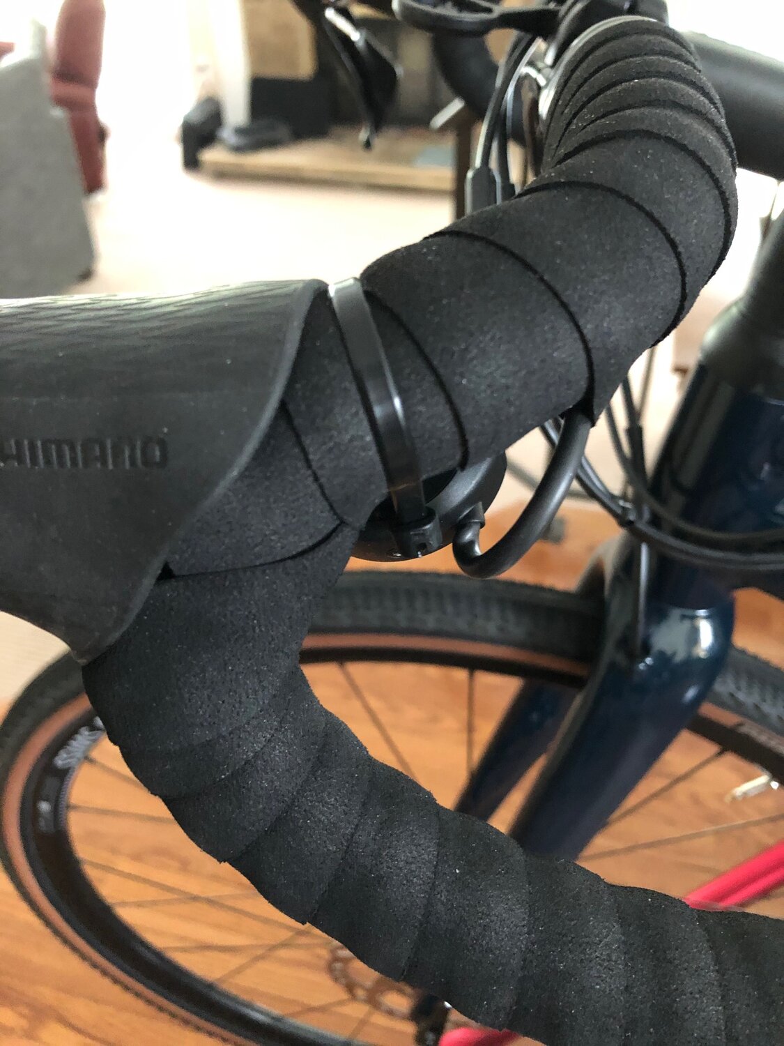

Then you need to mount the remote. I opted to place it as you can see on the left bar. The remote wants to see a specific mounting condition. A 7/8" dowel or bar. For now I cut off a length of MTB bar to do this. At the end I drilled a hole through all the way so I could pass a cable tie for mounting. I really couldn't find a way to mount this dowel without an exposed cable tie on the drops. I did hide the connector wire under the bar wrap best as I could.
Future plan is to fabricate a black nylon dowel and replace the handlebar end since that has some sharpness against the handlebar and wrap.
My 90 minute test ride was great. Just slip your left hand back a touch on the hood and choose your mode. No more fumbling with the top tube at all. I like to ride with as little assist as possible but have an easy way to adjust the mode, and this does the trick. Wish Specialized had a drop bar solution for us, but for now this is great. Let me know if you have questions.
No programming or anything is required. Power down, connect, power up...it works.

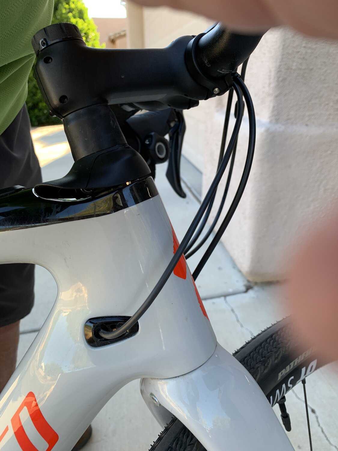

I received my controller yesterday afternoon and had it installed by dinner time. It's a great addition to the bike. On the carbon Creos, the blank, unused port is on the right side so the wire coming off the left bar makes a nice clean routing into the frame. I used a piece of plastic pipe with just under 7/8" OD to mount the remote. It was easy to cut slots in each side to run the zip tie. I ran it so the head of the zip tie is inside the pipe so it's not visible.

I just got back from a ride and it's a real improvement not having to take my hand off the bars or my eyes off the road when changing boost levels. I had a strong tailwind coming home and I could drop to zero boost with just push with my thumb. It's well worth the $66 spent.

No, not really. The remote we are using has four buttons. No doubt you could gut the current remote and find the contacts and probably put then under a hood or something. Or if you knew how the wiring works maybe even adapt SRAM blips or a Shimano remote to the bike. I think you would have to but the remote so that you had a way to plug into the bike (unless you are OK with cutting into the harness inside). For now, this is WAY better than no switch for sure.

Is it possible to mount this remote on the stock handlebar? Or is the handlebar diameter > 7/8" IE: 15/16?
No, the remote is designed to mount on a flat bar which is 7/8". The road bar is larger diameter. You'll need to make a 7/8" adapter to mount the remote.
