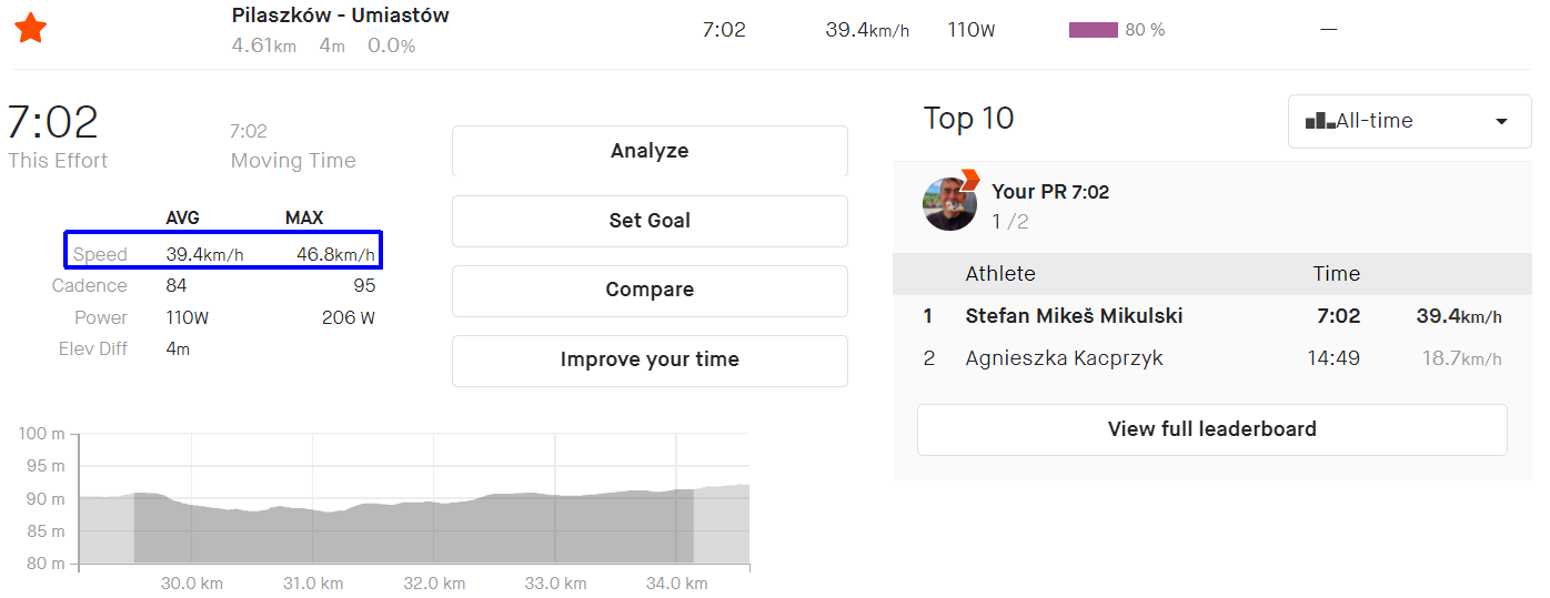

I respect your mods. I only want to say I can get to 28 mph with a 38-11t gearing on my full power Vado (the original chainring was 48T there). It is only the matter of your cadence (my max cadence on that effort was 110 rpm; I hit 29 mph at cadence of 95).
The max speed was 29.0 mph there.
