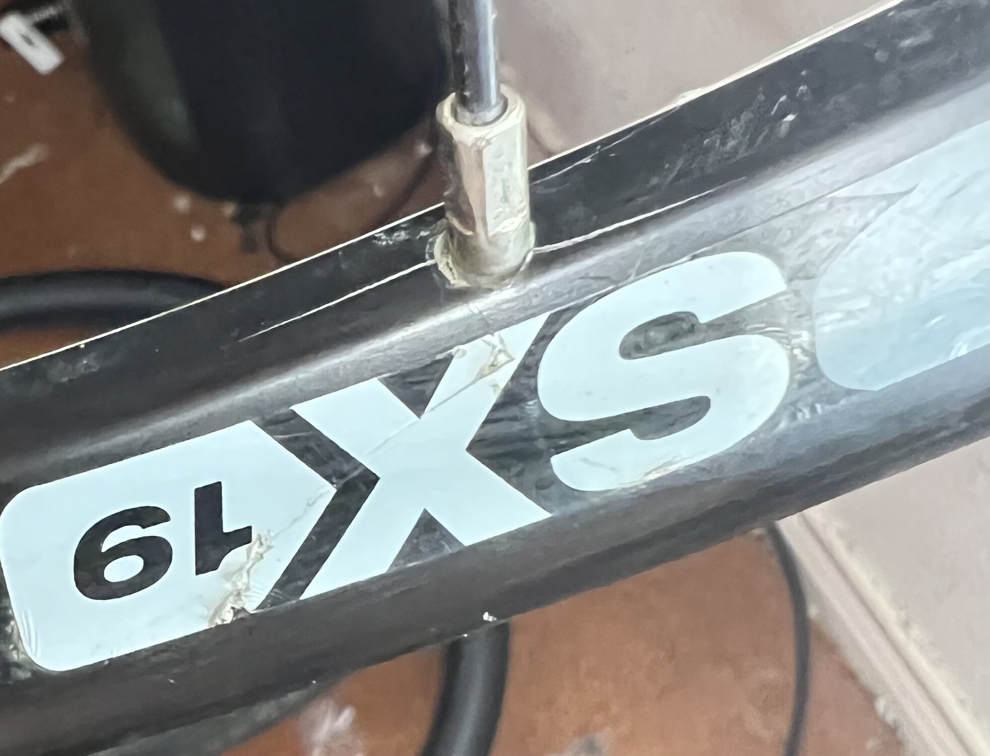

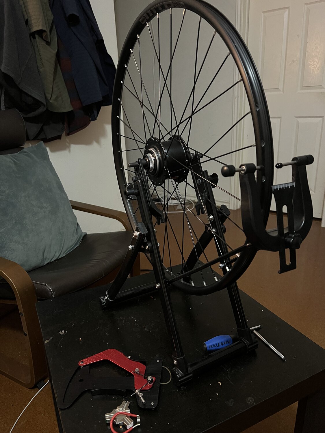

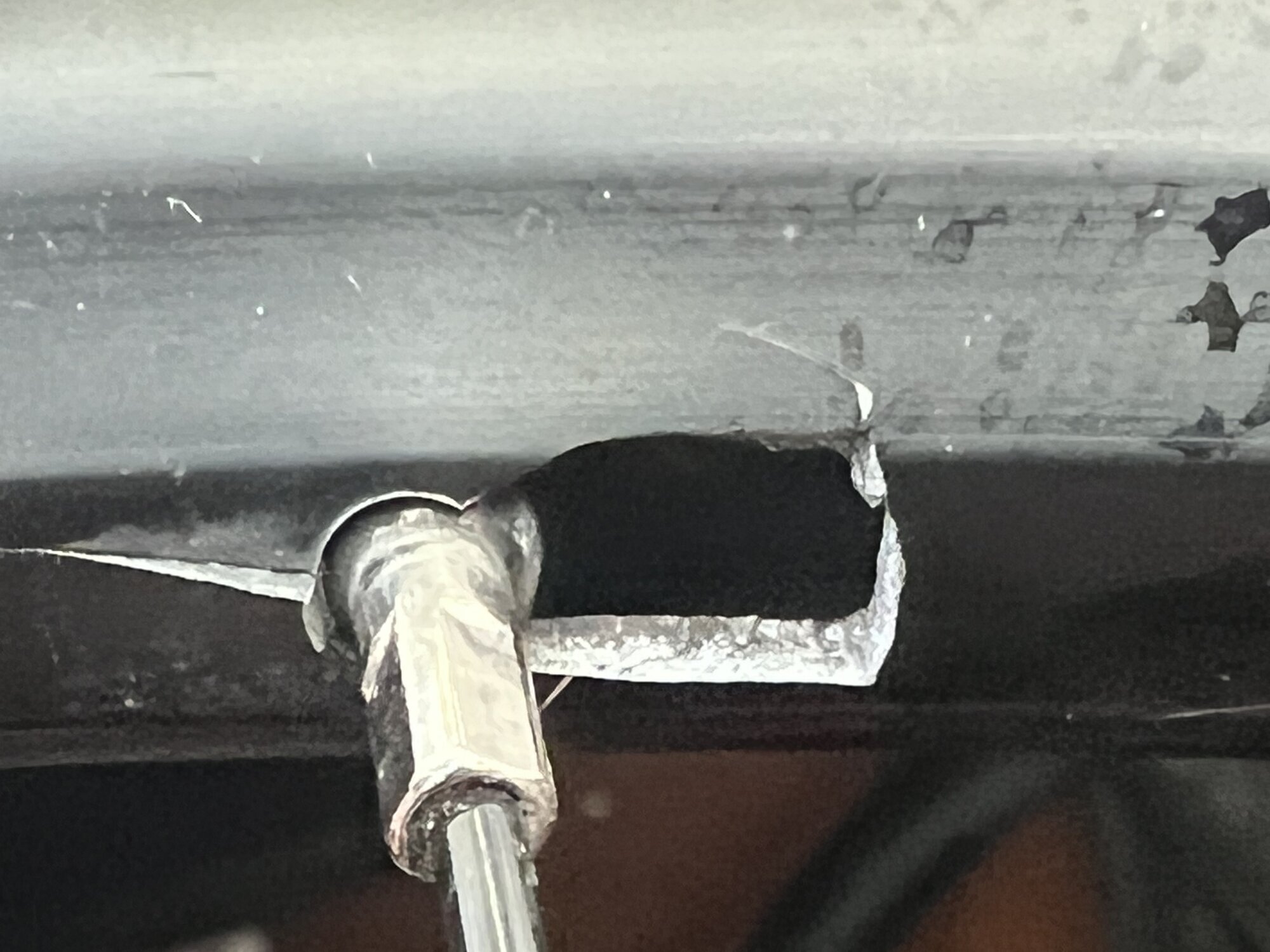

While I have been happy with Priority's warranty coverage, thus far, when I contacted them about a half-dozen broken rear spokes and, eventually, the WTB rim developing a bunch of cracks around the spoke bed, they did not offer any warranty repair of the rear wheel. They did refer me to WTB for their 2 year coverage of the rim which was replaced. I would have to get the wheel rebuilt, however. I ended up buying the spokes and a new Shimano hub and building the wheel myself.
