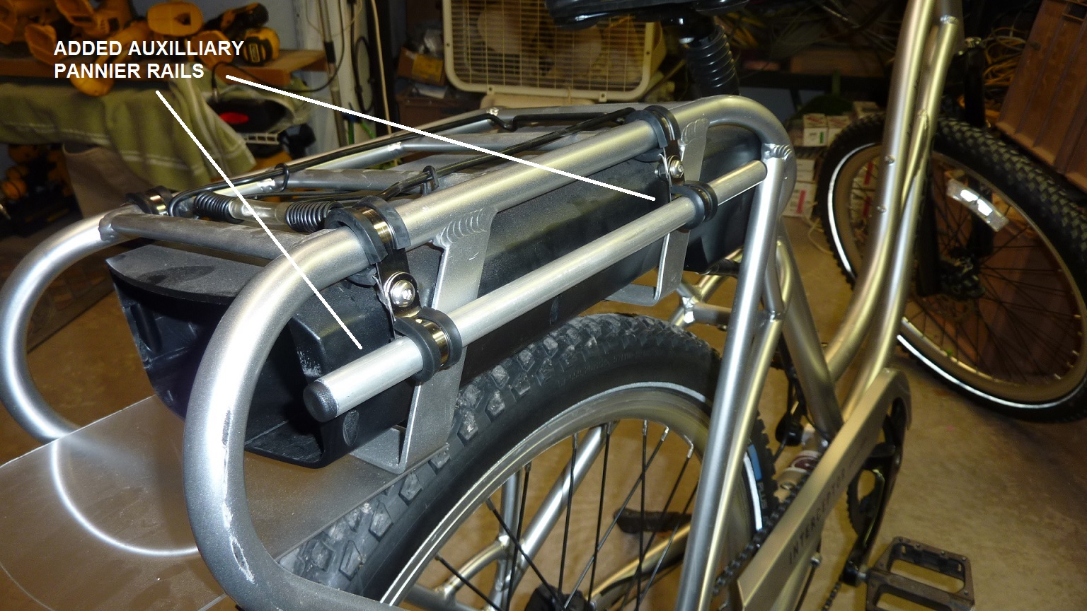

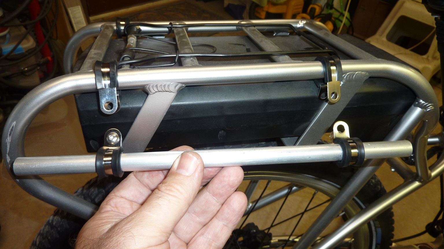

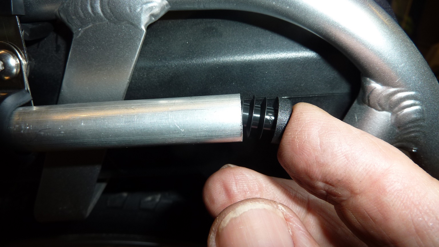

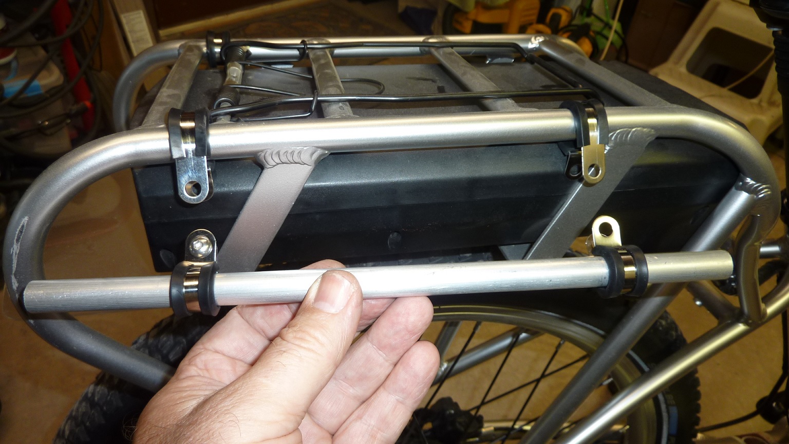

In order to use my existing panniers, I made this simple adapter using pieces of 1/2" aluminum tubing and insulated cable clamps:
For a more finished look, you can add these plugs to the tubing ends:
They are stronger than they look and don't mar the bike finish. I've been carrying 10 lb. batteries in each pannier for 5 seasons now with no problems. I can supply links to the necessary parts if you're interested.

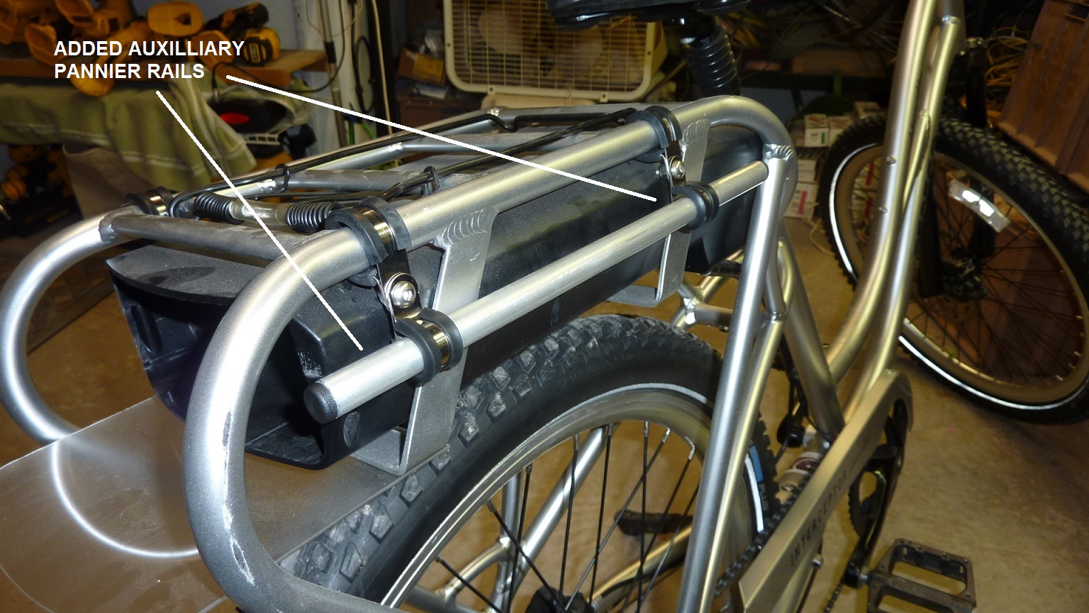

View attachment 157740 View attachment 157741 View attachment 157743

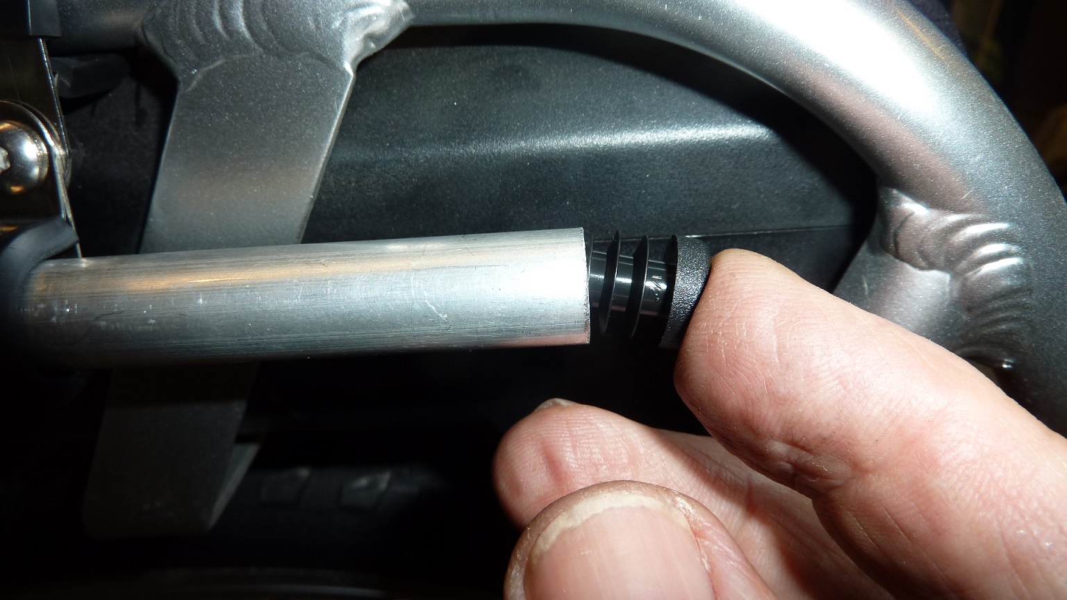

That looks great - if you get a chance the parts would be great!

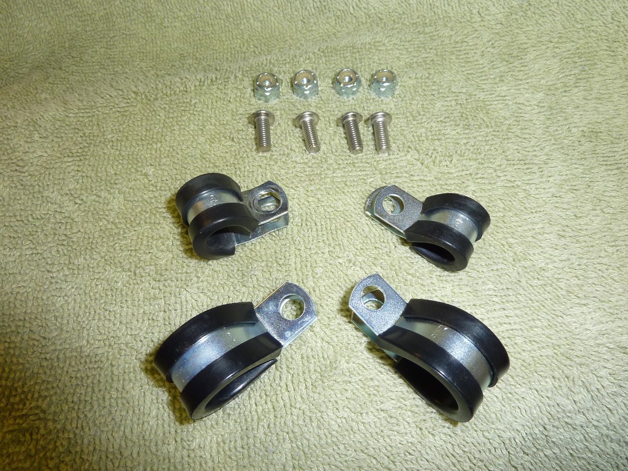

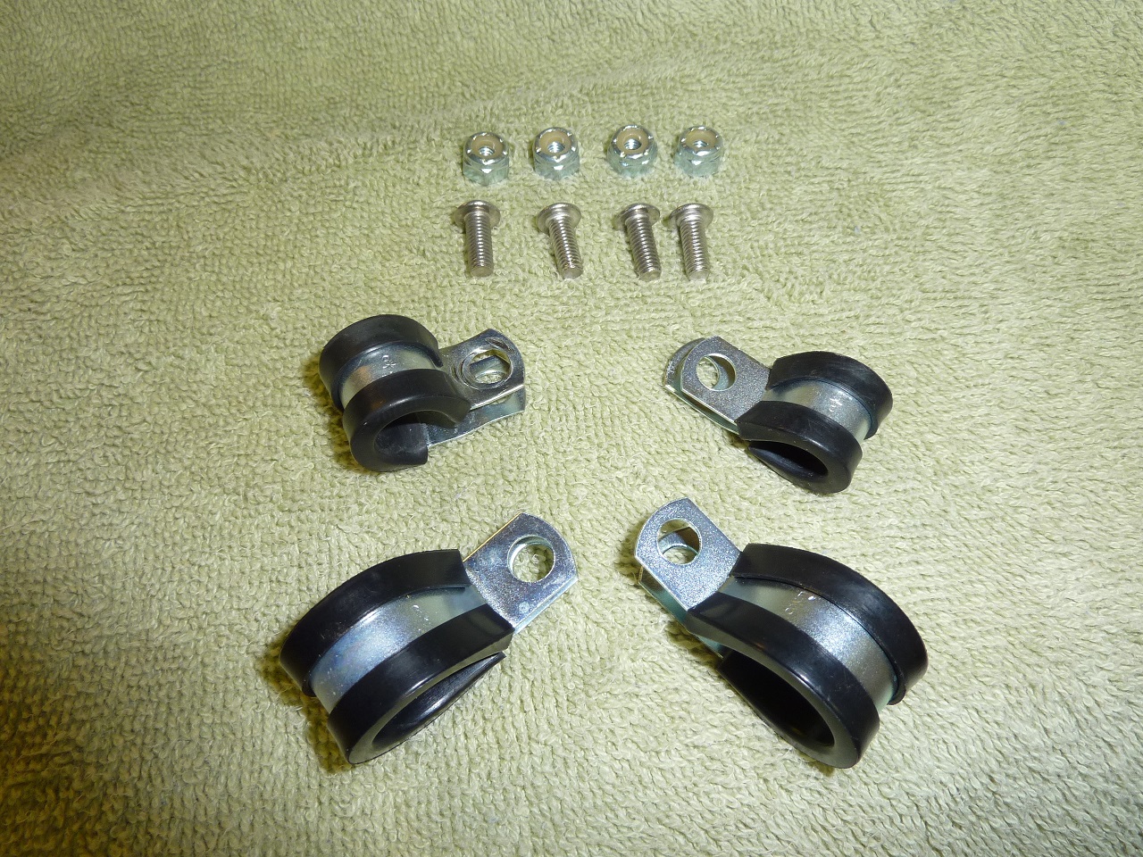

Insulated clamps:
Check the tubing diameter on the rack and get the appropriate size.
1/2" Aluminum tubing:
End plugs:
Stainless cap screw:
Stainless lock nut:
That's a very nice mod, 6z. I think I have some tubing so I might order the other parts.
