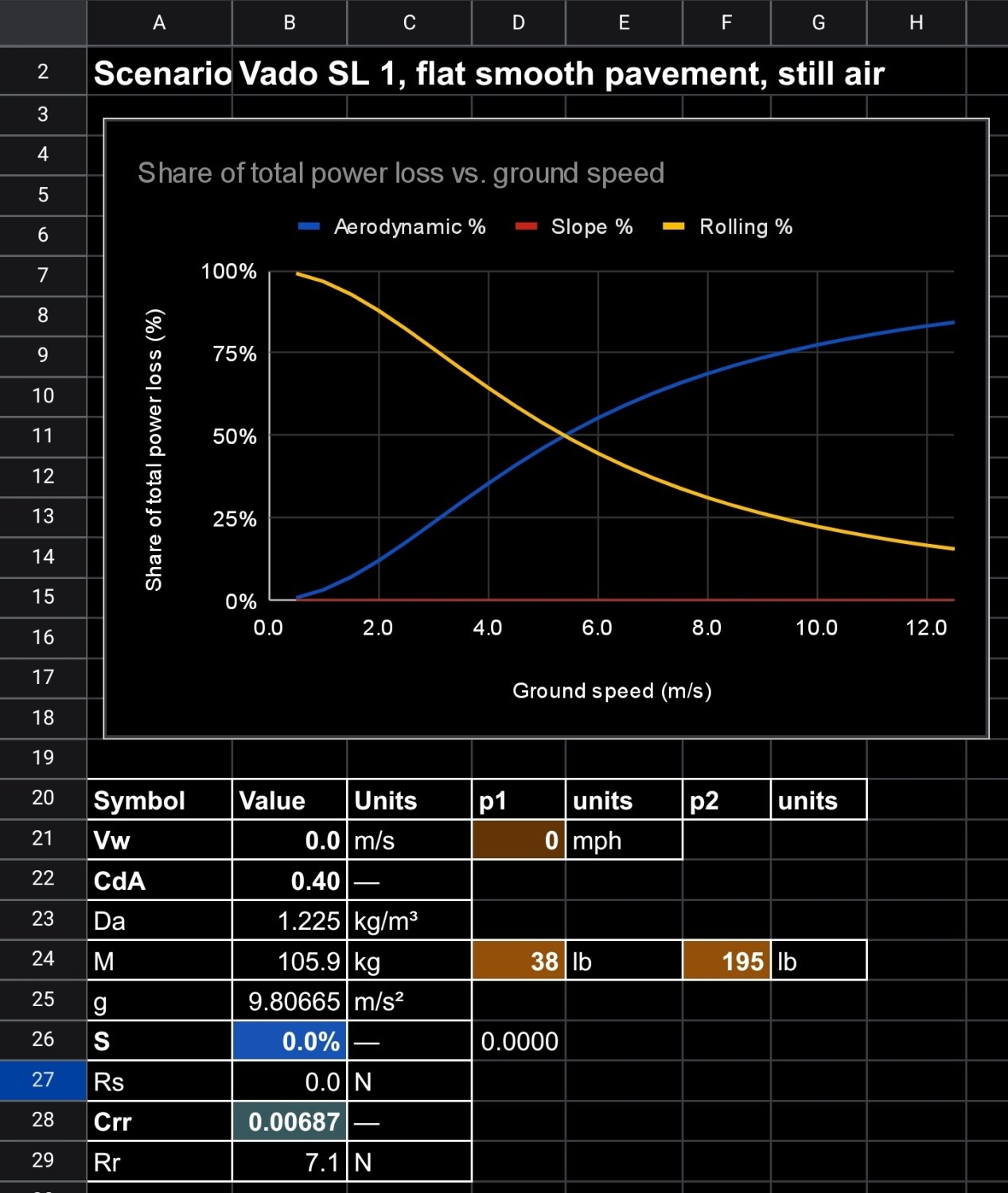

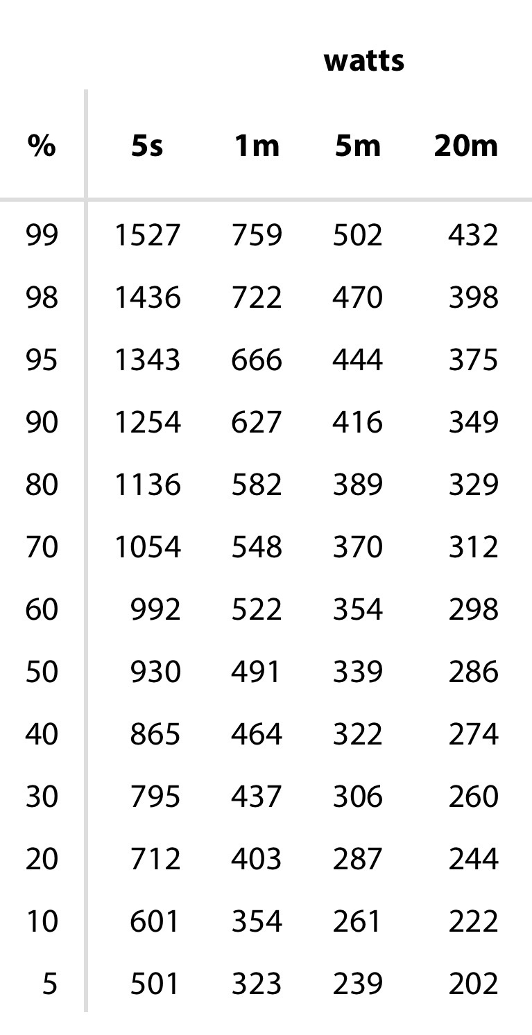

it takes over 600 watts to go 30mph on level ground on a decent road bicycle. check the CAT charts for RACERS and you’ll see that this is sustainable for about a minute for a 75% category racer. for an amateur, enthusiastic and fit rider, more like 30 seconds. the average speed for enthusiastic recreational cyclists is 12-14 mph with extremely few sustained periods over 20mph.
unless you want to license, register, and insure cyclists and cycles, and build out an appropriate independent network of streets and paths suitable for whatever random vehicle you have in mind, e-bikes need to stay close to the performance envelope of a high level recreational cyclist. that means 15-20mph, not 25+, and it means 250w sustained, not 750.

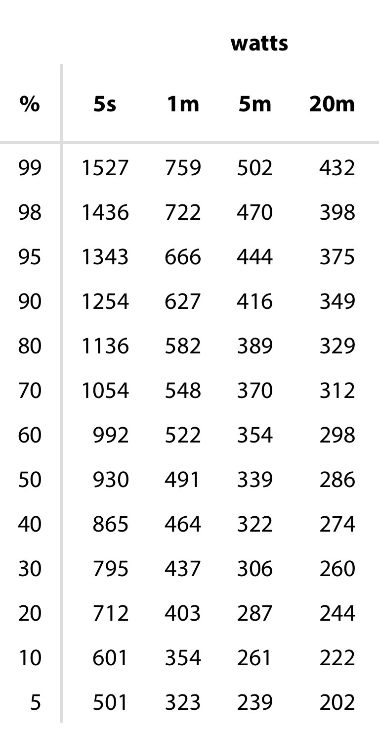

You left out my row at the bottom.
What does the 1st (%) column refer to, and where can I find an explanation of this chart?
