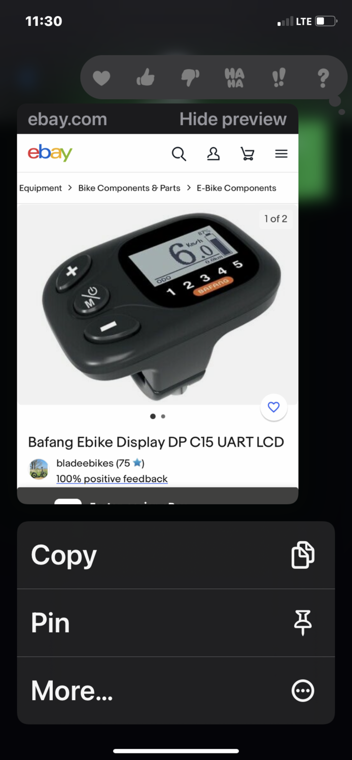

No idea what I’m doing but the computer/controller went bad 2 days after buying a used ebike. Will any one work? I found the same kind on line finally but for whatever reason they don’t ship to my home in Naples, Fl
That's a display Tom. It tells the controller what you're wanting to do. Kinda like a keyboard does for a computer.
As @kiethj69 mentions, we're going to need more info to be of any help. Bike make and model would help. Maybe a picture of that, and maybe a pic the data plate on the controller, that shows the make and model info of that?
I'll start with a question regarding why you beleive the controller is bad?

It won’t power up. Just blinks sometimes. Seems shot
Try using a multimeter on the battery and check the voltage of it.
Must be a nice ebike, The C15 display comes in either the UART or CANBUS protocol and no one but Bafang appears to sell them, except for that one ebay guy in Australia who may not ship to USA.
