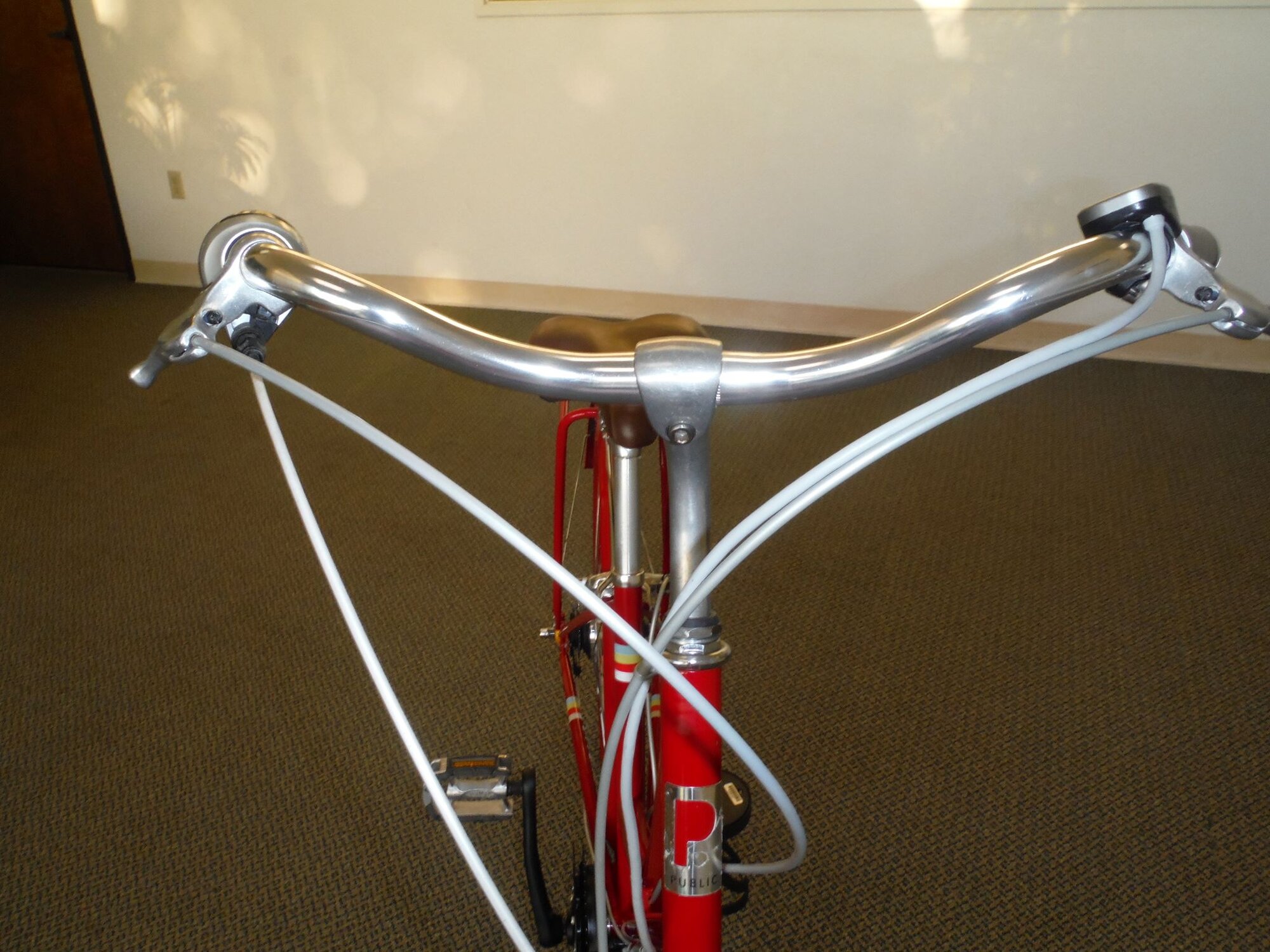

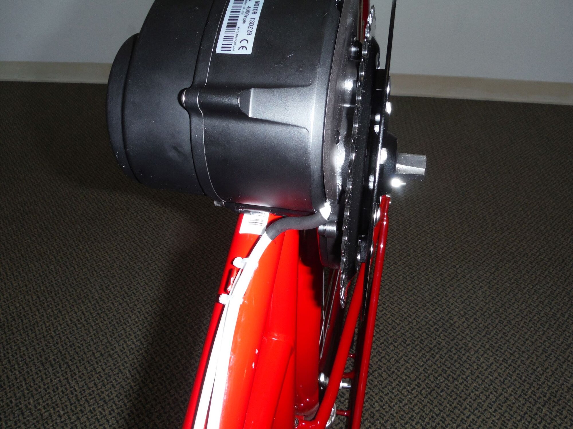

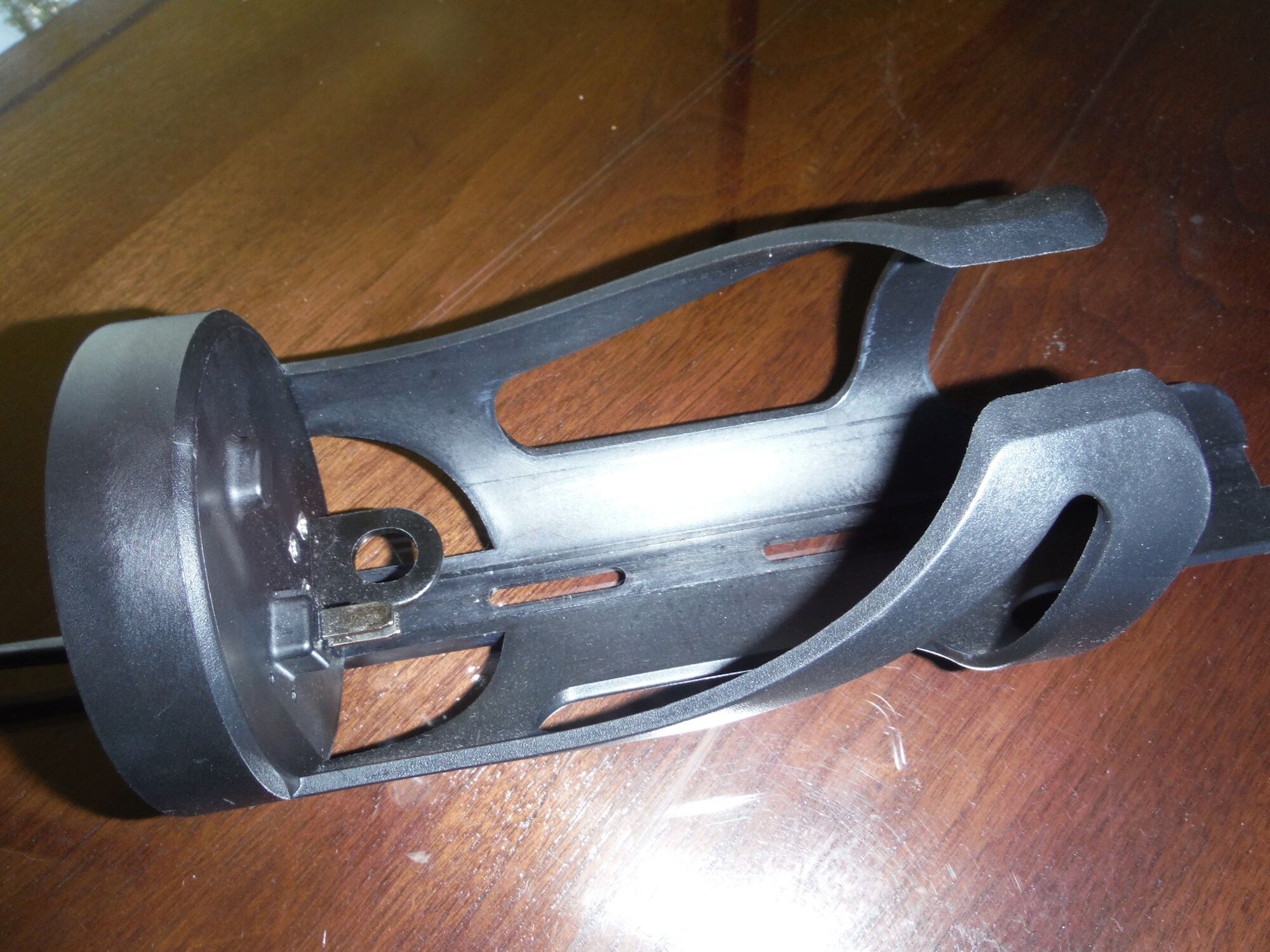

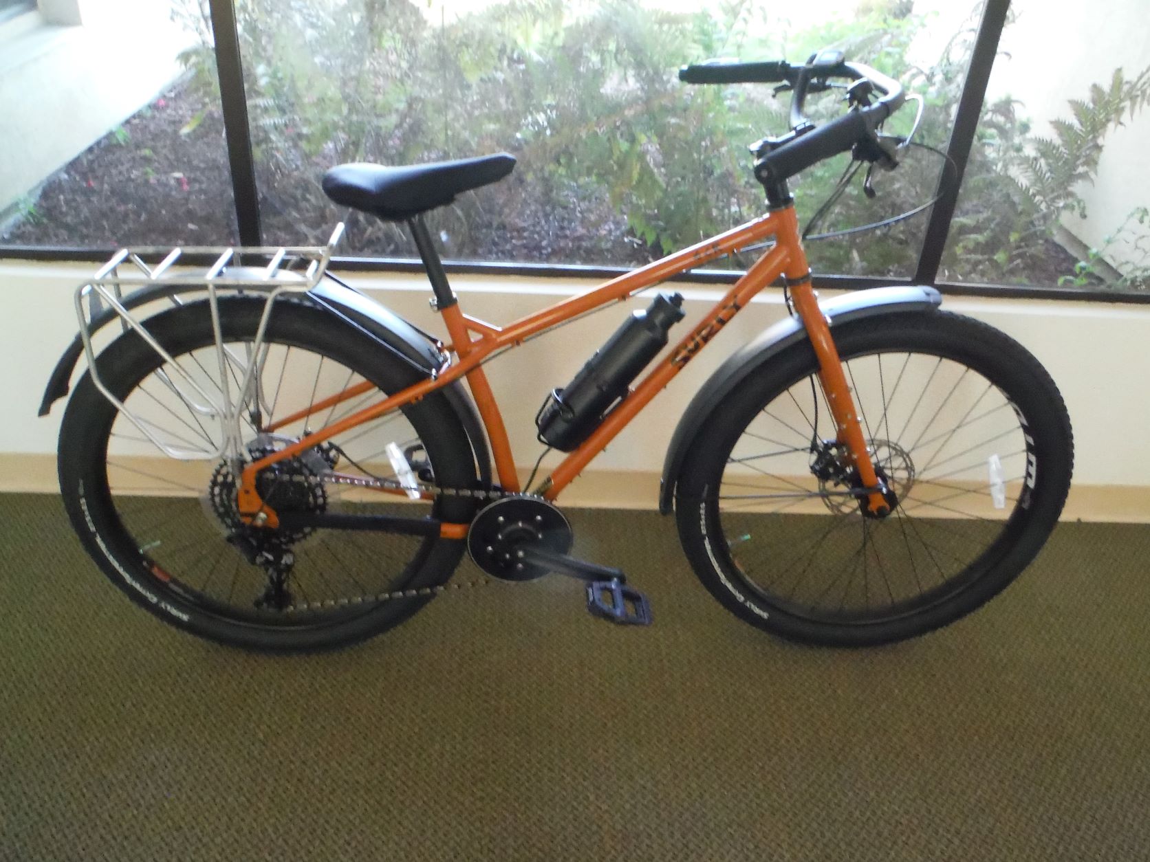

It is a job for a mid-drive. I have owned Bafang BBSxx bikes and an HD. I by far prefer the TSDZ2'B'. It is a cargo duty motor with a built in torque sensor. I like the 'six-pin' for the under 4mm wire to the display with no ugly connectors at the handlebar. Here is one example bike.

On one bike today I matched the display wire to the cable housings. Then I chopped the connectors and drilled the front of the motor and covered the display wire in black to make it vanish against the motor. The bike just looks like a regular bike from the side but has a stealth super powerful cargo grade motor.

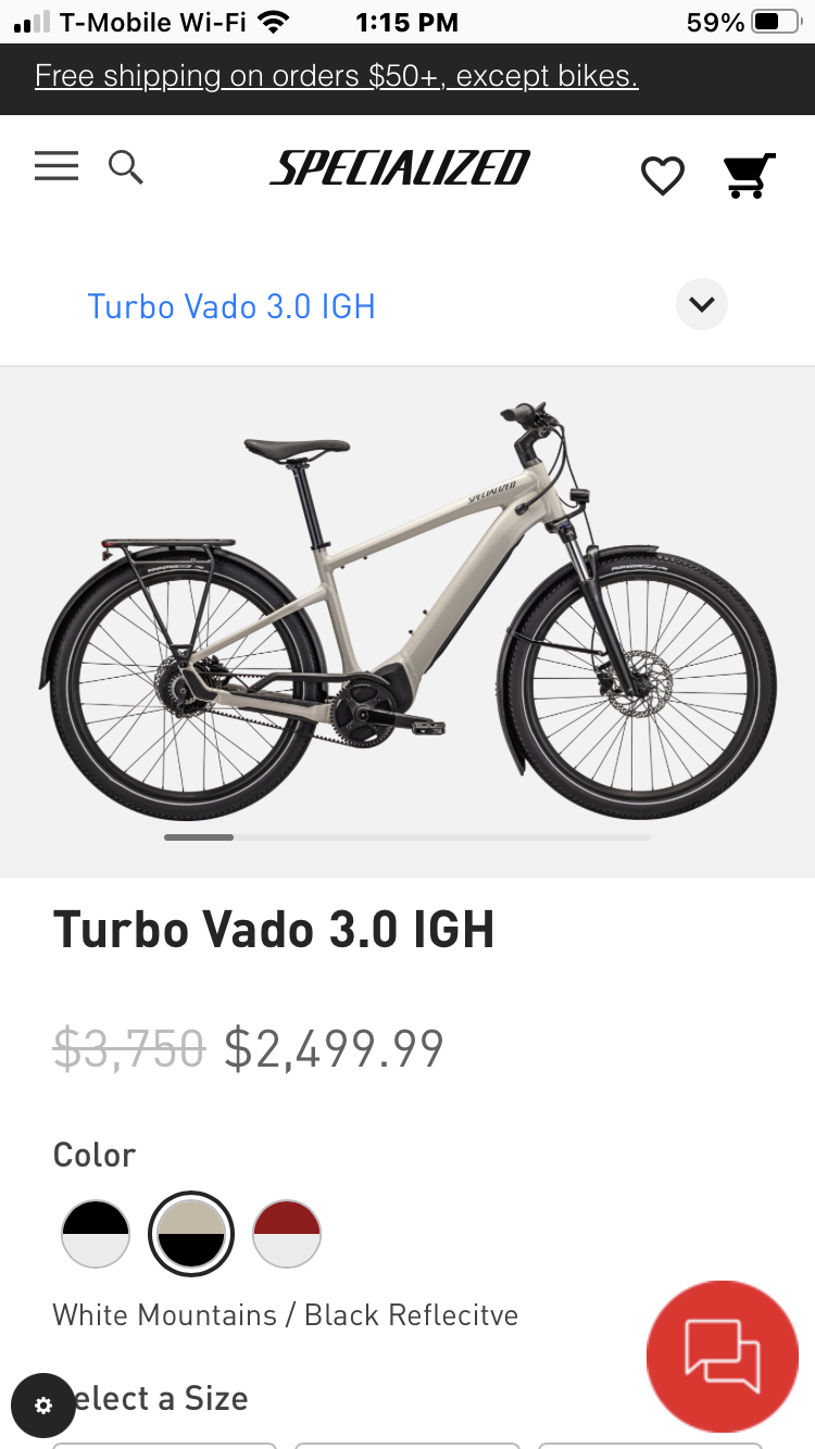

Specialized turbo Vado 3.0. 2500usd

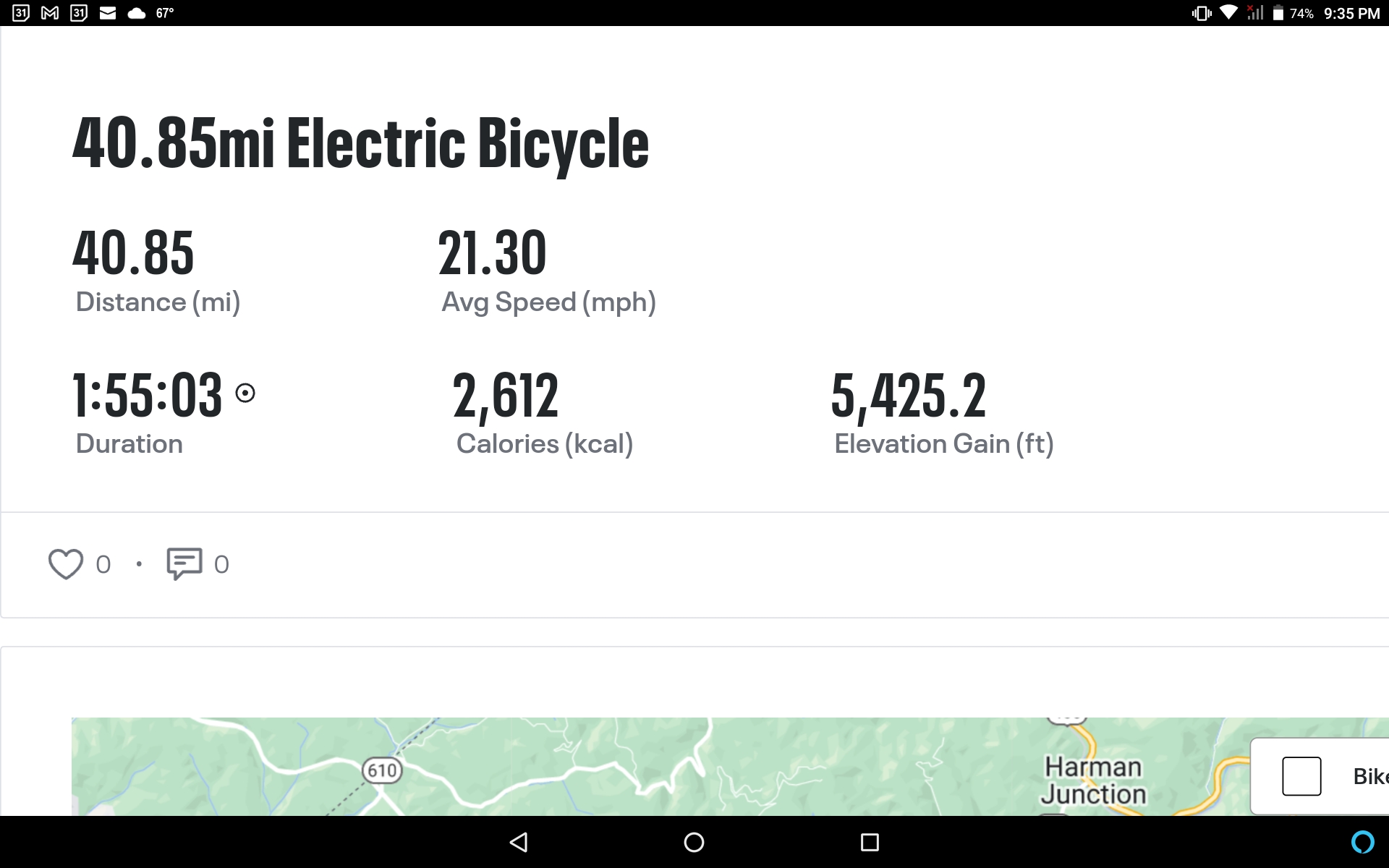

I have been doing a 41 mile round trip commute to work for the past six years. I try to fire my bike at least three days each week. This has been on a juiced CCS. It Is a rear hub. I have put over 15,000 miles on it. I live in the Appalachian mountains and have over 5000 foot of gain on my commute. Don't worry about using a rear hub. It will get the job done. The more you ride, the easier it will become. I am 52.
Here are a few insights. It is still hard to get motivated some mornings. A car is easier than a bike, even an ebike. Personally, I am thankful that I have the option to drive my car to work on bad days but it is easy to start making excuses for driving instead of riding. You have to have a bit of determination to make the ebike commute work. This is regardless of what bike you choose. I have owned five ebikes. Three factory and two recumbent DIYs. Of the five, the juiced has proven to be the best fit for me. It is a class 3. The extra speed has proven to be a big deal for me. It gets me there quicker. I also feel it is a safer speed in traffic. You will have to have storage. I settled on a motorcycle trunk on my rear rack. It works well for me. Be sure to get a couple of mirrors. I have tried several but the mirrcycle (I'm pretty sure I spelled that wrong) proved to be the best fit for me. The cold is a big deal to me. When it gets below 40f, the ride becomes uncomfortable. You can go below this if you want but that is where my determination starts to wane. I hope this helps. Oh yeah, enjoy the ride!

Thanks so much for the input Highpockets! I really was just curious as to if people think a rear hub would do the trick. But I mean I've done the commute without power so i guess I know what the worse case is...just don't want to be pushing a 50lb+ bike up that hill.
And I hear you on the speed with traffic. I've rode motorcycles for many years, so I do like having the power and speed on tap to manoeuvre when needed. I really am looking forward to shaving some minutes of the pedaled commute and tackling that hill without showing up at work a sweaty mess...though the pump/endorphins are a nice way to start the day.

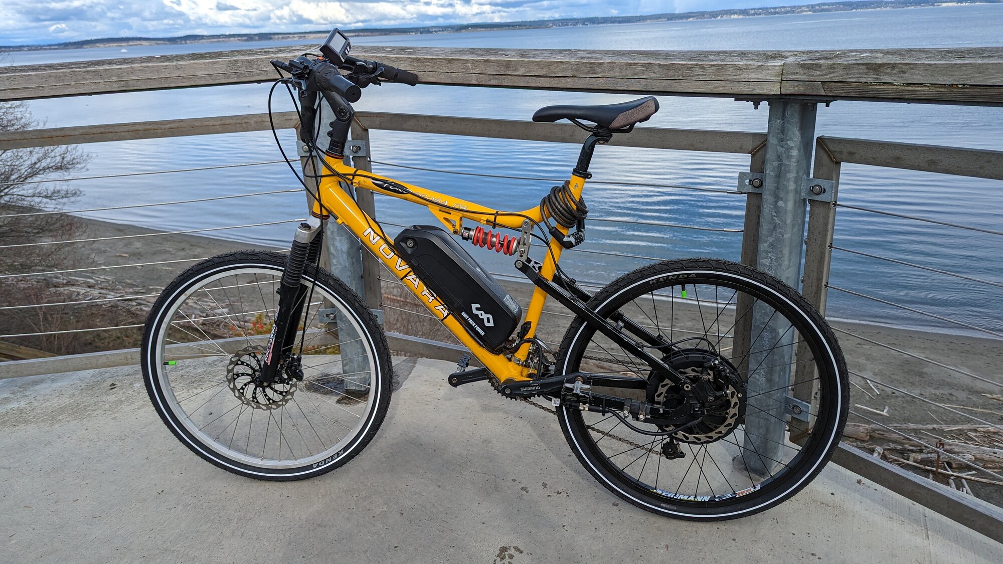

I put a 500w direct-drive rear hub motor on the bike below. It will pull almost 1500w, and do 30 plus mph on the throttle. It's torque sensing so pedaling as an ebike feels like riding a regular bike. On steep hills you do need some leg power to keep speed. I bought the wheel, controller, and display from Grin. Grin cost extra but they do make great hub motor builds.
