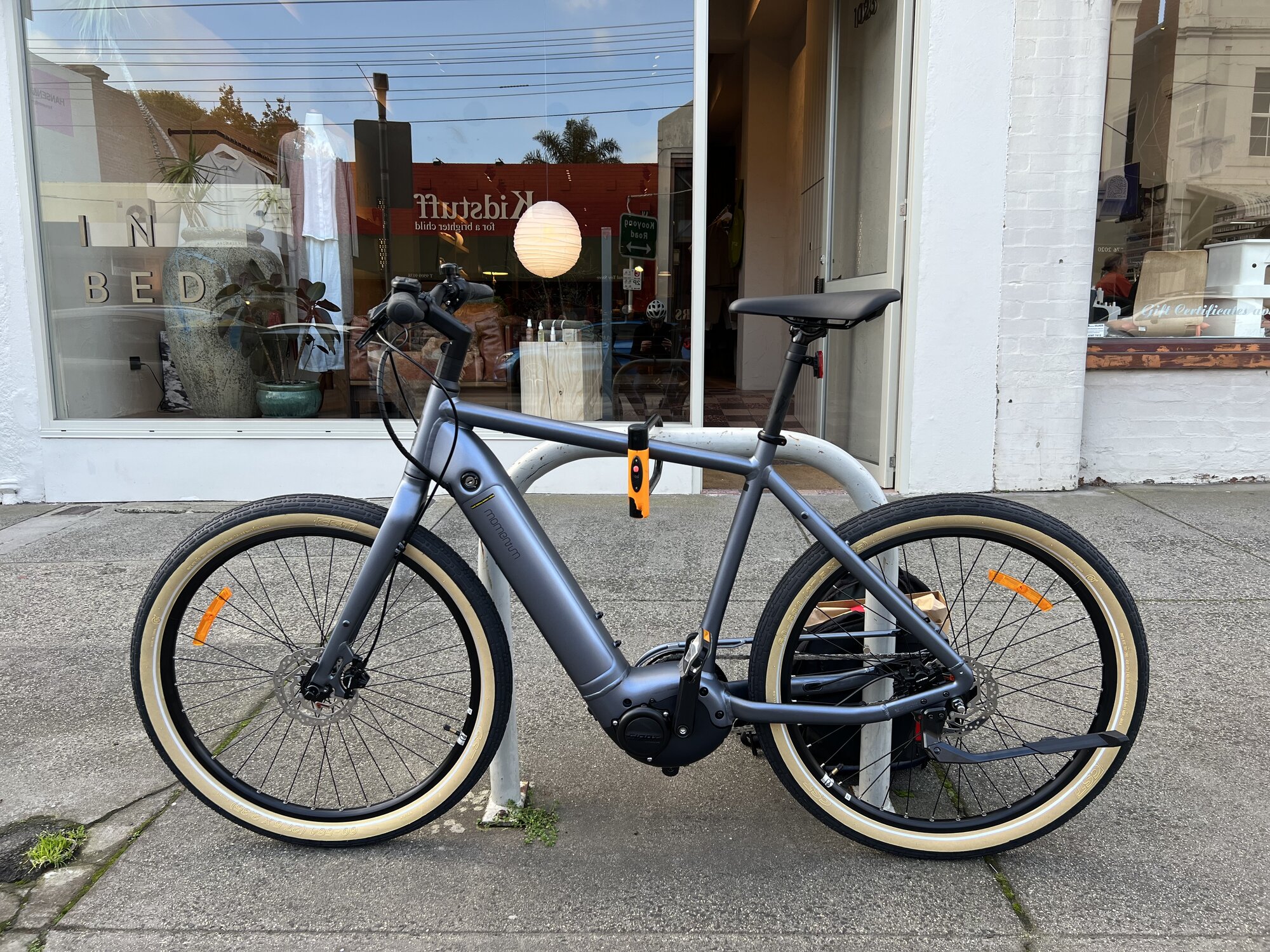

Hi all,
After test riding both yesterday I bought the Transend. Took a photo of it after my first ride on it today, hope you can see it. It weighs a tonne compared to my road bike but I quite like the look of it. The kind of blue-ey grey paint job in particular is quite nice.
Thanks everyone for the advice, it was really helpful. If anyone reading this has any questions about the bike let me know and I’ll answer them if I can.
