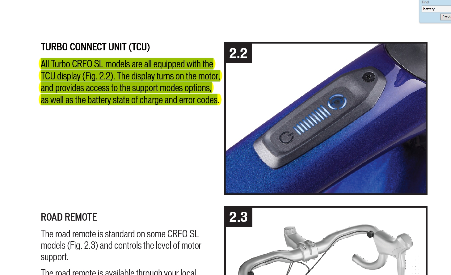

I think that is an excellent question. And actually, I don't know if my Creo also has a coin battery or not. And if a small, tiny, mini coin battery failure can bring the entire bike down, I would not be happy.
They are not clear about its need or function. I guess one could remove the battery and see what happens? Can the bike be started and the modes changed? But, yes, the Creo has the battery, too. And, of course, it is an odd size or, at least, not the rather than the more standard 3022.
So, the common battery is a 2032 and the Creo uses a 1620 battery of which I have some about to be delivered. Cheap enough on Amazon or Ebay. By the way it is almost impossible to remove the battery. The manual states to use tweezers but it is impossible to retrieve it. As soon as the tweezers enter the battery slot which is recessed they close making it impossible to grasp as the slot is SO narrow. I messed with it for an hour and finally used a toothpick to lower the small silver retaining clip which stays out of the way and than I tapped the TCU on a piece of 2 X 4 until the battery dislodged a bit and I could grab it. Specialized must have a VERY special tweezer.
The problem I was troubleshooting was that on two rides the bike would power up in sport mode as normal but than I could not change gears with the buttons or mode switch either up or down and the only way to power the bike off was to hold the power button for 30 seconds. I tried it several times with the same results and procedure to get it to power off. I thought the battery might be low and I was not getting the low battery indicator. My bike guy checked for TCU updates but I was up to date. (the entire bike was). He could not work on it and he knows I like to tinker so he gave me a spare TCU to try to fix my problem.
I replaced the TCU and at least on the stand the bike powered up and down as normal and I could change assist modes. I removed the battery from the new TCU and all was still well. Good power up/down and able to change assist modes and I did get the low battery indicator on the TCU. I put my TCU back in and the bug was still there. I disconnected the original TCU, took the battery out and let the TCU sit for 5 minutes unconnected on my work bench. The battery measured 2.92V, so I think it is ok. I put the original TCU back on the bike without the battery and it looked as though it was ok and working as normal. (I sort of felt I was dealing with the Windows operating system and had to reboot the system) I powered off, put the original battery back in and it still seems ok, at least at a bench test level. So that is where I am today. It is too nasty to go for a ride but I need to do that and I will also remove the battery again and pay more attention to how the display looks. My problem might not be gone but I need to do a good ride to find out.
