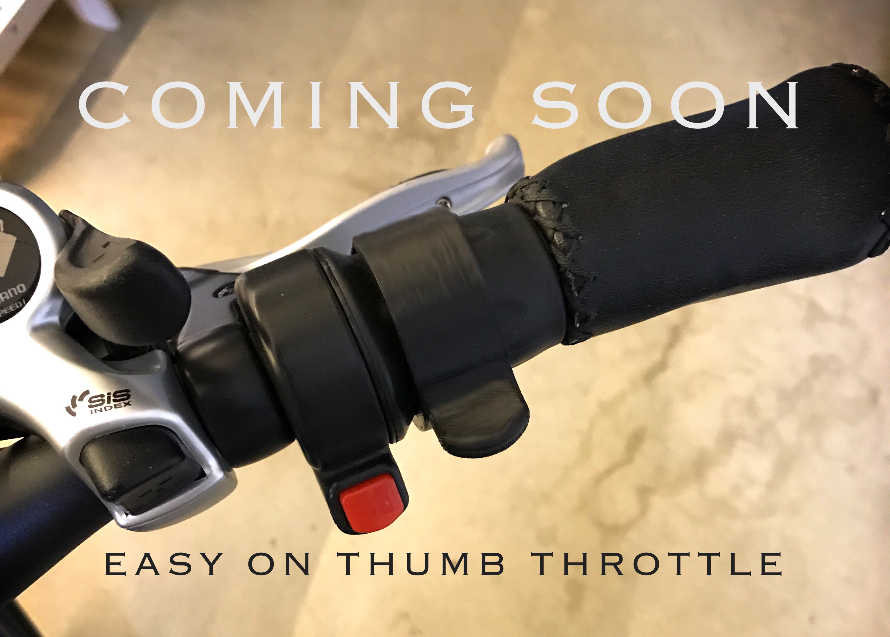

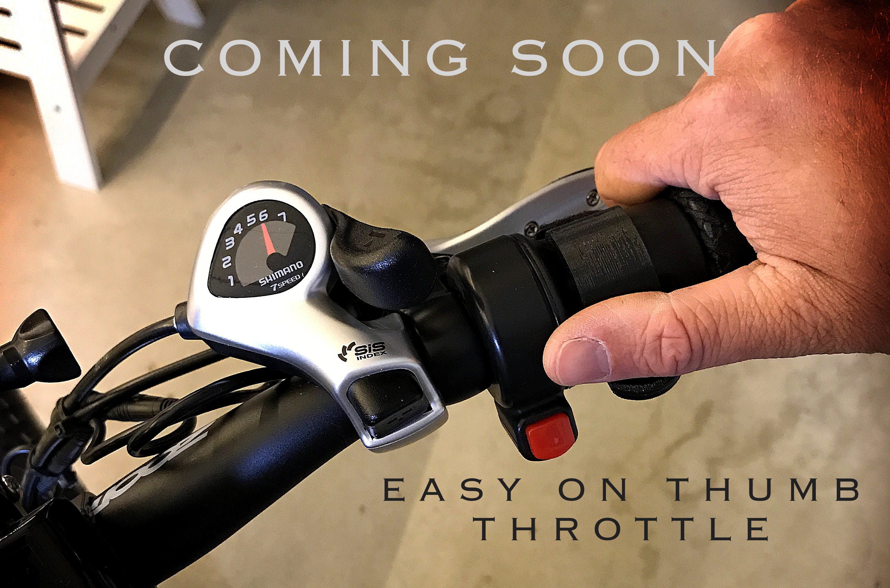

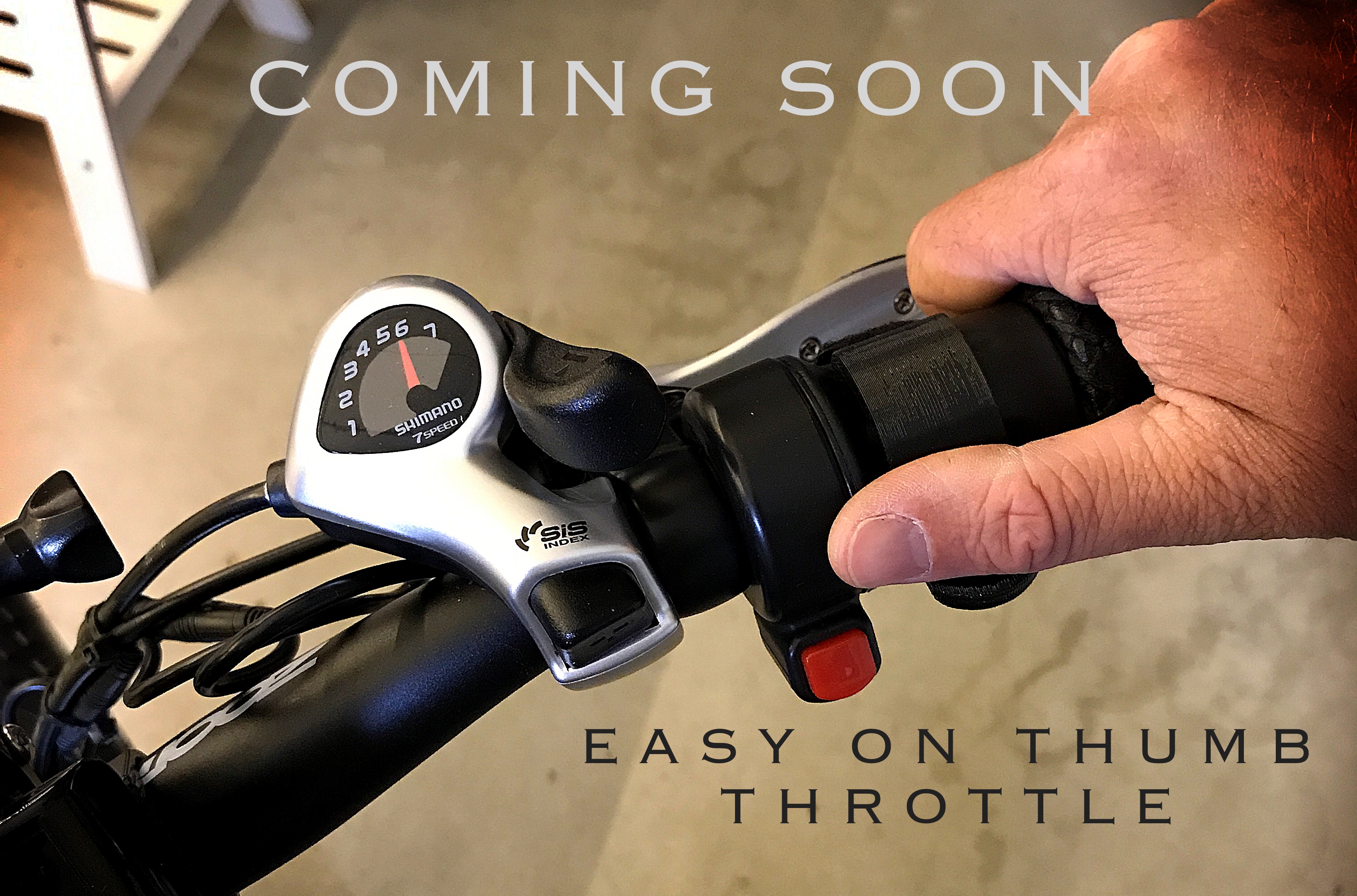

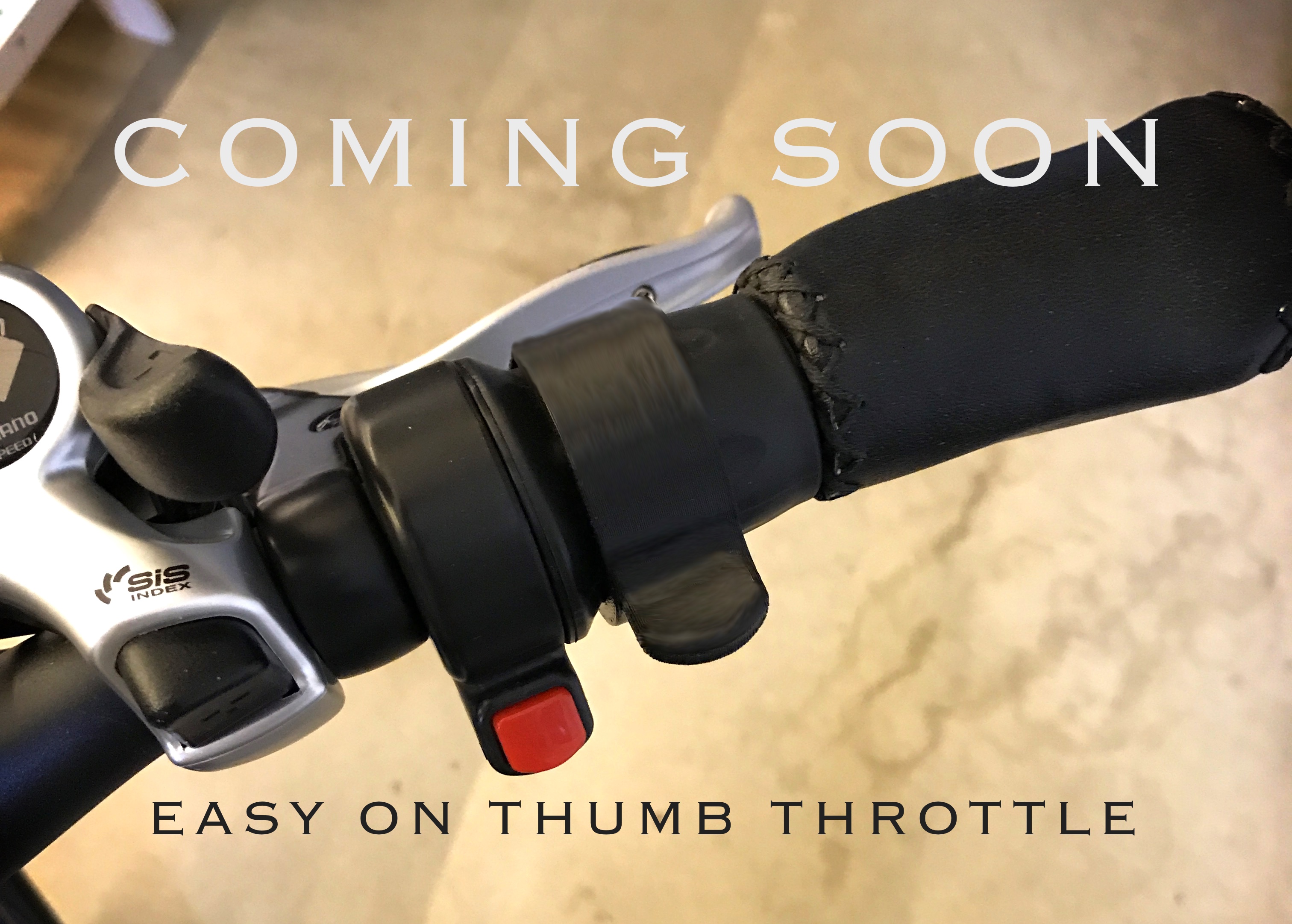

And also we're soon to release an easy on attachment thumb throttle accessory. Expected to ship July 2017!
