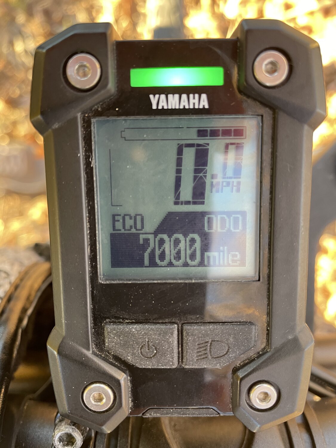

I just hit the 2nd anniversary of my Civante purchase and have 7000 miles on the odometer. I’ve logged 139 charges on the battery. I’ve used it as a commuter and on a 700 + mile road and trail vacation from Harpers Ferry, WV to Auburn, Indiana. I added Planet Bike fenders, Axiom rack and panniers. Nothing has worn out yet. I do however keep a T30 star Allen wrench handy for regular tightening of the motor mounts. I still like the bike, but I’m wondering if I should plan to sell it at 10,000 miles and the end of the 3 year warranty. I’ve kept my non electric bike forever, but the eventual need for a battery and motor makes me think maybe it’s best to sell it while it still runs well. Any thoughts out there?
What is the cost of a new battery and motor? It has to be less than the cost of a new bike. At 7K miles you should get a new chain and cassette.
my spare battery set me back $900 and a well worthwhile investment. I needed a second batter to complete a Century ride. I could get 65 miles from first battery running it conservative and go the remaining 35 miles at higher assist as I got tired. When I looked into price and availability of the motor it was about $950

If your bike is in good shape and you like it, replace the motor. I had a crash a year ago July. I clipped a steel pole doing 15mph due to being inattentive. I broke a brake lever. $150 to replace it. I also broke a few bones and had surgery.
@Drwhitenack-7000 miles is just the warm up act for your Yamaha drive train. I've almost 19 thousand miles on my Haibike Full FatSix Yamaha PW drive system with no motor or battery or ancillary system failures. However, at 7000 miles, your chain is most likely stretched and in need of replacment & it's a fair bet that your front chain ring teeth are worn to the point of warranting replacement. Consider the chain and front chain ring as wear items to be monitored and replaced when needed. I say this through my own experience. Regards to carrying a star wrench for your motor mount bolts: Remove each motor mount bolt, one at a time and apply a few drops of BLUE LOCTITE on the bolt threads. Using a proper scaled torque wrench, torque the bolt to the noted torque found on the concave washer from which the motor bolt goes into. It's not much, I recall on my H-Bike that torque being 22 Nm.....(not foot pounds!) From that point on, you can then leave the star wrench back home.
@LarryLegless-When you state you "wore the motor out", what exactly were the signs of a failed motor? Good to know the Yamaha dealer has backed you up with a warranty claim.

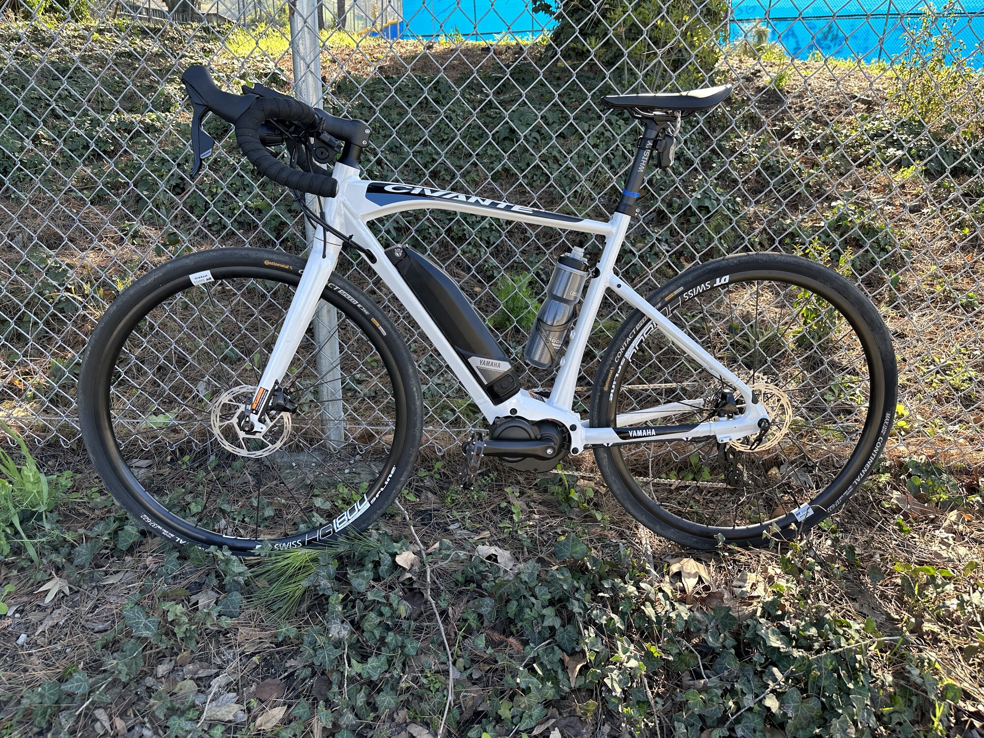

I went a little crazy on mine… swapped out the groupset for SRAM Rival AXS and converted to 1x. Changed the wheels out to DT SWISS HG 1800 spline with Pirelli Pzero SmarTube and Continental Contact Speed tires. Swapped handlebars to carbon fiber gravel bike bars with shorter 80mm carbon fiber stem for easier riding position and cut some vibration. Decided to go for broke and upgraded the seatpost to CF as well and reused my Fizik saddle from my old bike (although a Selle Italia or Brooks one do also have my attention). Running a set of MagPed pedals, replacing the Race Face Chesters I bought with the bike. The bike is MUCH faster now (average speed is up and coasting/freewheeling distance) and the shifting is flawless (electronic rocks!).

The tires and wheels will make the biggest difference. After that, things like the handlebars, steam and seatpost were more about comfort than performance. Groupset change is not for the faint of heart, but… I’m a 1x lover, so I couldn’t resist.
I find it very interesting that you changed out the group set. I find that the 10 spd Tiagra shifts flawlessly. I thought about upgrading to 105 or Ultegra 11 spd but it will be too much of a pain. I upgraded my cassette to a 105 with narrower spacing. It is also much lighter than the stock cassette. I also upgraded the chain to either an Ultegra or 105. It made a difference in shifting and it is lighter than the KMC chain. I just hope both the cassette and chain hold up to the torque.
Did you have any problems with upgrading the wheels? Are they much lighter than the stock wheels? I see that those DT Swiss are Ebike wheels.

I don’t care for Shimano all that much to start with, then they pulled that BS with Di2 (which is dumb with that central weird battery) and Hammerhead/kroo2. From before I bought the bike I preferred 1x to 2x (especially on an eBike) and cost wasn’t much different to go to SRAM Rival AXS as compared to something like Shimano GRX (plus SRAM is 12 speed vs 11 speed for Shimano). It helps that for SRAM AXS you only need to worry about running the brake lines, but it definitely ain’t for the faint of heart… you’ll have to partially drop the motor (pull the first two bolts) as everything runs right over it. Beyond that is just the pain of bleeding SRAM hydraulic brakes. I love the electronic shifting… really is the best, but for those on a budget or can’t do the swap themselves, there are better places to put your money (bang for the buck).
The DT Swiss wheels… ah… there is a catch for any rear wheel… the speed sensor on the left side of the hub. There’s a disc like assembly that contains a magnet attaches to a groove on the hub end cap. I had to get it machined by a generous forum member who did that same for his wheels and works in a machine shop. So if you don’t have access to one… But I’m wondering if you order wheels from someplace like Astral or ROL, they may be able to do it for you.
I didn’t weight them, but the DT Swiss wheels with Continental eBike rated road tires and Pirelli TPU tubes felt noticeably lighter (holding one wheel in each hand).
