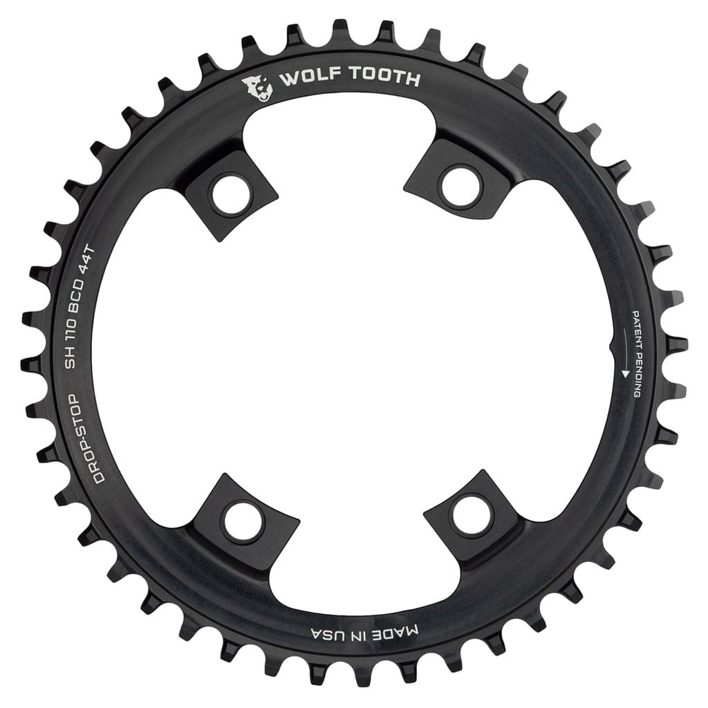

This is the chainring I’m using.
The shifting through all 12 gears is solid. A hacked 1x Tiagra? It may perform ok, but… my concern with using derailleurs that aren’t meant for 1x is that they won’t have any kind of clutch (or otherwise) mechanism which will help to stop chain drop (as well as a proper 1x front chainring).
I measured everything many times, researched, and then “cut once”. Turned out that basically the chainline for the large chainring (which was all I really used too, thus even more appeal for 1x) is within spec to go 1x. Also the Wolf Tooth chainring is a proper 1x compatible with SRAM AXS flattop chains. So I just needed the new front chainring and new chainring bolts… no spacers or anything.
