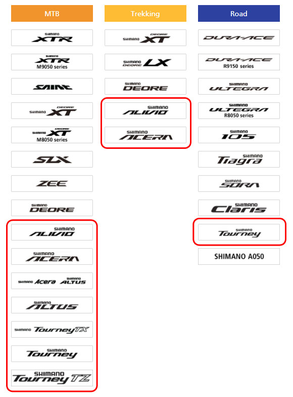

Here is the Shimano groupset hierarchy for reference.
I recommend avoiding the entry-level groups highlighted below for the best performance.
