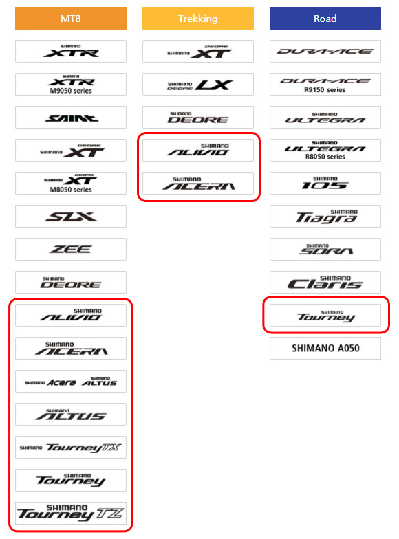

Here is the Shimano groupset hierarchy for reference.
I recommend avoiding the entry-level groups highlighted below for the best performance.

Alivio is now the best alternative for a nine speed cassette which gives you the strongest chain. From ten speed up the chain gets smaller and thus weaker. No?
This is all new to me I don't have a clue. Except when I was searching for a different derailleur, Deore was the only sub for the O.E. Acera.
According to Shimano, you can run a smaller nine-speed rear cog with Deore... and wider chains are generally stronger. ;)
My ten year old Specialized has a nine speed cassette and chain ( Deore XT ) but someone told me the new Deore starts at 10 speed. Thus smaller chain and is no longer correct with a nine cassette. IDK 😕
