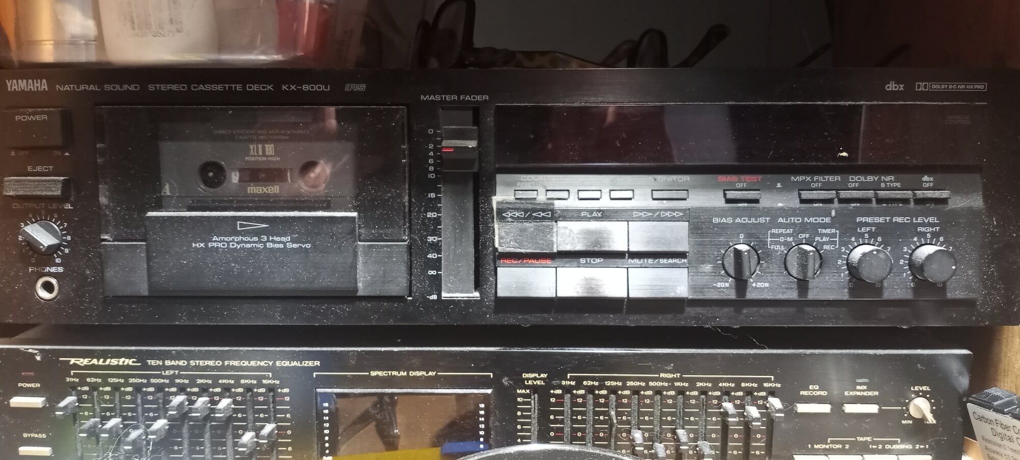

I still have my Yamaha cassette deck that I cost me $740 in 1984,..
That was the cats ass!!
Next best thing to the Nakamichi Dragon.

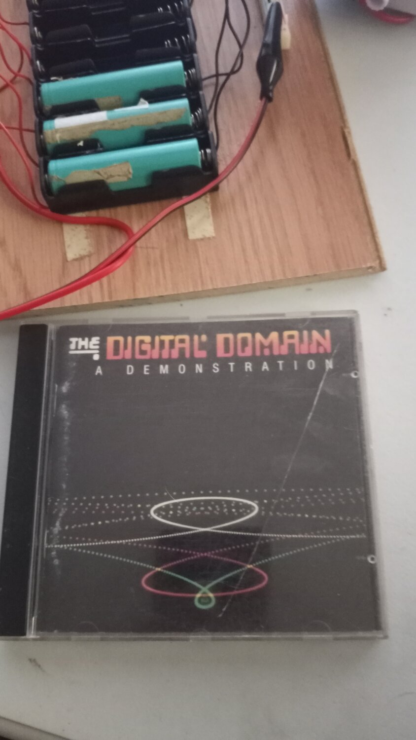

The CD's were expensive too.
This CD cost me ~$45 and was the only CD that I had for 5 years. Albums were $5-$6
It was one of the first 100 CD's ever produced.
It came with a warning label saying essentially "don't blow up your stereo" lol

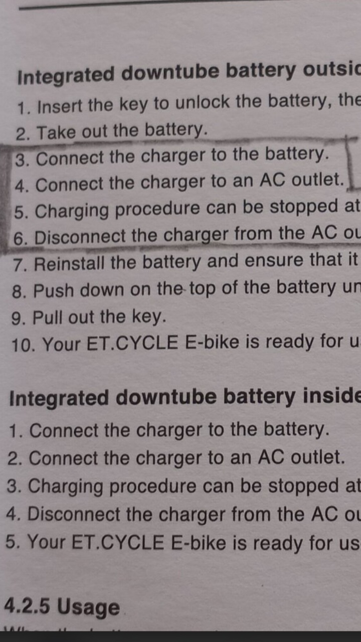

I remember watching that video and was hesitating from doing what @Ravi Kempaiah said because my owners manual Specifically said the opposite,..
I have three 48 V batteries, three 48 V chargers, and a 60 V Bench Power Supply that I use the most to charge my batteries.
I now plug in ALL my chargers and the Power Supply in FIRST before connecting any of my batteries.
The Das-Kit charger and battery are fine to be plugged in "incorrectly" and I've never had a spark worth noting.
Except at the outlet when I plug in the chargers. (And I'd much rather have a spark at outlet than right beside the 💣,..... I mean 🔋😂)
On one of my batteries, if I plug the battery in first, I get One HELL of a 🌩 with a Huge Crack of sound !!
One thing that I did notice is that if the battery is almost fully drained, (~40 V) I get a small orange spark at the battery when I connect the charge plug, so I turn the voltage of my power supply down to about 40 volts before I connect it to the battery, then I get no spark.
The sparks at the outlet are blue.
I think it's an AC vs DC thing ?

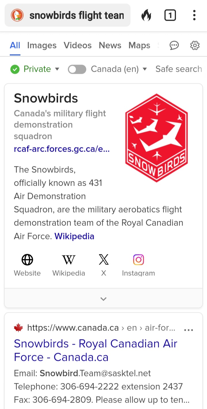

We call out military flight team the Snowbirds.
There's almost no Snowbirds left.
The fricken planes are from the 60's.
They've had a few crashes and deaths and the fleet has been grounded a few times.
My advice would be to make the 110v connection AFTER making the battery side connection when hooking up the charger, and removing the 110v before disconnecting the battery.
WHY? It's about capacitors and the HUGE amount of voltage that may be stored up in them, especially in the older rigs. Once you experience the big lightning bolt and associated POW that may be the result of incorrect connection order, I can pretty much assure you, that you'll NEVER forget that lesson.
I don't care what the instructions say. Capacitors are nothing to mess with......
It's only one of my batteries that goes POW when I plug it in wrong and that's when I plug the battery in first.
I'm pretty sure that the BMS is allowing the battery to reverse charge the capacitors in the charger that gives the CRACK of a spark?

Over time, those sparks take their toll on connectors. Why beat up a fragile, hard to replace battery connector when AC outlets are cheap and relatively easy to fix.
IMO, manufacturers say to plug in AC first to limit liability should someone get a potentially more severe shock.

What we have found is that every BMS and charger is built differently.
Some BMS have pre-charge circuits, and many don't. This changes the equation.
If the connectors don't have arc protection and BMS doesn't have a pre-charge circuit, then it is good to connect to the battery first and then to the outlet.
I think we should have a video about these nuances, as many chargers don't come up with proper instructions.
