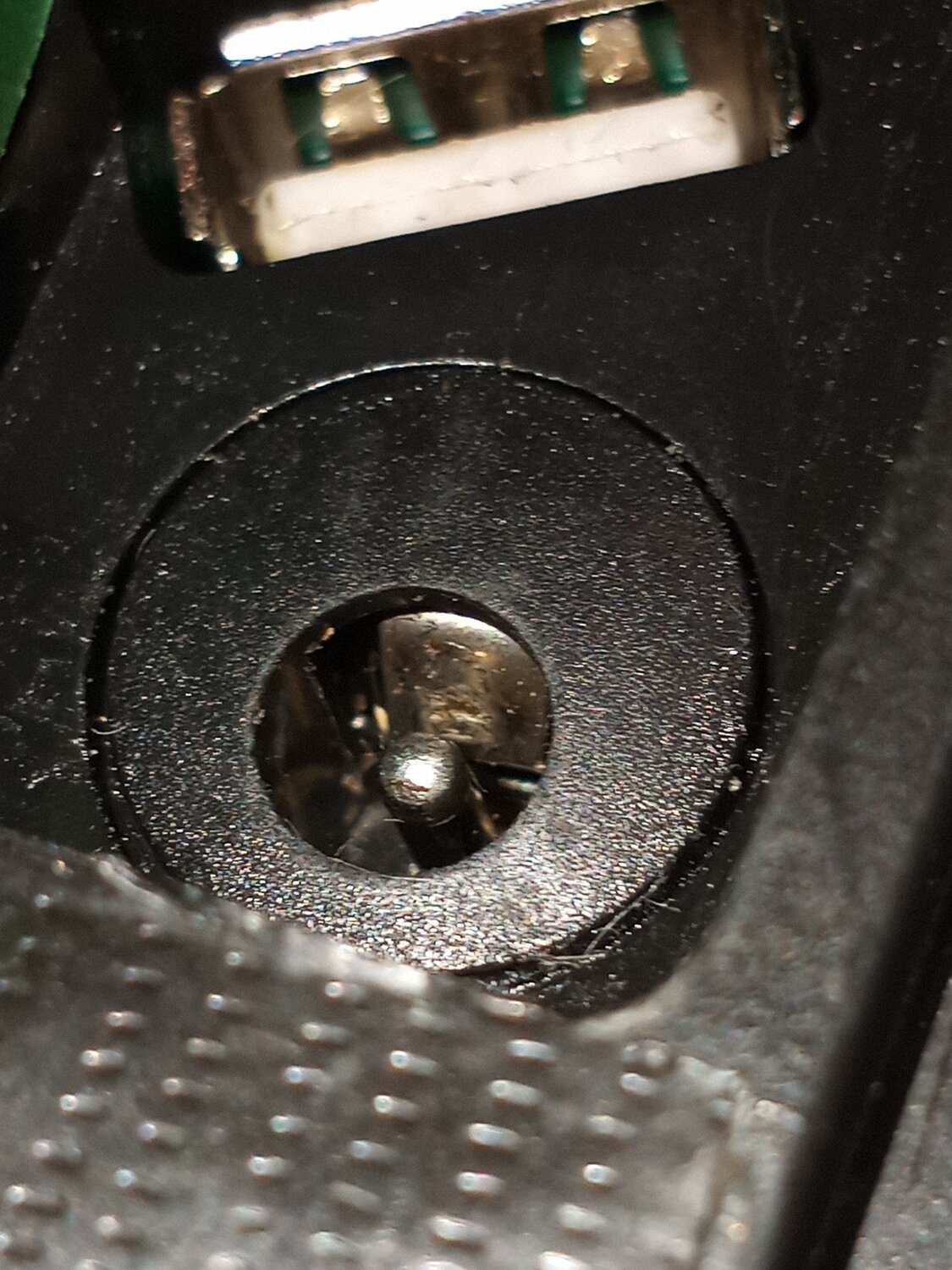

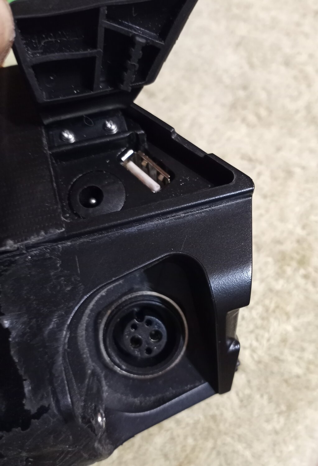

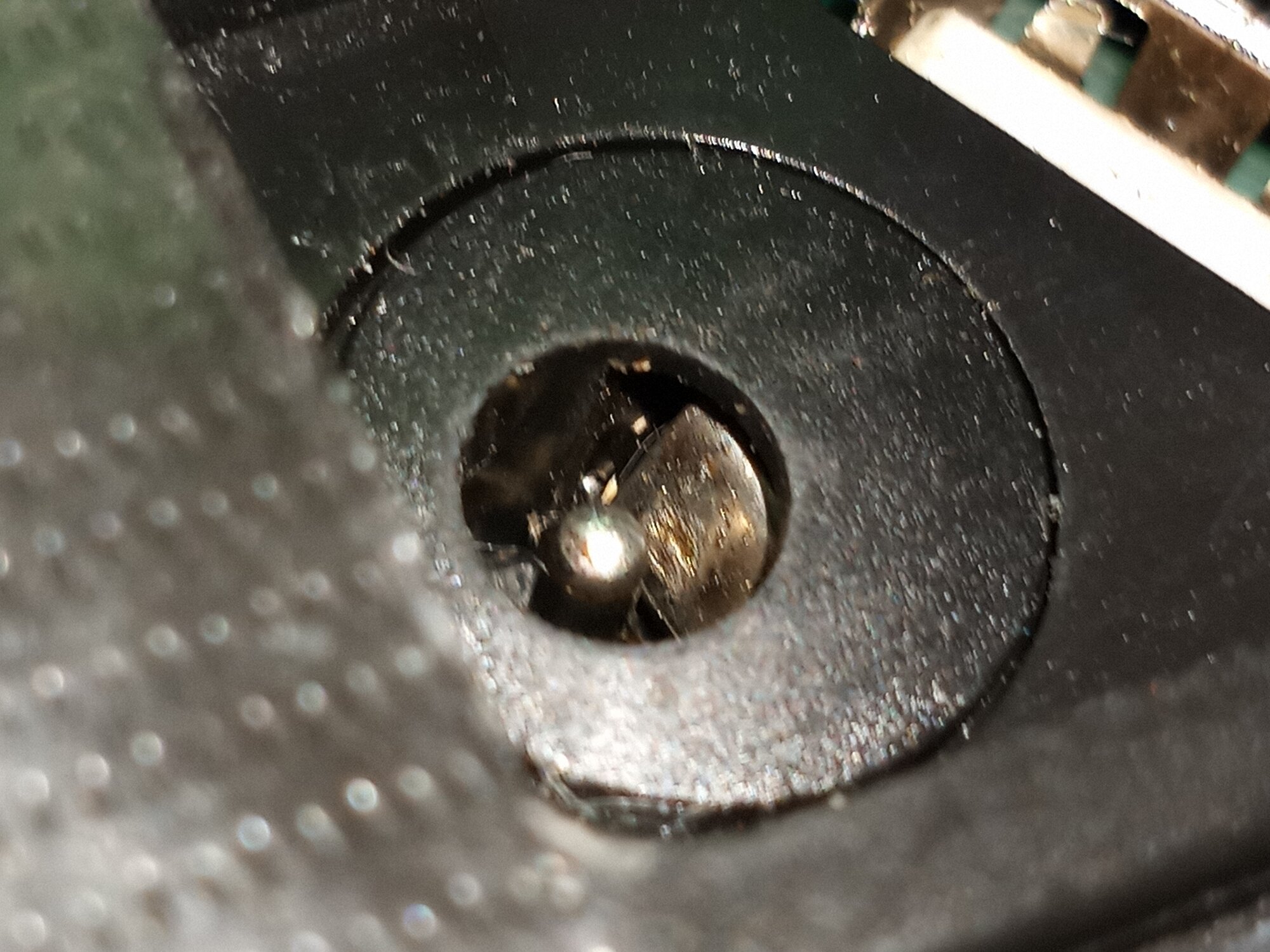

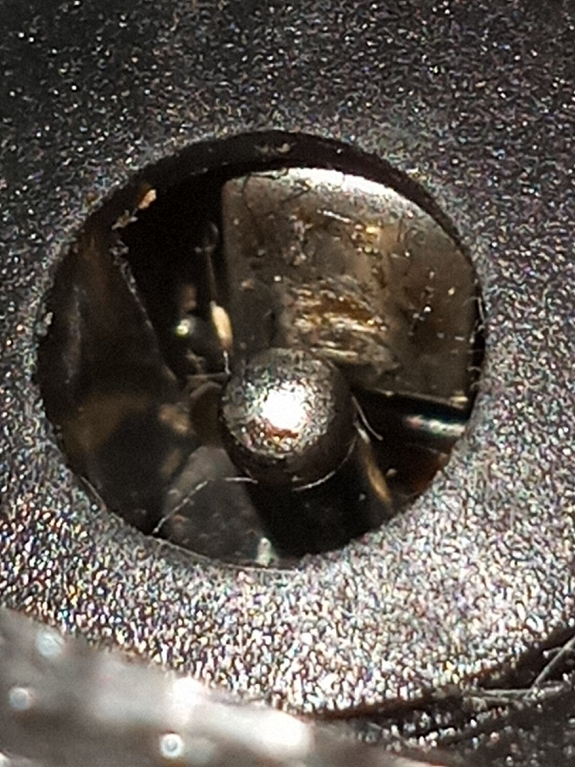

I managed to take some close up pictures of my charge port on my battery.
The pitting on the contact terminal is from metal that got vaporized.
I had Huge Sparks about 6 times when I forgot to plug the charger in first.

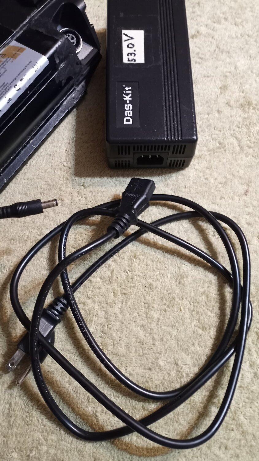

I decided to do one final spark test using my UL listed Das-Kit charger.
(I named that battery Sparky 😂)
I'm supposed to plug the battery in first as per the instructions with my Das-Kit ebike but this battery doesn't like to be connected that way and YELLS at me when I do so. 😂
The charger specifically states "Backfeed Protection", so I felt comfortable enough to plug the battery in first, followed by plugging in the charger.
(I did lean WAY off to the side and ducked though. 😂)
NO SPARK !!!@?

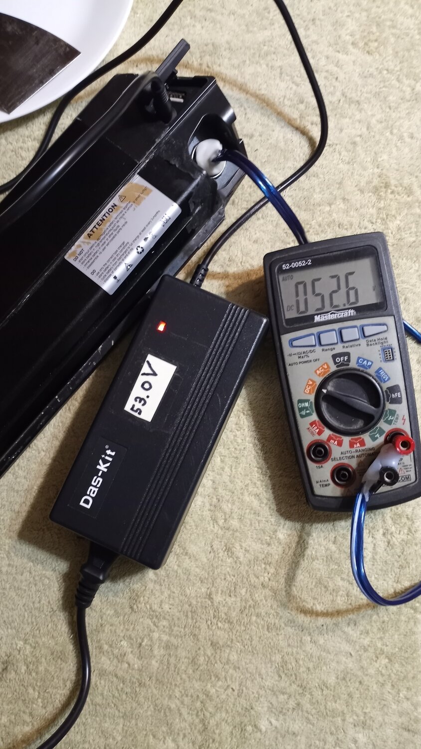

The charger also says "Do Not Open", but I did to turn it down to ~53 volts, (that's as far as I can turn it down) so now I use it to partially charge my batteries after a ride, then I fully charge my batteries right before a ride.
Then to further test everything I plugged and unplugged everything every possible way to see what would happen.

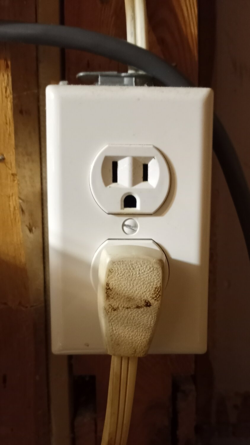

Everything way fine except a tiny bit of "fuzz" when I plugged the charger into the outlet.
You can tell by the sound and light show how much energy is involved, and the sparking at the outlet is barely noticeable.
As mentioned here before, I'd rather replace an outlet or cord than replace my charge port on my battery, and I'd rather have some sparking at the outlet than in my battery.
Chargers usually come with a standard replaceable cord that plugs into the charger unless you perhaps have a Very SPECIAL charger with the cord wired directly into the charger.
Then you get to buy a new charger when your cord needs to be replaced.
So,.. I'm quite happy with my UL listed charger.
It appears to be well designed and can work with any battery, no matter how you plug things in.
I'm sure that's all part of being UL listed.

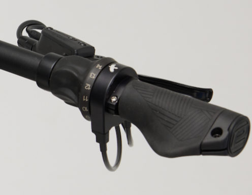

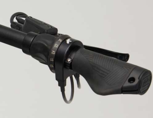

Then again the Zen e-bikes do come with a very strange shifter and no documentation on how to operate it??
