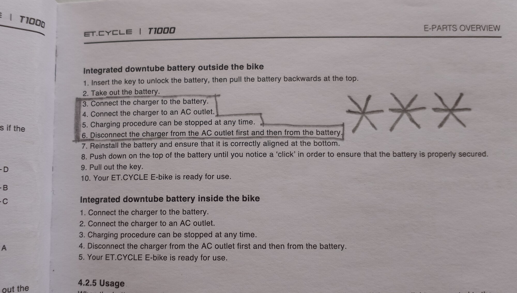

According to Rads manuals: 1. plug the charger into the battery's charging port. 2. plug the charger into the outlet. 3. After charging unplug the charger from the outlet and then from the charging port.
I found it. The procedure was not in the paper copy of the manual that came with the bike, but it was in the PDF version that I downloaded from the manufacturer's website--I knew that I had read it somewhere. :rolleyes:

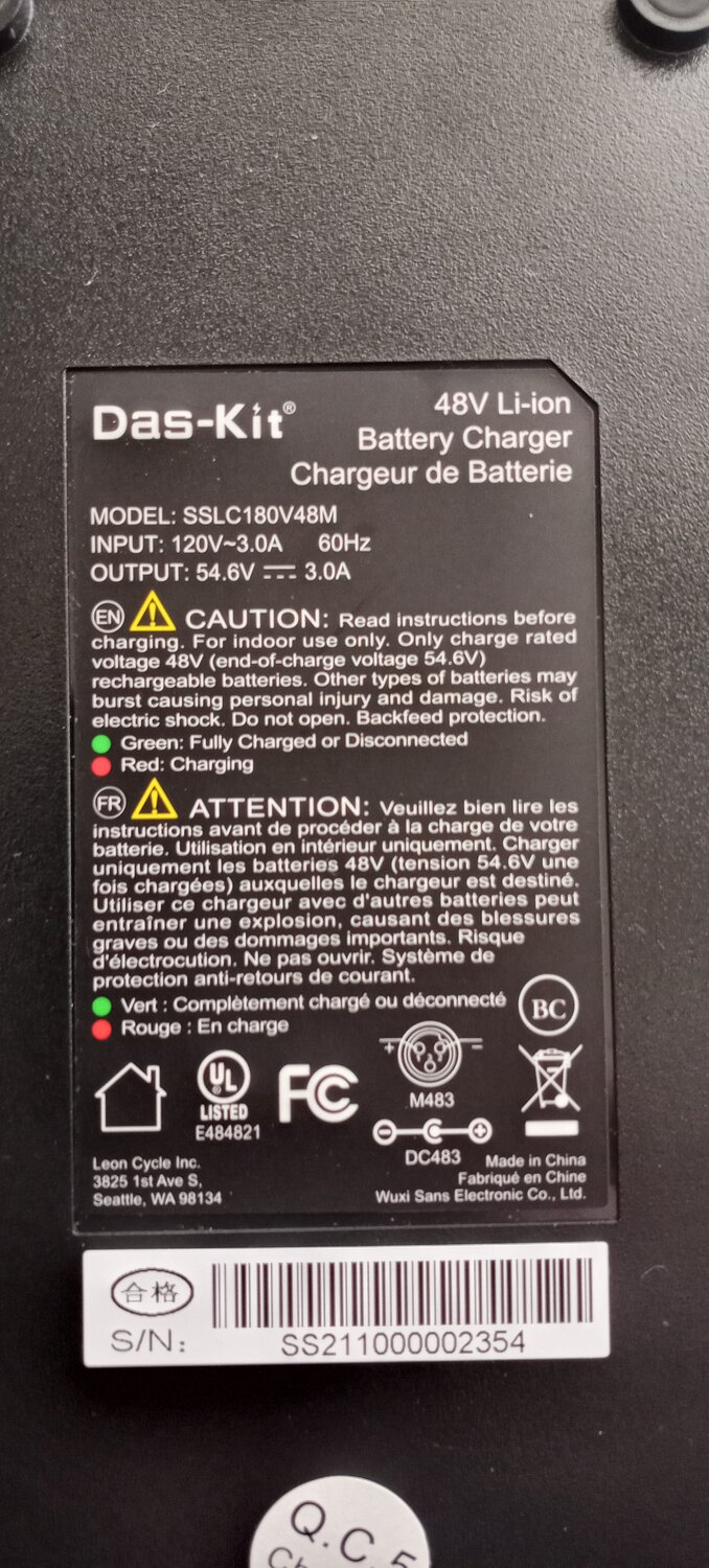

My Das-Kit charger is UL listed and has backfeed protection.
I feel pretty comfortable using it.
(I just have to remember how to plug it in. 😂)

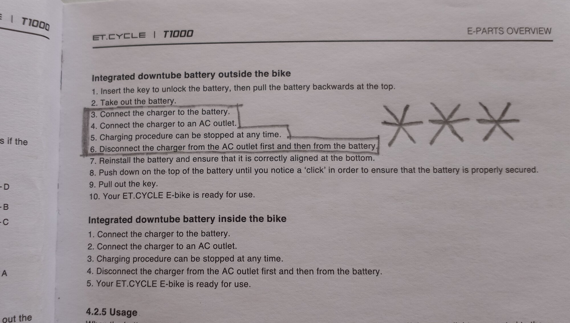

I’m far from an electrician, but I’m willing to assume it matters, so one should do it in the manner specified in the manual for the battery and charger. There’s no harm in doing so; whereas there may be some harm in *not* doing so. In other words: I assume the instructions from the maker of the battery and charger would be more specific and better informed.
In the case of my Vintage Electric Cafe e-bike, the bike manual and the battery charger manual actually say different things. The bike manual says plug into the wall first, then the battery; the battery charger manual says plug into the battery first then the wall. When I called Vintage to clarify, they said the discrepancy seems to be the result of them having changed the model of charger they use since the time when the bike manual was originally written, and that I therefore should follow the procedure specified in my battery charger’s manual.
In terms of unplugging: my battery charger manual says to reverse the procedure - unplug from the wall first, then the battery. Again, though, this might not be the same for every battery, so I’d follow the instructions for your battery and charger.

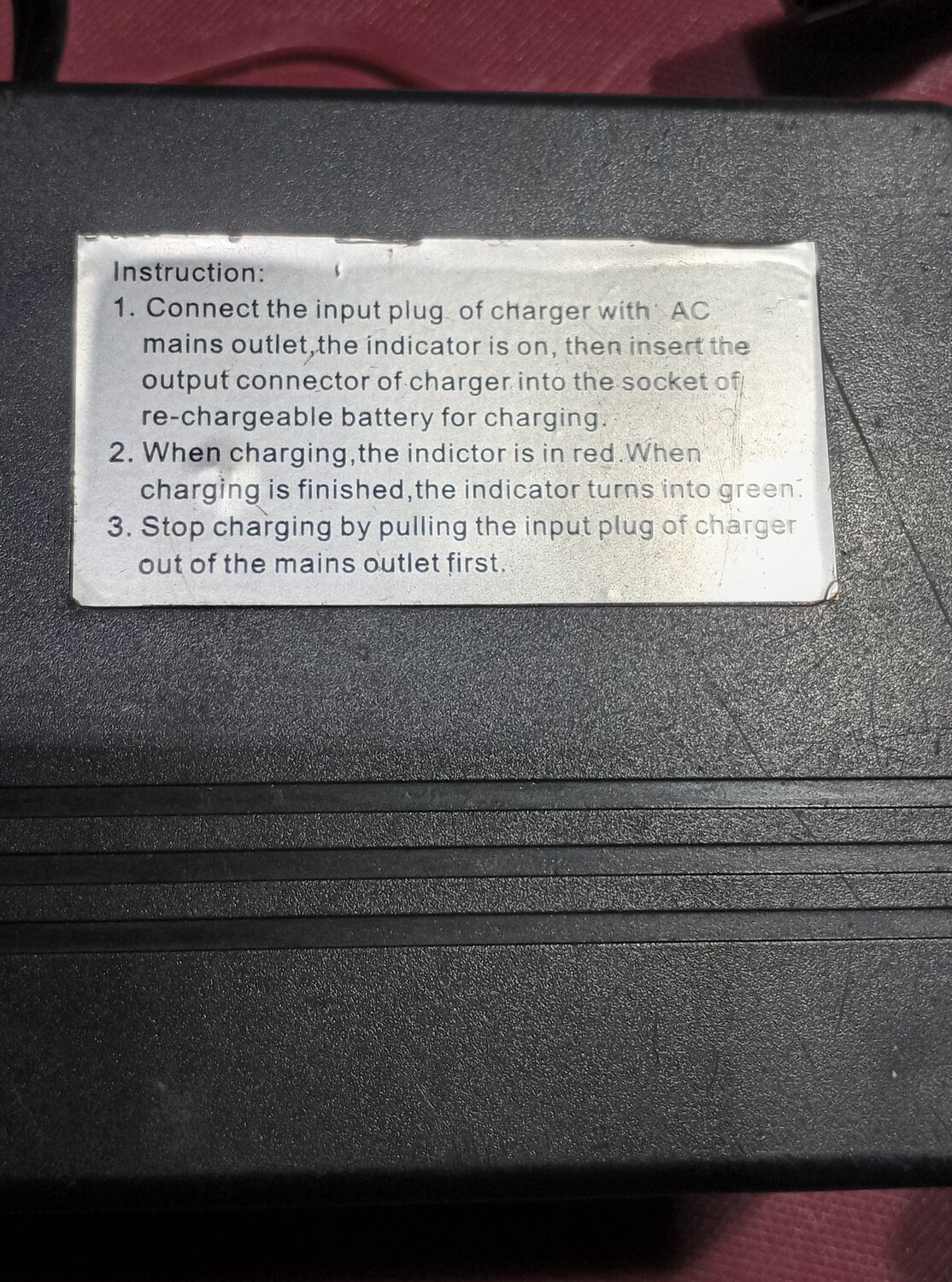

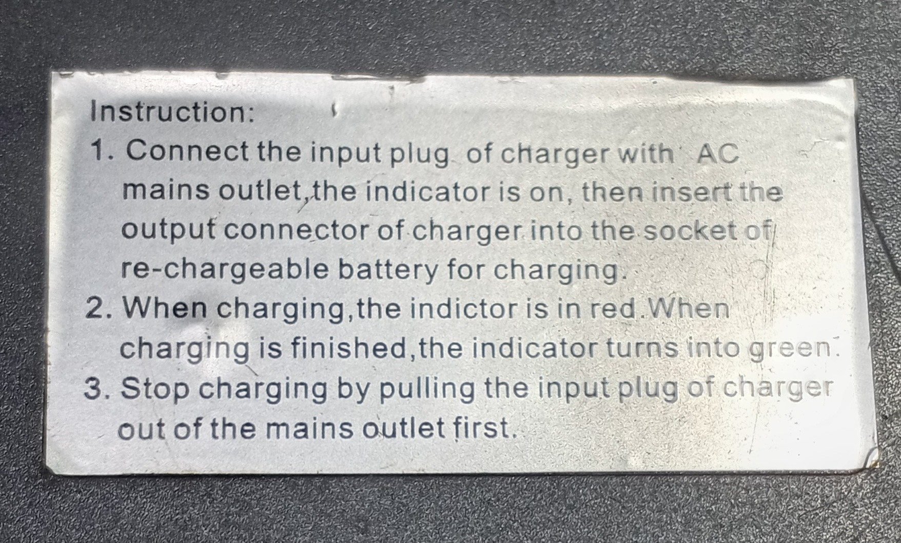

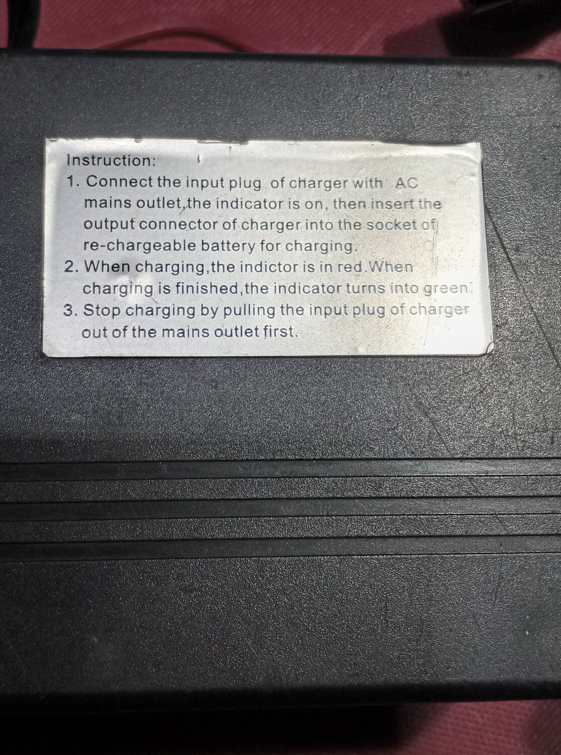

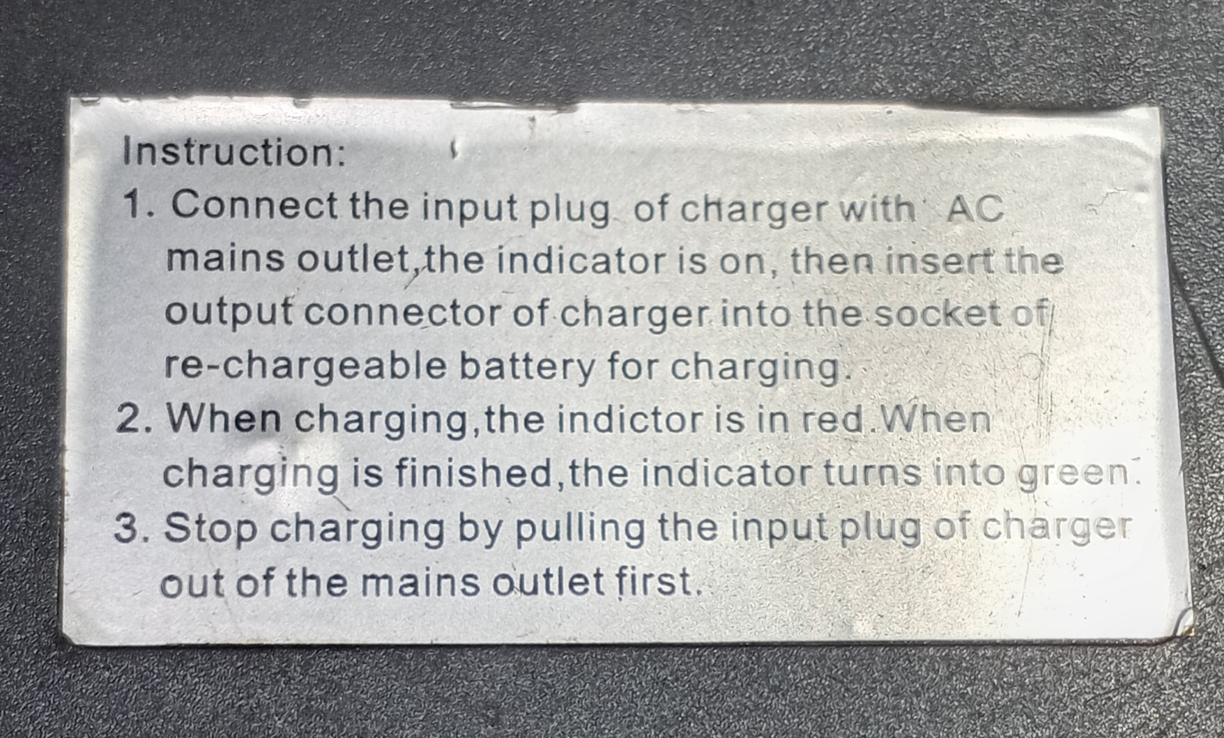

I'd say if it's printed right on the charger itself, then I'd follow those directions, followed by what's in the owners manual.

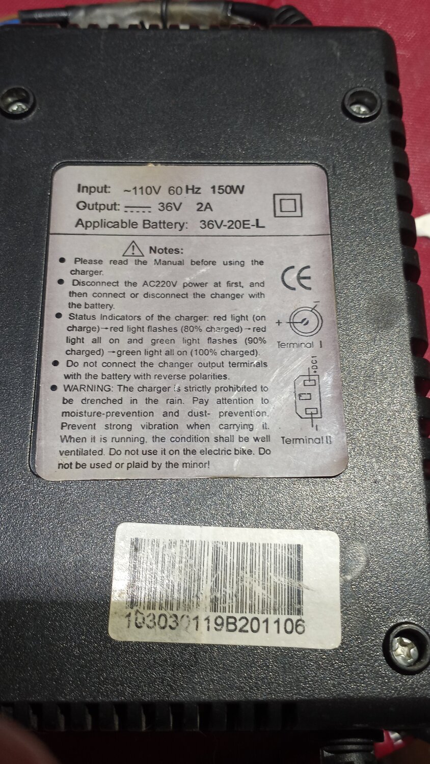

All my chargers say to "make and break the charging connection at the battery with power to the charger off." except that last picture I posted. That is a really old charger and I think it was for charging lead acid batteries.
