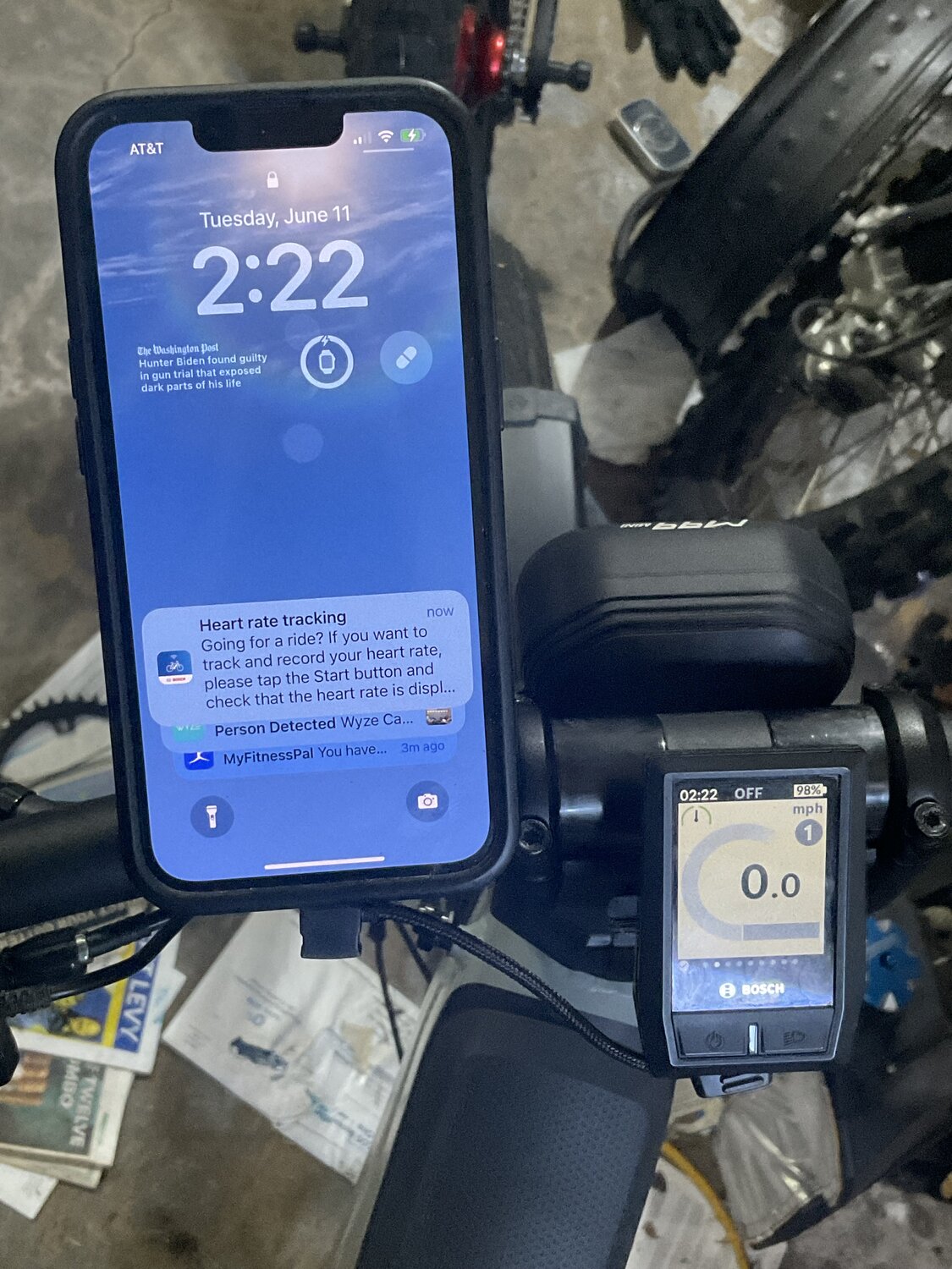

Hi All,
So “sano” (sanitary), as we used to say when I was a kid. Thought I would share. PD Design mount and case. Had to get out a mini rat tale file to make it work with the case but not bad. This is the shorter 3.9 inch in pic. Amazon link
STARTRC 11.8inch and 3.9inch Lightning Data Cable to Micro USB MFI Certified for DJI Mini 4K/Mini SE/Mavic Mini/Mavic 2 Pro&Zoom/Mavic Air Controller Accessories,Tablet Phone OTG Cables(2 Pack) https://www.amazon.com/dp/B09HZNTK1L?psc=1&ref_=cm_sw_r_ud_ct_NZAKZSVE1RTGQ1X3RES3&language=en_US

That looks like a nice setup! Love the PD mounts and cases. Know what power you are pulling from the Kiox?
Another good (longer but more expensive) cable is this one by Shure.
