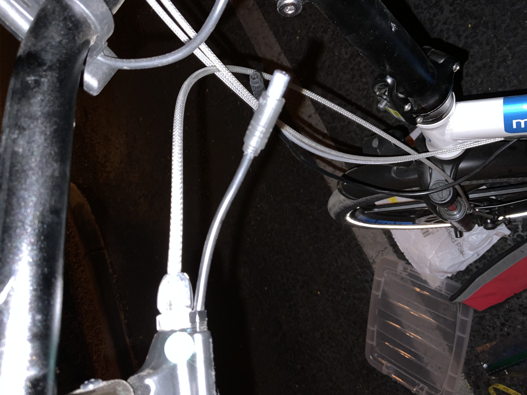

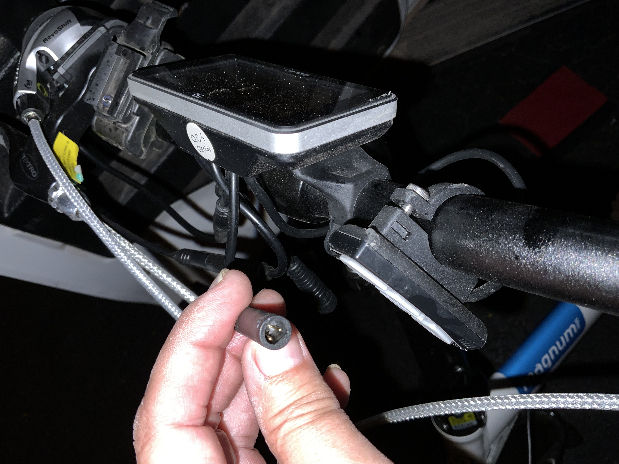

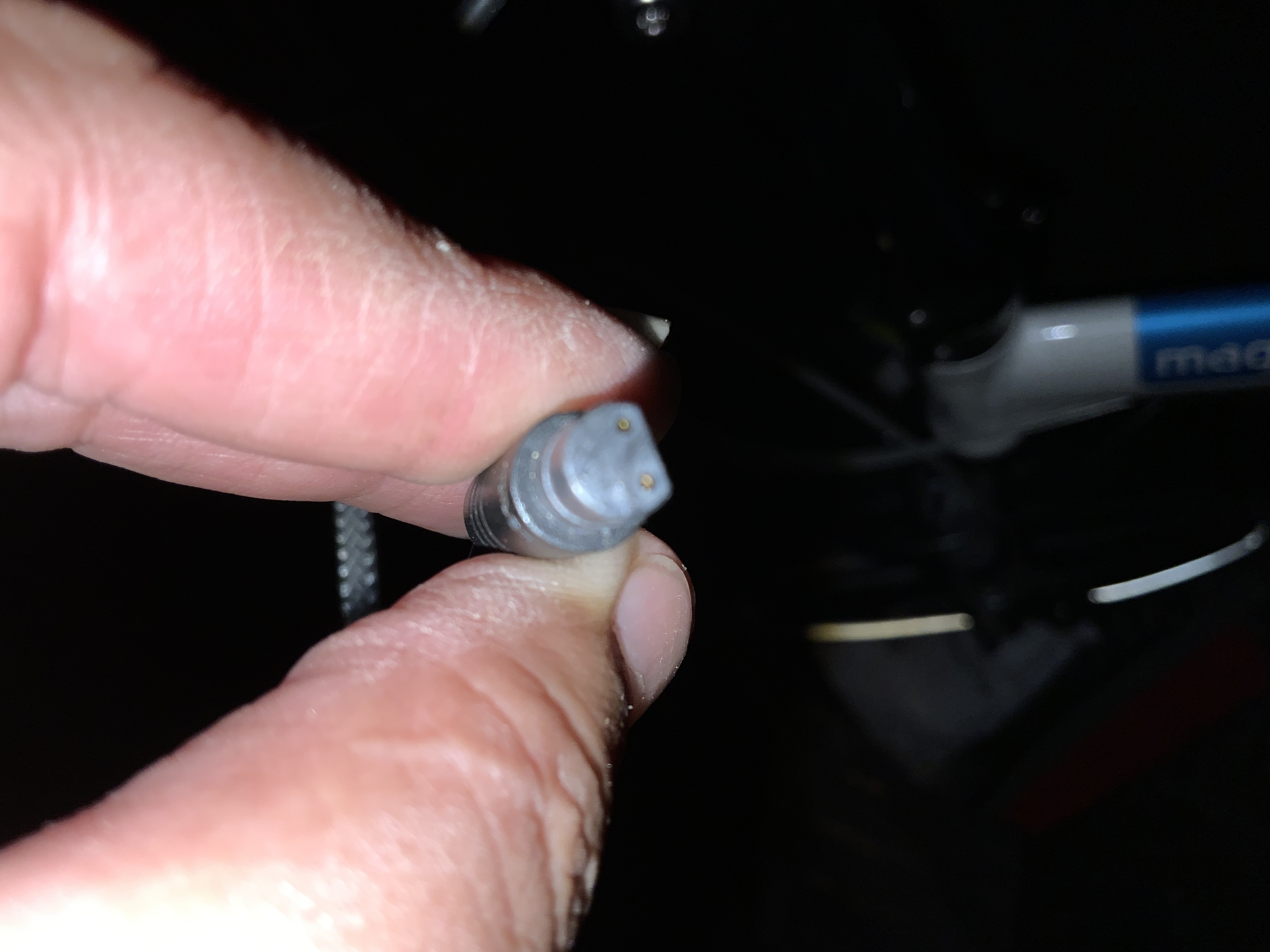

any body know where to get an adapter for this to make it 2 pin higo?
nothing other than tektro on the lever
