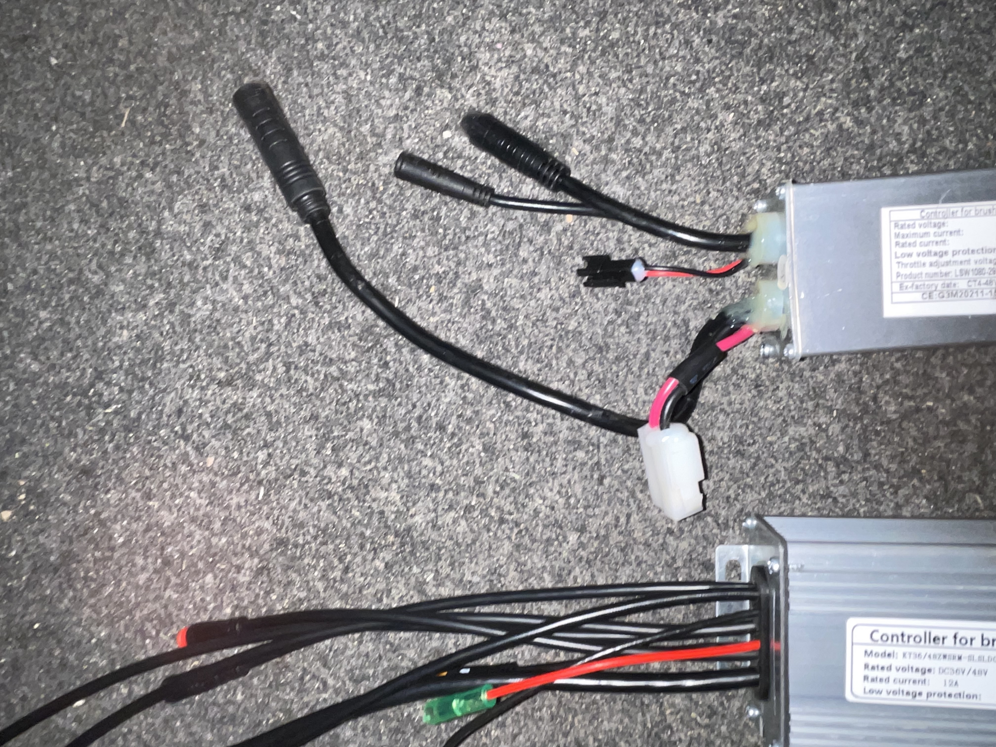

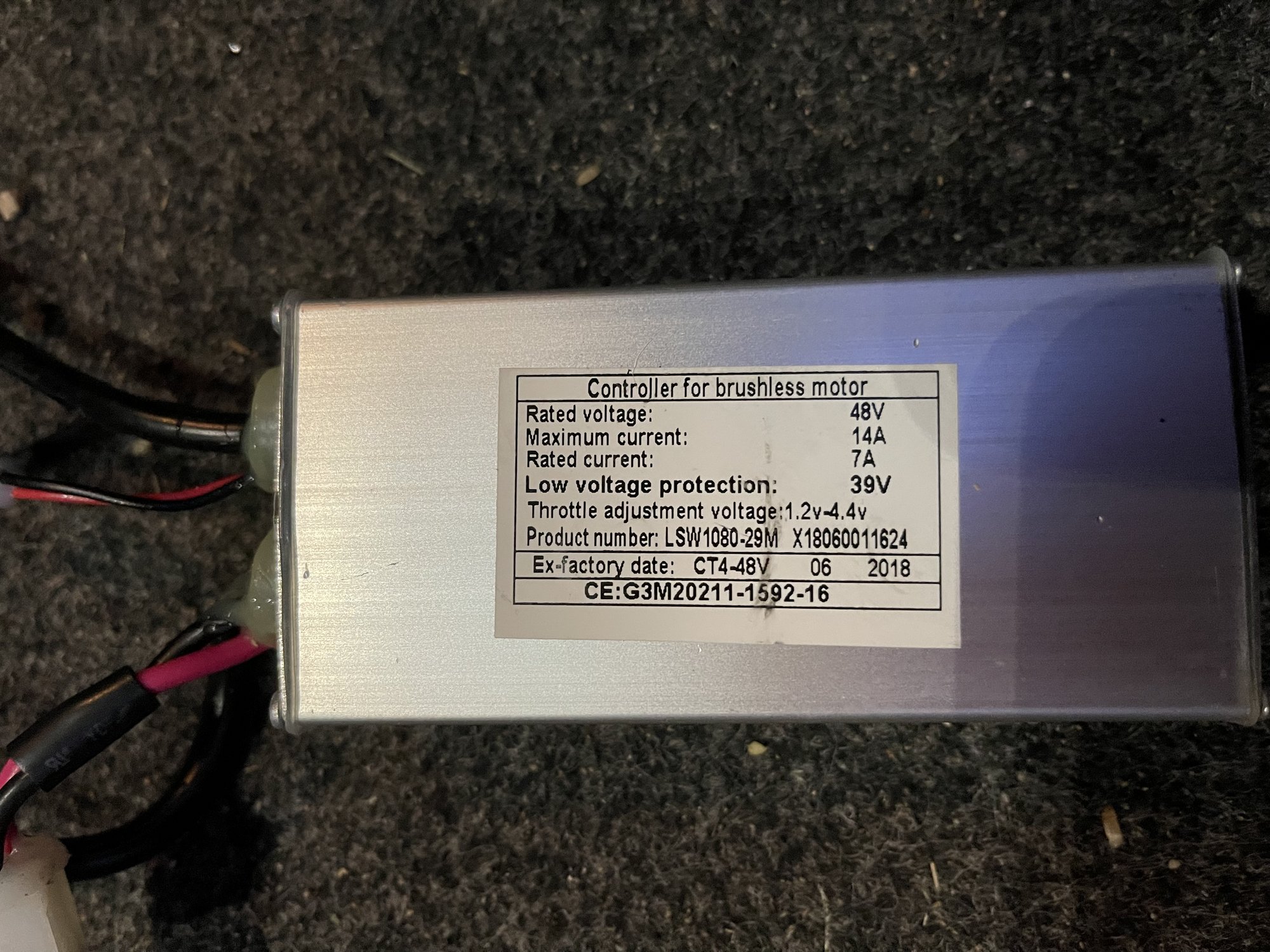

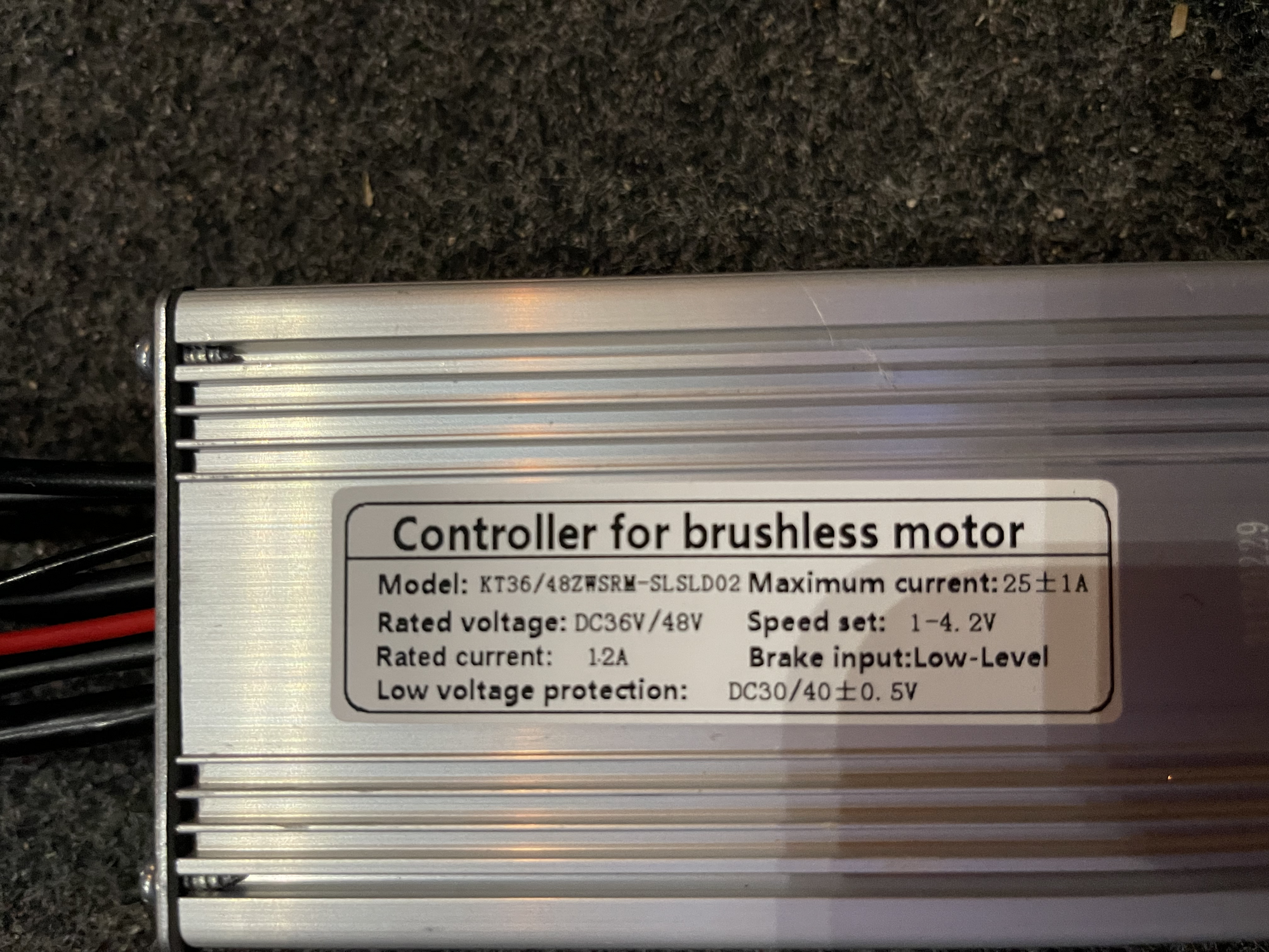

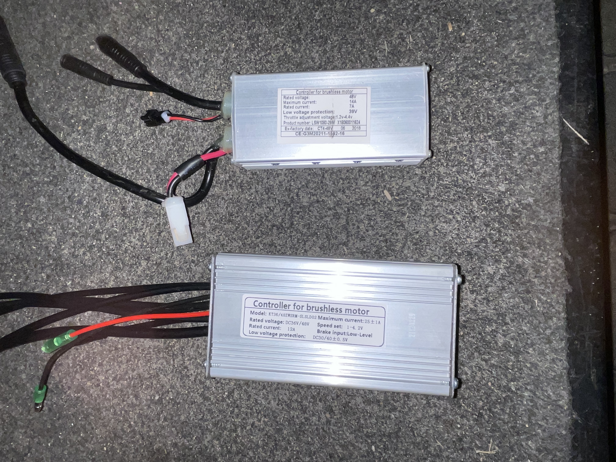

so quick update, NOT plug and play, think 2 wires will have to be cut and connecters put on, have a couple of people who i can pay to do this but may be a couple of weeks before we can get to it
other thing is this controller is too big to fit in the controller box on the bike, going to try a couple of things but 90% sure it is a no go
have no idea if there are other kt controllers that are smaller that would work..
electroworld said this was their smallest one
may have to buy some extension wires, will see
here are pics just fyi

Vincent, no surprise here that the battery input wires need to be matched up. That's a pretty common occurrence no matter the source of the new controller. XT60 and XT90 are both commonly used .
I'm curious what the vendor has to say about their "plug and play" claim? If it turns out they were full of BS, I hope you reveal who they are so anyone following is aware of the issue/false claim.
As far as the physical size fitting in to the available space, you don't mention any of your dimensions so it's pretty much impossible to comment. Further, not sure about the 25a controller dimensions. I can share the KT-22a dimensions are 36mm tall, 65mm wide, and 125mm long (maybe the same as what you received? The KT-17a, which is the next size smaller and works well with 500w motors, is 35mm tall, 61mm wide, and only 95mm long.
Wondering how they compare to the controllers you have?
Would there be any way to pack the big new controller into the available space, after leading the larger connectors outside of this enclosure? That's a neat trick/option I learned a while back. Pretty easy to conceal the connectors as compared to hiding the controller. -Al

all the 17A i see are for 250-350 watt motors
mine is a 500

One of the wife's bikes (500w motor) has had a KT-17a in it for a year or so now, and it's fine. It came out prior to the 22a/25a controller so that's what I used.
Here's the math. If we use 50 volts as the average voltage from your 48v battery during the life of a charge, and we have a controller with 17a max available, that leaves us with 850 watts capacity (50x17=850). IMHO, that's actually a pretty good match for a 500 watt motor.
Consider the 25a controller using that same 50v battery, and you have 1250w capacity - for your 500w motor. Overkill? You bet! To get PAS 1 power down where you most likely want it with the 25a controller (75-150 watts or so) you are going to be cutting the available amperage WAY back - so you would never use a lot of that 25a capacity (that you worked so hard to stuff in that bike).
Here's where the rubber hits the road. Either of these 2 controllers will supply plenty of power for the 500w motor. Both are able to supply way more power than the 500 is rated for. IF/WHEN either of these is run at wide open throttle, stuff (motor, controller,wiring) is going to start warming up quickly. Extended wide open, say for more than a couple of minutes, is going to get things hot enough where you may let the smoke of of something. Crossing a busy road, climbing a short hill, catching up with a riding buddy, anything short term like that, you're fine at full power. The 500 is pretty peppy on that kind of power. The deal is though, you WILL have to use your head when it comes to how long you are using max power - no matter which controller you go with.
That's one issue. The second is, is the 17a small enough to be of any help, or is it STILL too big?
Either controller is going to civilize that bike. There's no concern there.... -Al

Looking at the new controller think it is going to fit, will have to get a different kickstand but this one runs into the pedals so that does not bother me at all, be nice to eliminate that issue
