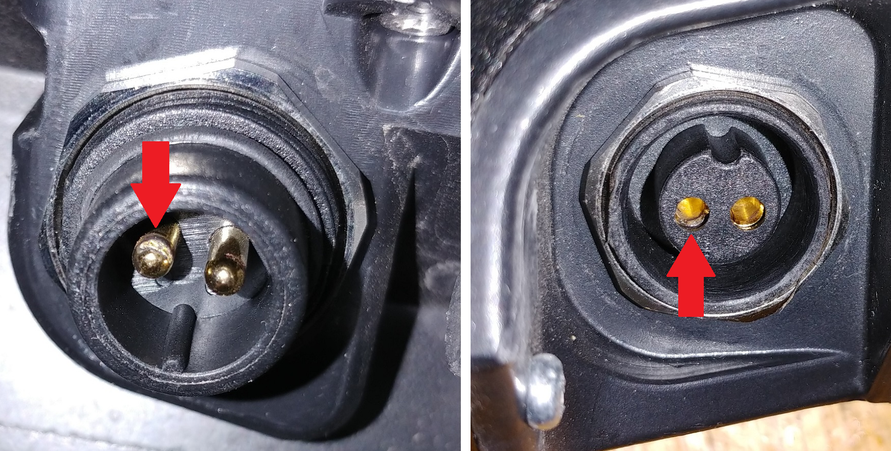

Yea I think this is still usable with your first suggestion. Looking at the wear it's appears that only the tip touches which seems really odd. It's got me thinking if the male pins got pushed in?

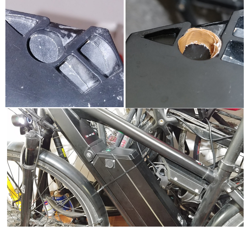

Taking out in the inner o-ring wasn't quite the fix for me. I notice that I do have excessive play now & some of that is due to the wearing of where the bolt locks into the battery. For now I've put a couple pieces of tape in there to make the hole smaller so it pulls the battery in more. Hopefully it holds up.
The whole issue on the battery contact is the pins are only going into the female using a 1/16th of an inch or less contact. Look at those pics, pins should go in at least a 1/2in to make a quality contact. I've never seen pins that contact so little in all my life. That's the friggen issue, period!

Same here, I opened a support ticket for my 17.4ah battery and it looks like the pins are pushed back. They are charging me $80 to diagnose it. I already replaced the male connector when I upgraded to the CCS controller and there was no change. Fortunately I’ve been able to ride my 500wh battery in the meantime albeit with a lot less range. My 500wh battery works perfectly every time and has never had any issues with losing power over bumps. Here is the link Juiced Bikes support sent me:

I had the intermittent power problem. In my battery the connector sleeves were never displaced (pushed in) and still the engagement of the pins into the sleeves was not enough to prevent a blackout on a bumpy road. By removing the back o'ring on the male connector and using two velcro straps the problem in my bike is under control. Solved, but not to my satisfaction.
My point is that there still seems to be a problem of not enough engagement of the male pins into the battery connector sleeves, even when the battery connector sleeves are in the correct position.

@Tora Harris, regarding the video that shows how to use a soldering iron to displace the male pins of the frame connector, it may be bad advice, I agree 100% with your assessment, but the video points to the real problem: poor connector engagement.
In my CCX battery the female sleeves are in the correct position. I ordered a spare frame connector assy. from JB and dimensions of the plastic parts and the connector pins are the same as in the original set that came with the bike, no changes there. So, even if the battery connectors have been improved, still there seems to be a dimensional problem with other parts, that prevents a reliable connector engagement.
As I pointed in another post, I solved the problem by removing the o'ring on the back of the male connector and using velcro straps to keep the battery to the right as much as possible. Probably this is also a bad advice... but it worked for me...

I have utilized a tie wrap connector and a shim on the battery mount to secure the battery which seems to alleviate the problem but given that I commute 20 miles each way I'm not entirely comfortable with this solution, and will likely send the battery back to Juiced once again under warranty (and once again at $40 UPS ground freight at my expense) for further repairs.
