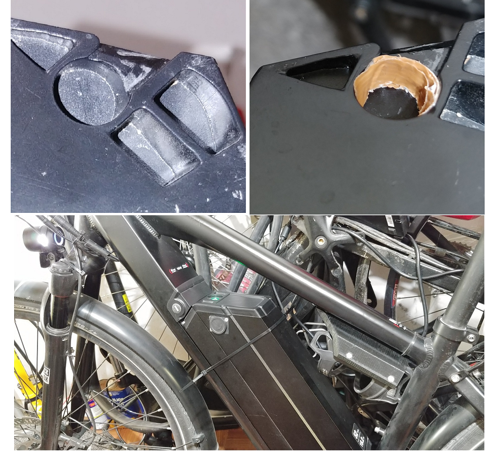

The zip tie is just a suggestion in place of Velcro. I kept it near the top where the connection is. Gave it enough slack so I could slide it off, but tight enough to stay put. My thought is that a zip tie might provide more constant tension like a rubber band vs a Velcro strap. At the time it was also what I had handy.
Wow! You really took all the juice out of the old Cross Current!
The velcro straps I am using are as good as a zip tie in the sense that they are not elastic at all. I use two, 2" wide, 24" long. (link)

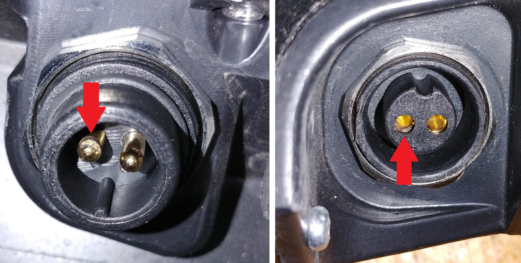

Welp I've run into this problem now. Clear signs of arcing on the contacts. And since my headlight is activated immediately whenever the controller gets power it's easy to tell that the problem is mechanical since tapping at the battery can get to turn on temporarily. Will post some pics later.

@youth , I am going to repeat my suggestions. Should the contacts be spoiled beyond "reasonable" (that is, damage extends more than the very edge of the female contact in the battery) then ask Juiced support to help. If the battery contacts are still "reasonably" ok despite the arching, then:
1. remove the o'ring behind the male connector -the connector in the frame. Tighten the silver nut without overtightening. For this step you need to disassemble the receiver-lock; I explained somewhere above in this thread, which o'ring it is and how to disassemble. This step will make the male pin contacts engage about 1 mm more into the battery female contacts.
2. use one, or better two, velcro straps 2" wide x 24" long, non-stretch type to keep the battery against the right side.
3. power up, turn display on, hit hard the battery on the right side with your hand. Display (and also the light, in your bike) should not loose power.
Hope this helps. It worked for me.
Yea I think this is still usable with your first suggestion. Looking at the wear it's appears that only the tip touches which seems really odd. It's got me thinking if the male pins got pushed in?
Taking out in the inner o-ring wasn't quite the fix for me. I notice that I do have excessive play now & some of that is due to the wearing of where the bolt locks into the battery. For now I've put a couple pieces of tape in there to make the hole smaller so it pulls the battery in more. Hopefully it holds up.

The area of where the bolt locks the battery pack in place should be reinforced because mine is starting to show some wear. How often do you remove your battery pack?

Your contacts seem to look ok. Mine had plastic melted onto the pins. The only thing I’ve done is use a 24” Velcro strap near the top of the battery that I ordered off Amazon. IMO, I think that’s a better option than a zip tie since I think there’s less play/stretch and it keeps the battery tight to the frame. It also allows you to easily take off the battery still, even though I leave it on at all times. Time will tell if this holds up, but I’ve had zero problems since Jul/Aug with this solution.
$8 on Amazon.
CandyHome 20pcs Reusable Fastening Cable Straps and Cable Ties Set, Adjustable Multipurpose Hook and Loop Securing Straps for Cord Management https://www.amazon.com/dp/B06WVCGC37/ref=cm_sw_r_cp_api_i_tEGPCb0H459QS

If the battery has too much play, just removing the back o'ring of the male connector will not solve the problem, given that the o'ring removal adds about 1 mm of pin engagement, at best.
I measured the distance from the edge of the male connector and the tip of the pins, for both the positive and negative pins for the Juiced connector. The positive pin is shorter than the negative pin, what may us believe that the pins have been pushed in. Here are the distances I measured:
"+" pin = 0.108", "-" pin = 0.075"
Some other members of this forum have also mentioned that one of the pins in their connectors was shorter. I consulted the Juiced support group regarding this, and they answered that the "+" pin is shorter by design.
