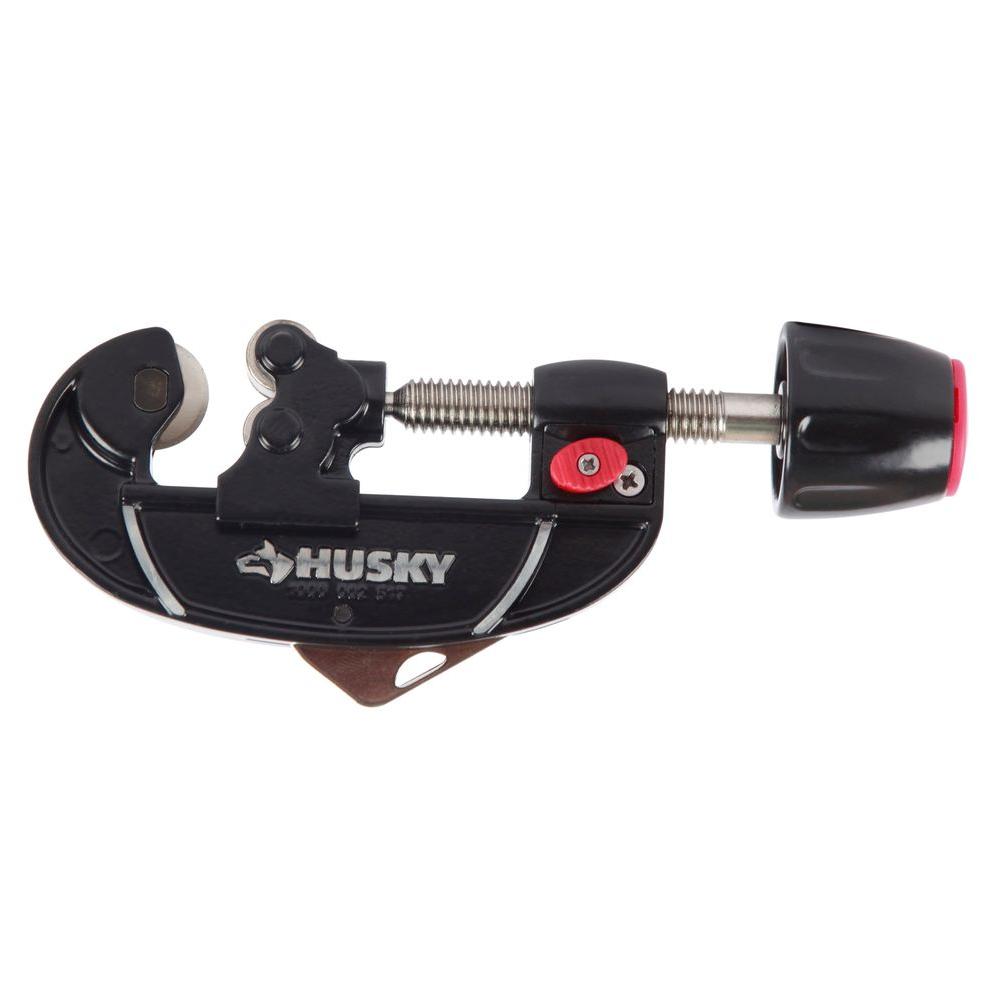

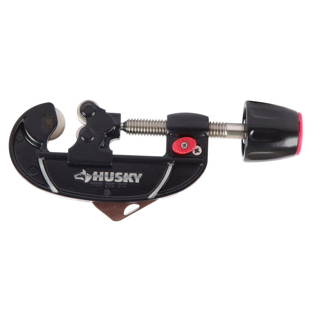

Reid, is that what you used to cut your bars? Did you have any issues doing so?
Yeah, Chris, that is the exact tool. I linked it because it is a value priced tool readily available. Check out a YouTube video for tips if you never cut tubing before? It is a super easy job to shorten your bars but reinserting the stock grips is a bit of a trick! Remember to de-burr the ID of the cut.

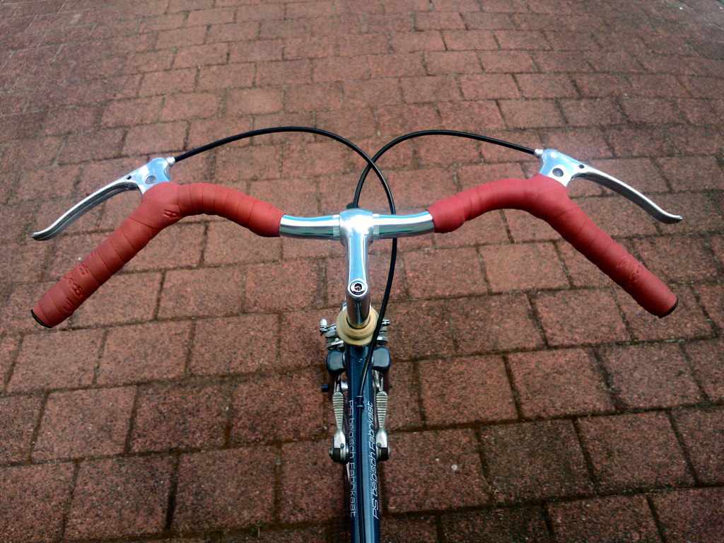

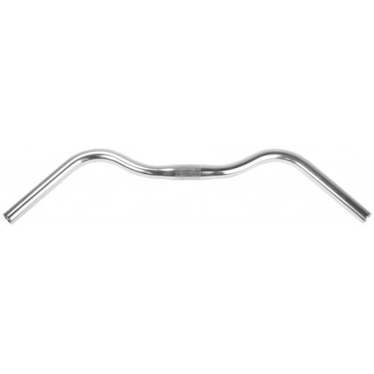

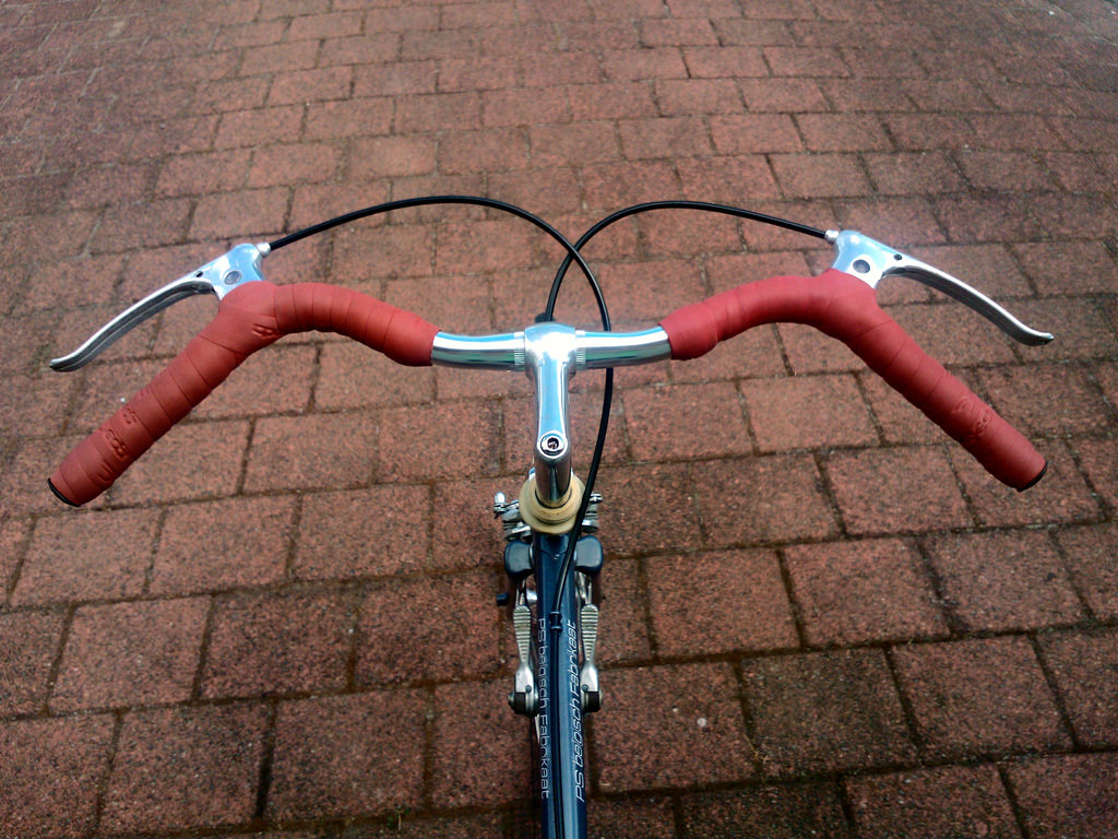

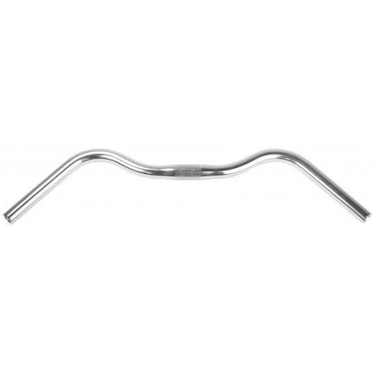

I got the new handlebar I wanted (not what I mentioned earlier), and it's a dream. The Velo Orange Postino. $30.
It's early, but I think this is the perfect bar for athletic urban commuting: multiple positions does not make sense, because you need to access brakes and preferably shifters at all times, while being able to go upright or down low as needed.
Also, try holding a rod with one hand. The most comfortable angle is not perpendicular to your hand, but at a 45 degree angle, which is exactly what this bar has (as well as the Jones H bar). Same for SQLab's urban bar, which is very similar to the Postino, but you can cut the SQLab down to size, though it doesn't have the nice polished finish the Velo Orange Postino does. Velo Orange has the Milan which is similar, but is not as swept back; I went with the Postino because the 45 angle seems most ergonomic.
The positioning is a little narrow at first, but it gives the bike a terrific sprightly feel, even without the power on as I discovered. The 45 degree angle plus the palm rests lets you lean forward and flex your lats, and really hammer the pedals. And despite that, there was virtually no weight on my wrists. My quads began to burn almost immediately in a good way (much like DOMS).
