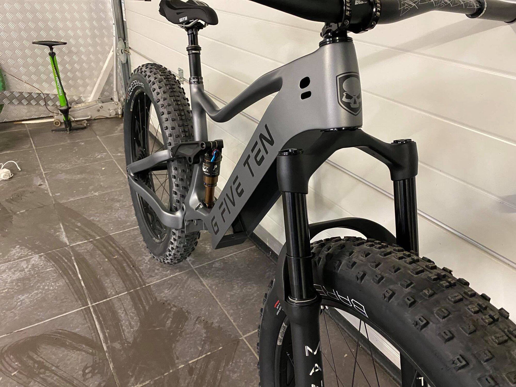

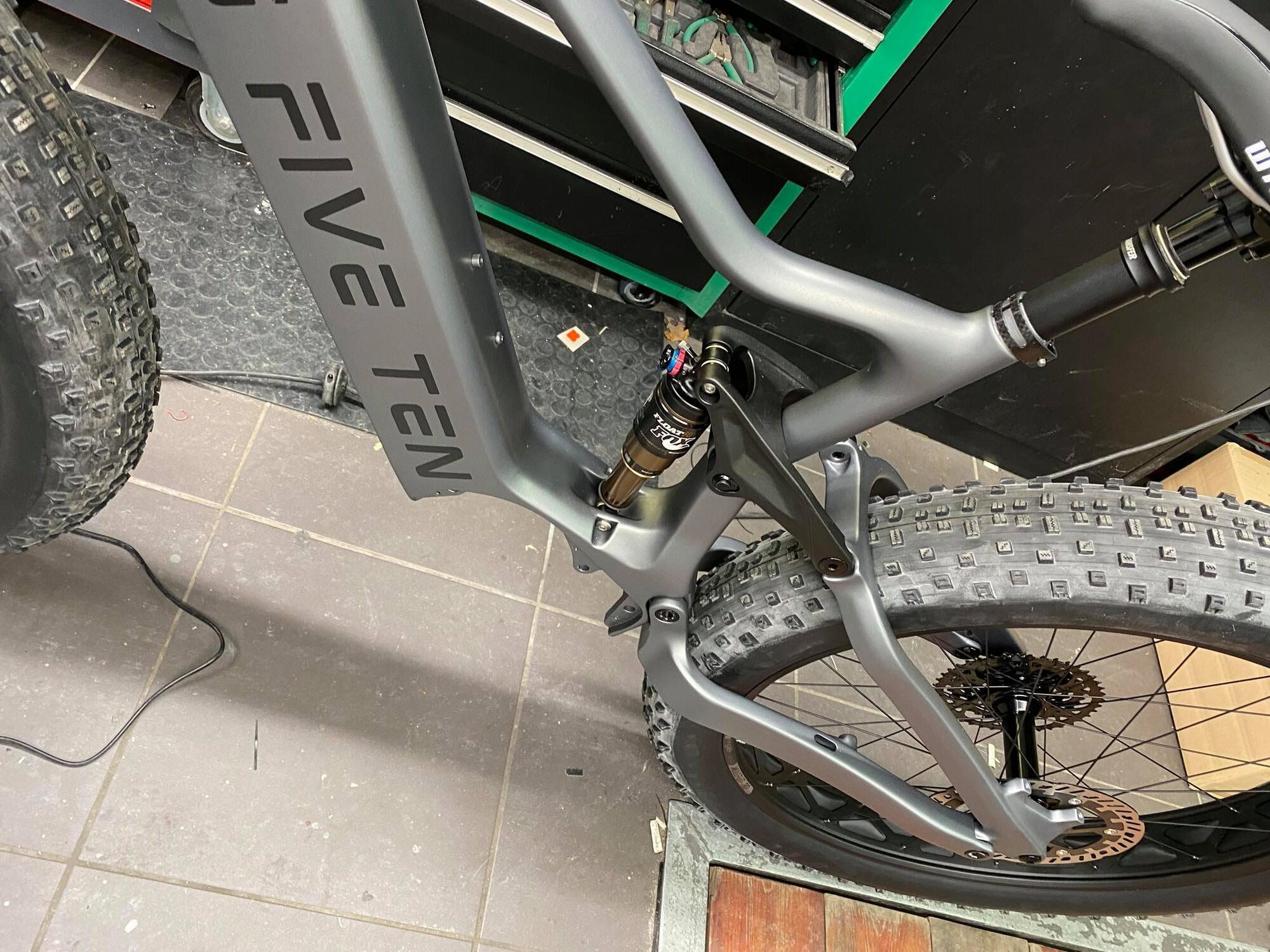

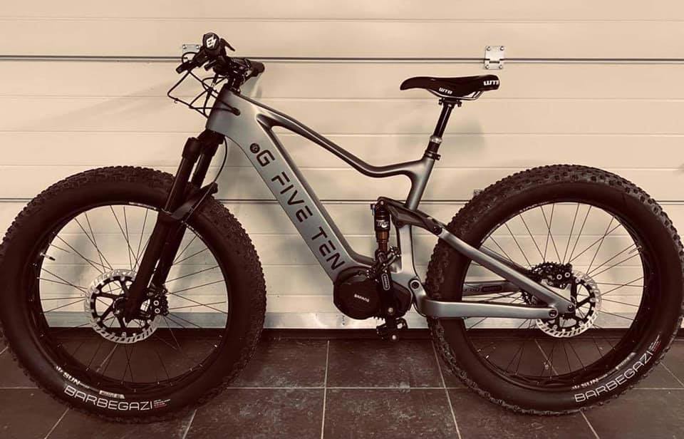

Fantastic looking build! Great job!
A couple of quick questions if you don't mind:

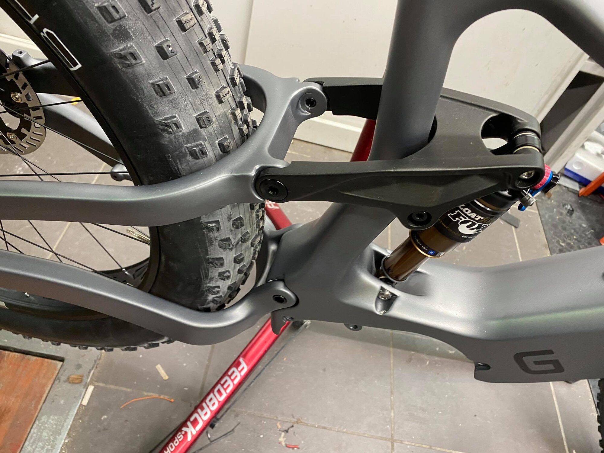

Have you test fitted the Lou 4.8 on the rear to see how much clearance you have?
How is the clearance between the Mastodon and the downtube? I've seen in pics of some they use a crown race spacer with that fork, I was guessing one may be required.
Thanks, it's certainly worth it.
The answer to both of your questions is, theres loads of room. I've not put lou on yet as i don't need to check, i knew beforehand it would fit and when you look at the space left over it'll clearly fit, same with the forks, loads of clearance, the issue most people are having is pedal strikes which is why i've got some hope 155mm cranks on the way.

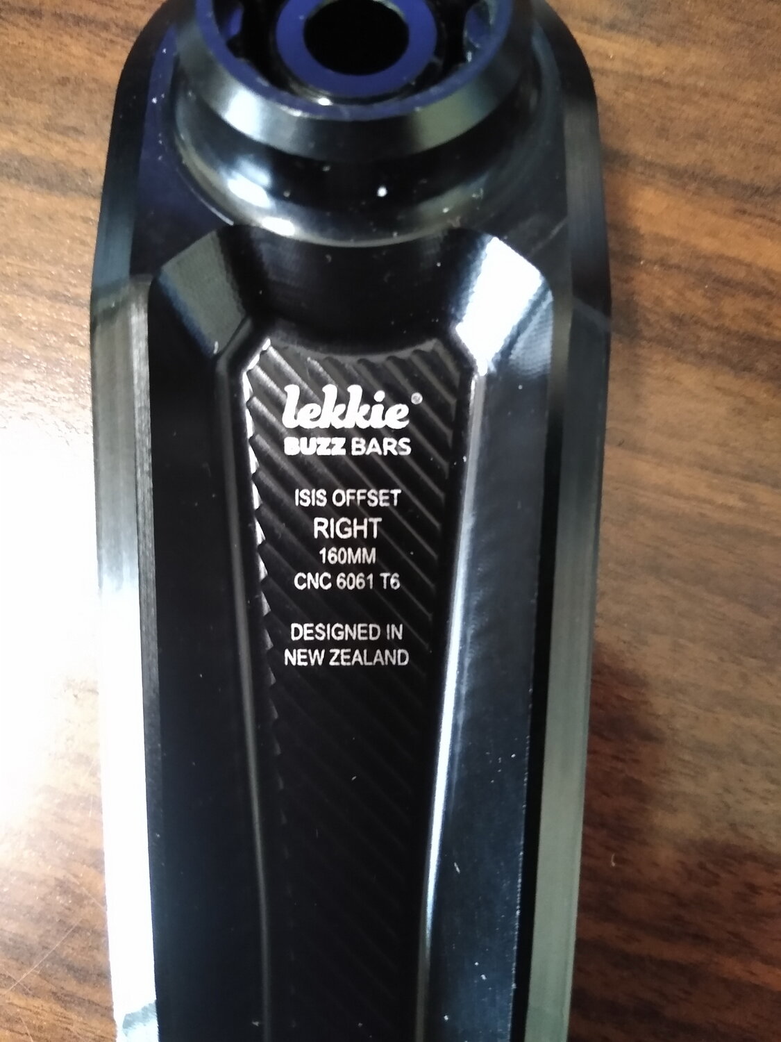

Thanks. Yeah, I've got 160mm Lekkies ready to go on whenever my bike finally gets here.

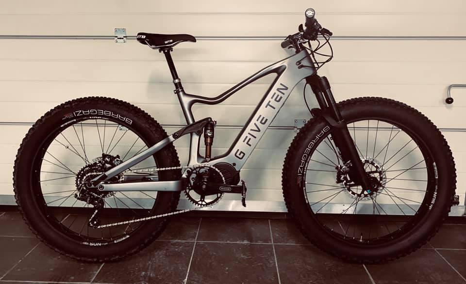

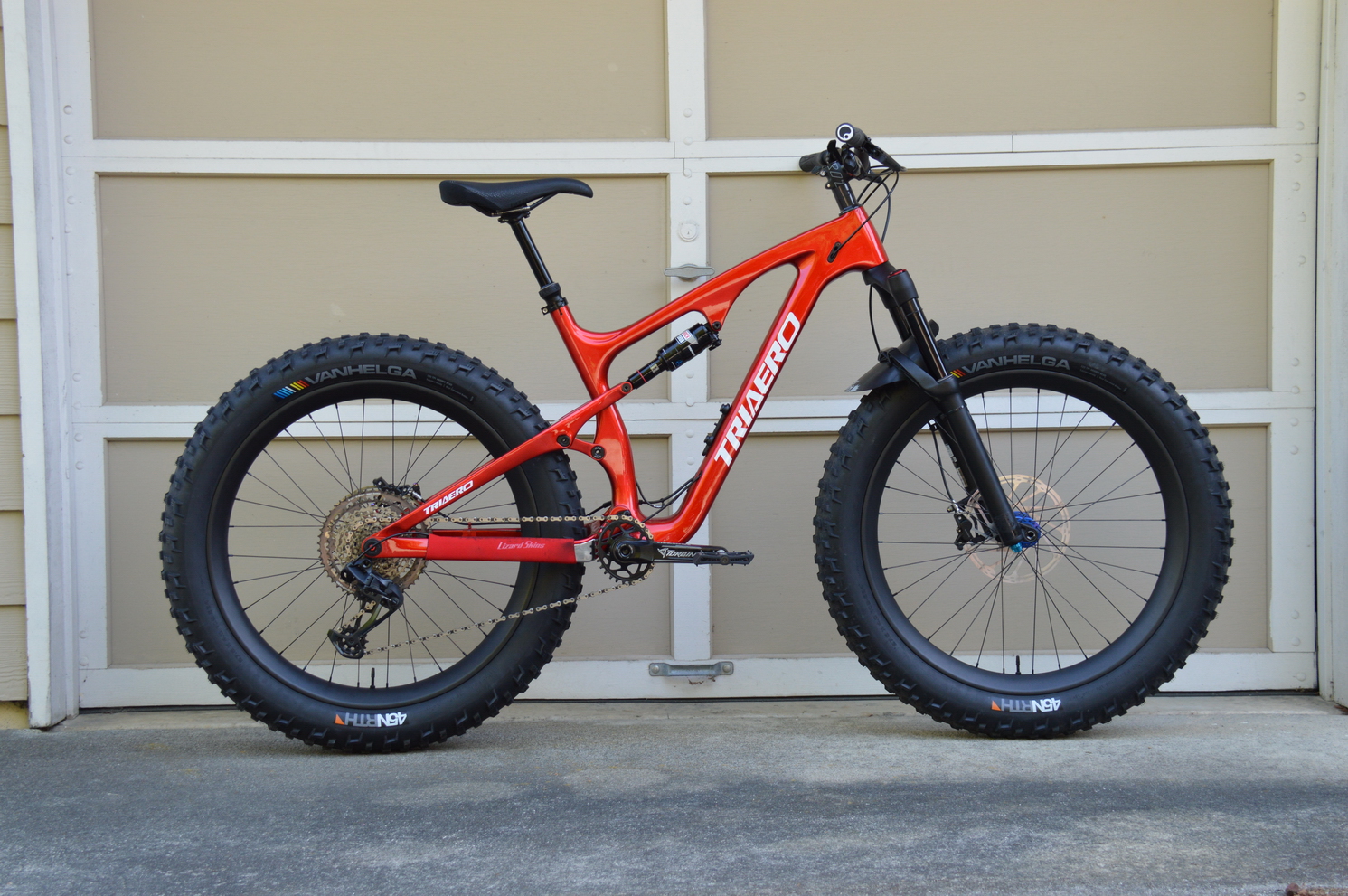

I would add that handling security is only a part of the fat tire equation. Also relevant is shock absorption to the frame and the rider. The bike pictured below was my daily driver for a few years, and still is on occasion. In that time I did fat tires, tubed and tubeless, skinny smoothies and stuff in between. You see here the two extremes.
Thats a 30+ mph pedelec (note the chainring size, mid-length cage and small cluster). I loved the smooth ride and grip of the Crazy Bobs, but riding on the mean streets at ebike speeds, the pavement just gave me a pounding. Thats a top-quality hand-made-in-USA frame but even so there came a point where I wondered if I was compromising its long term survivability, so I went back to fat: 4" smoothies on it now, so I'm in the middle.
Are they isis splined? Check to make sure. Has any of your bits turned up yet? The motor took 3 weeks for me, frame 4, i've also noticed yours is slightly different, If you look at the bottom 'tube' yours has square edges mine are bevelled, the picture on the website is square like yours too. Odd.
Yup!
I got the ones with offset, assuming it would be needed to clear the Fat chainstay...hopefully that was the right choice!

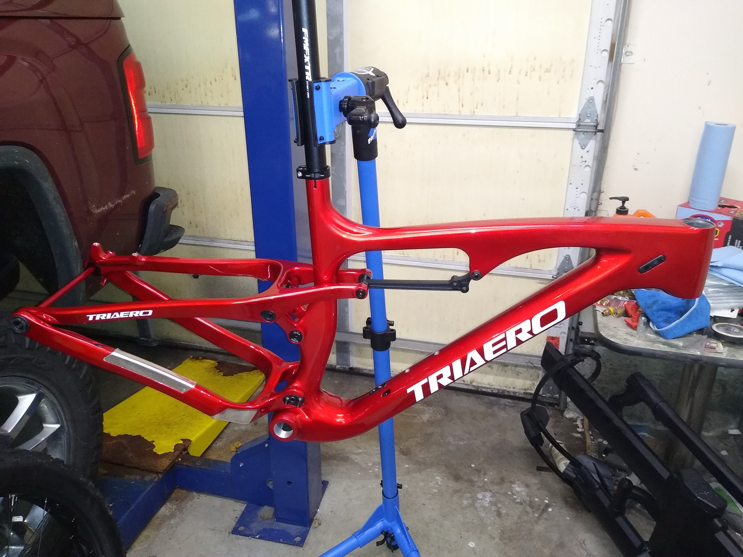

Interesting, I hadn't noticed that! It might be possible it's just the way the light is hitting the frame in the pic making a shadow...I sort of hope that's what it is as I like the way yours looks. Hopefully I'll find out soon.
Yup!
You ordered the right ones.
Well, I finally have an answer. Looks to me like my frame has the same bevelled edges as yours, so people don't need to worry about there being different versions of the frame:
I also found your build (there doesn't seem to be very many of them online compared with some other frames), very nice! It looks like you had a 27.5X4.5" Barbegazi on the rear in one of the pics--how much tire clearance do you have with that tire on there?
Sorry for the late reply.
27.5X4.5 is really not that much bigger.
More then enough clearance.
The Ultra has a 3500W controller.
So I went for a 14S5P battery with 30Q's

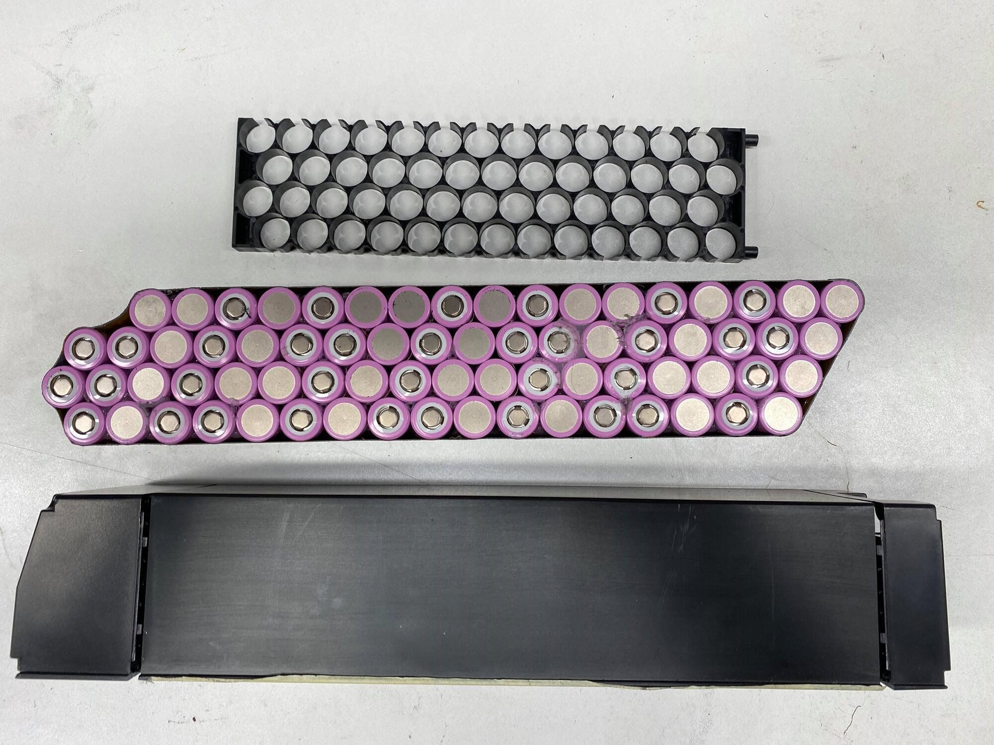

I’ve got most of the parts ordered, but I am struggling a bit with the battery. My original e-fatbike build has a 1092Wh battery in an off the shelf Mega Shark housing. I’ve gotten quite used to the range it has, and was really hoping to increase the range of this bike.
I noticed you were able to fit a 14S5P battery in there, which is a nice increase in size. How did you go about having the housing increased to fit the extra cells? Did you develop the 3d printed parts yourself, or have a company make them for you?
I bought an extra battery case (thanks for the tip on that Haystacks) so that I can use the factory battery for now while I try to sort out a larger capacity battery for the frame.
Open to any suggestions from folks who know where I can get a bigger battery made up.
Hi Daxxie,
I squeezed 14S5P in the original housing. It is a tight fit and I had to move the on/off button to a different location.
No room for the BMS so I placed the BMS on top of the case.
In the frame a hole was made for the BMS.
Saw a guy that put 70 x 21700 in the frame but that takes a bit more creativity.
He hacked the frame and made his own box.
There is also a company that sells bigger batteries for the E06 / E09 but it sticks out the frame.
20Ah / 48v (960wh)
