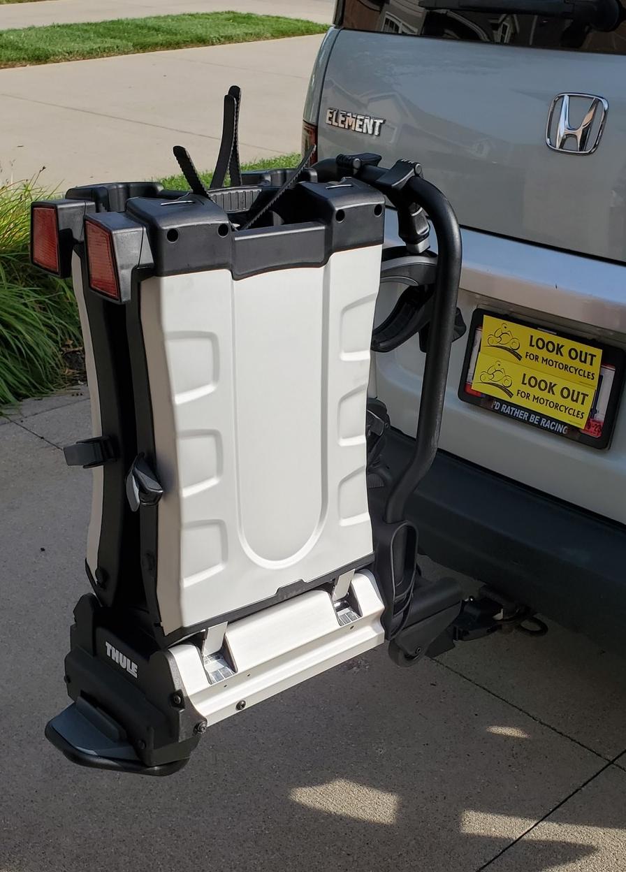

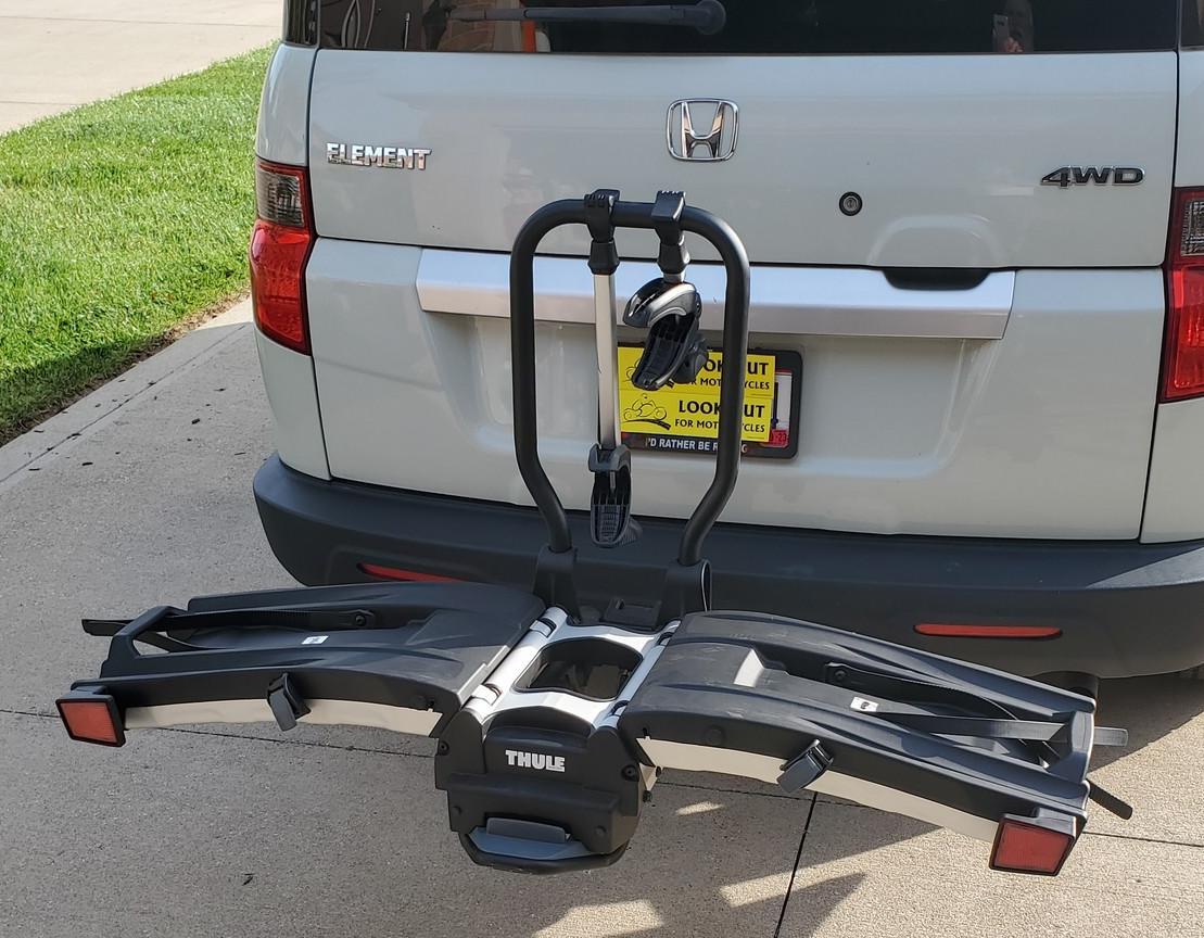

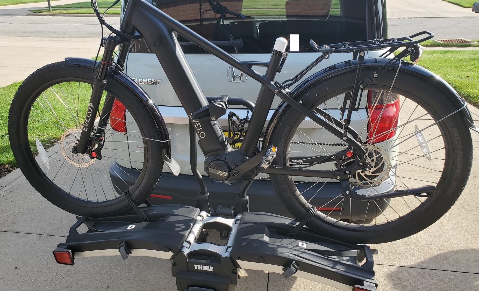

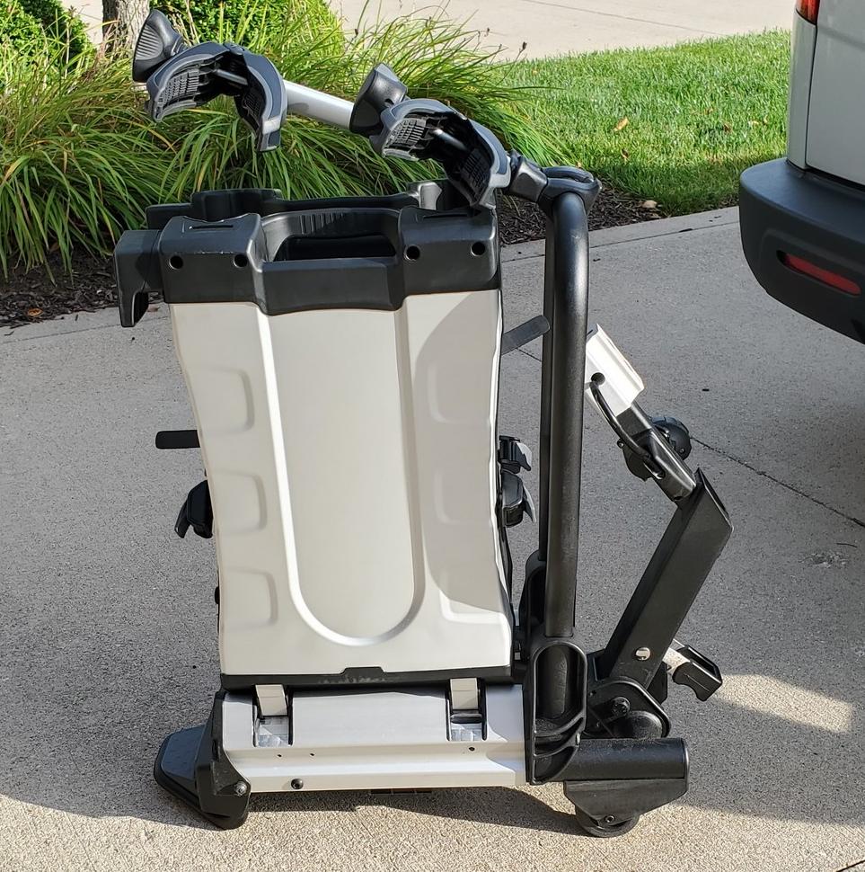

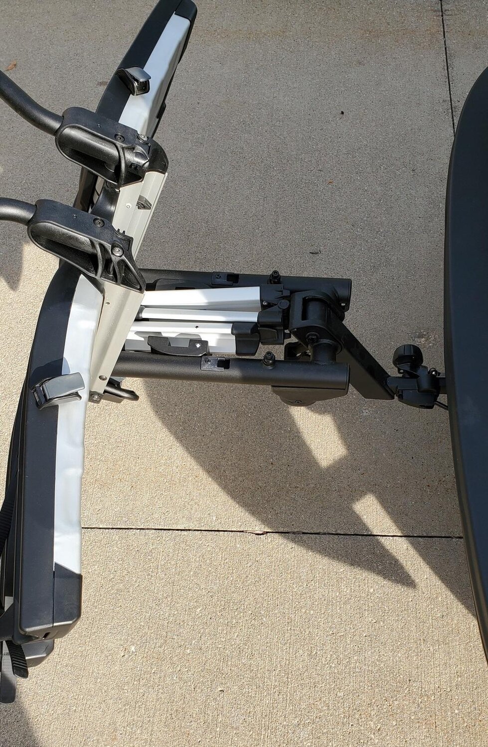

This thread is pretty old, but seems to be the best place to update everyone on the Thule EasyFold XT (which I just "discovered" in the parking lot of our local bike trail). Just received mine via Amazon, but they're also available from etrailer.com for the same $800. Obviously not a cheap rack, but I've tried several generic brands and a few Saris models, and they've all been a bit lacking. I've been using the Saris Freedom II which is a compact and lightweight rack that's rated for 60 lb ebikes. But mounting the inside bike is very difficult due to the center post and wheel pocket design. I also purchased the Saris Superclamp EX 2 (last year) but sent it back because the tire clamp system could not accommodate fenders and rear racks.

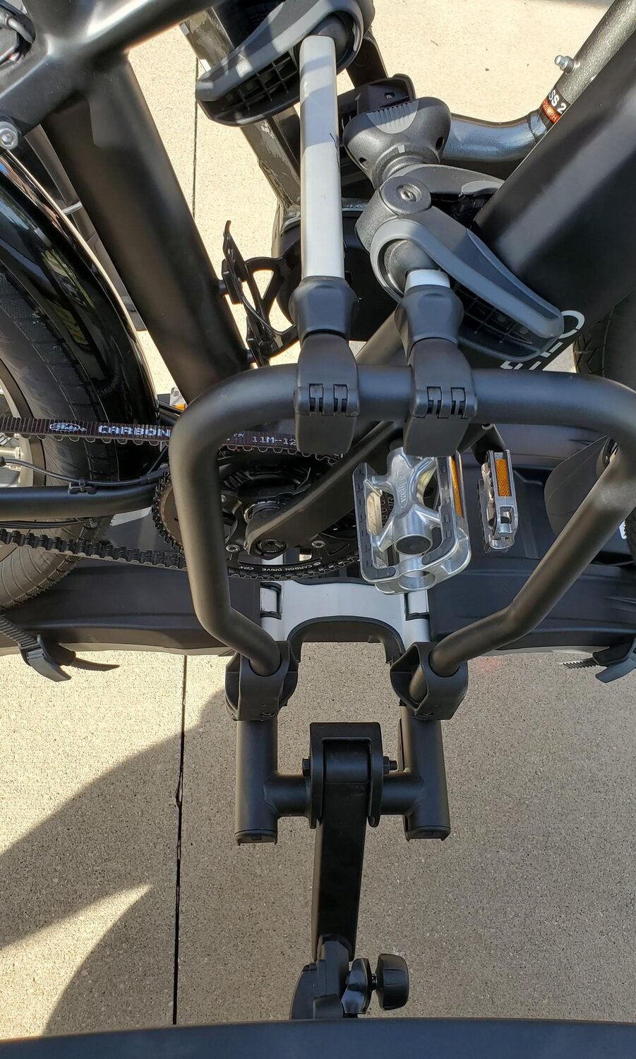

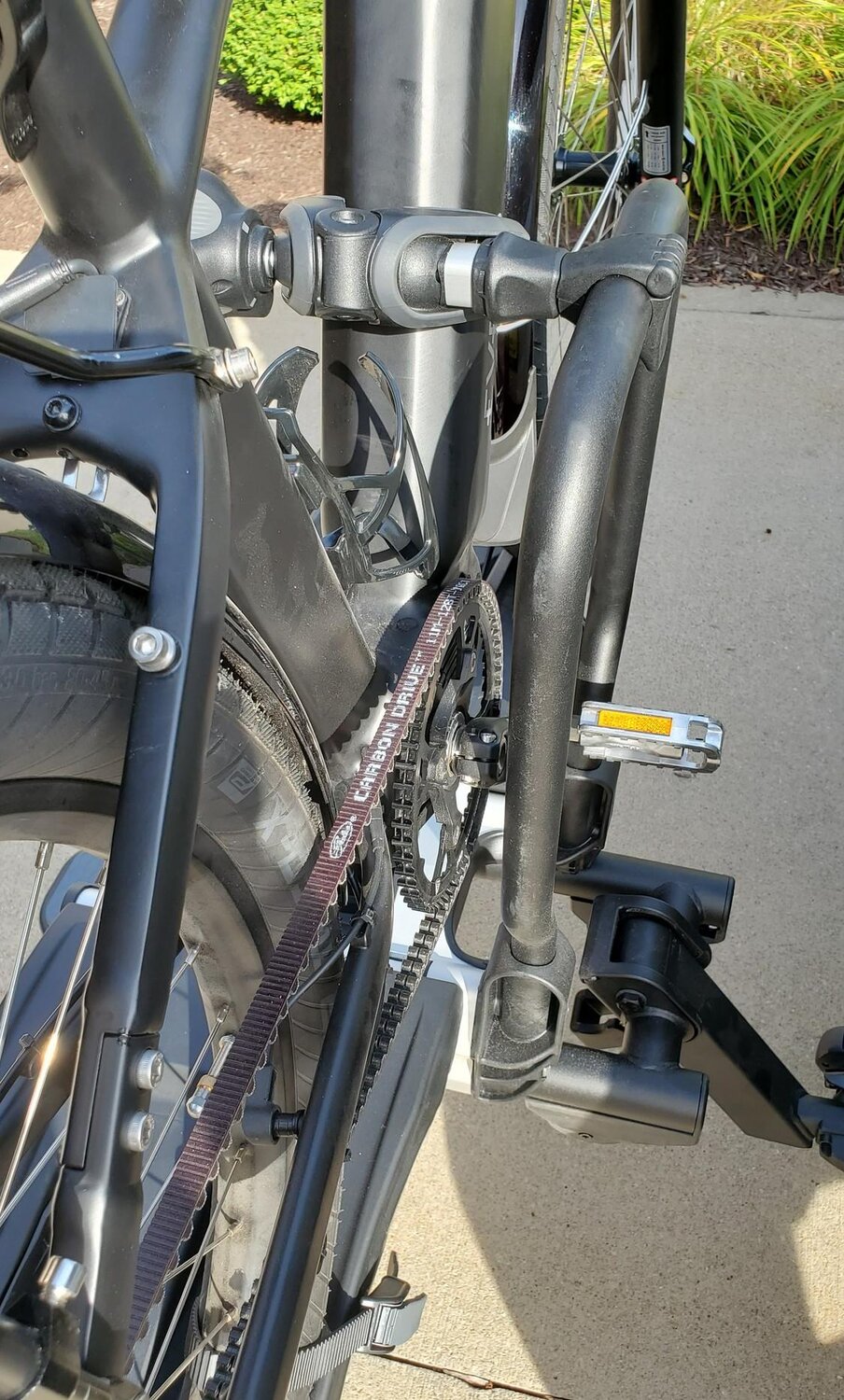

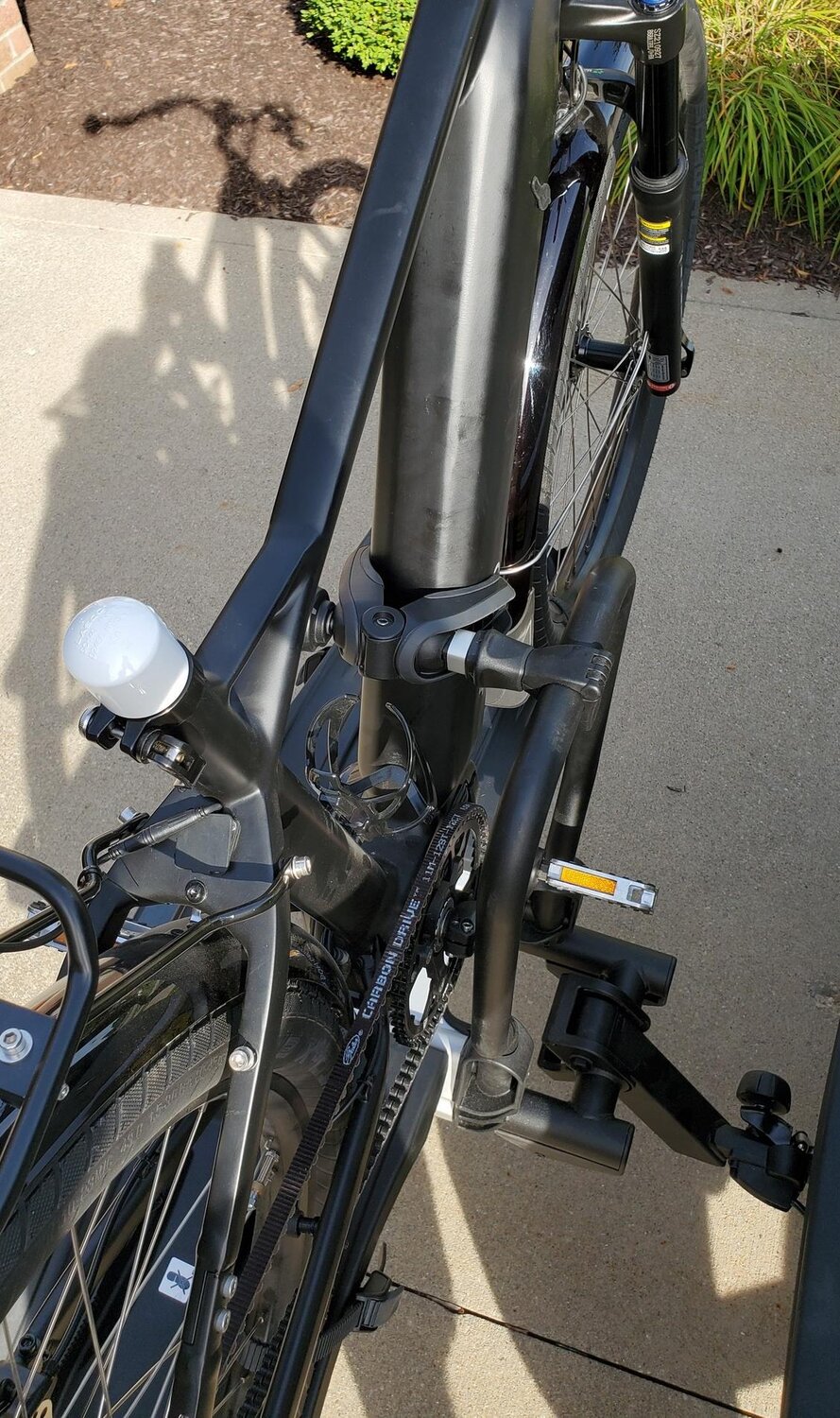

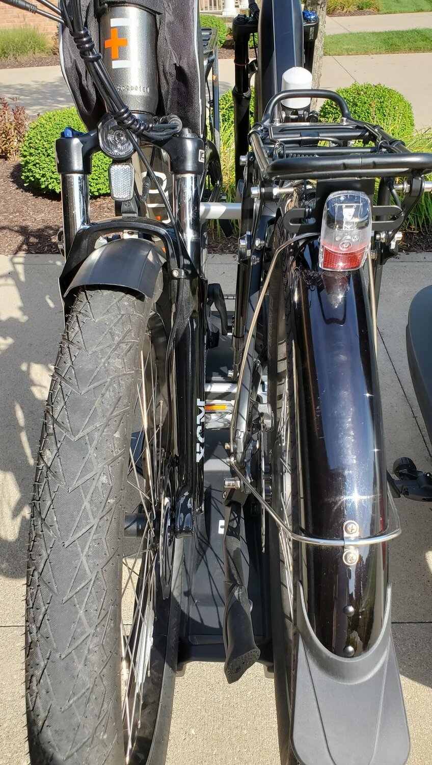

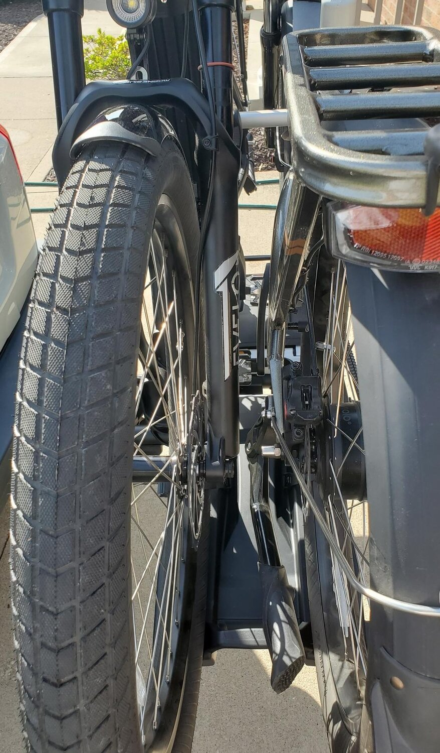

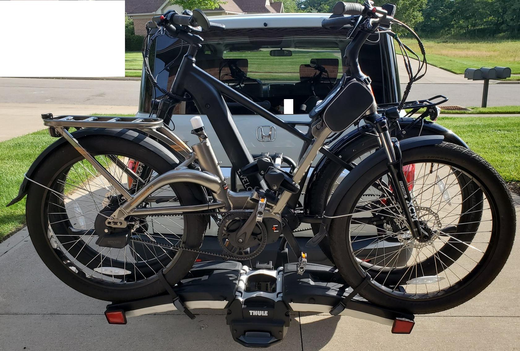

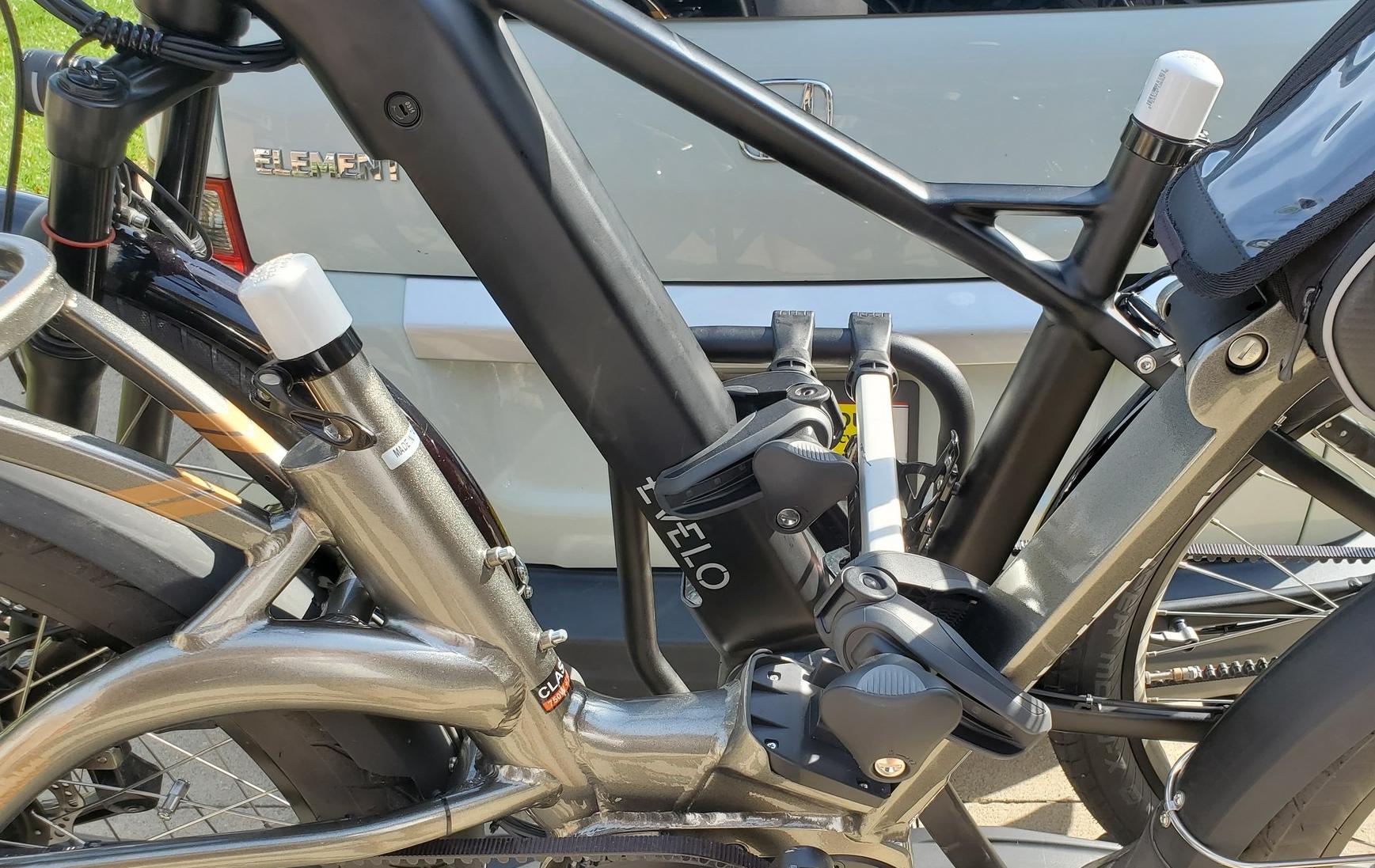

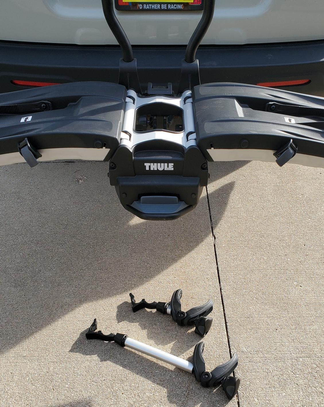

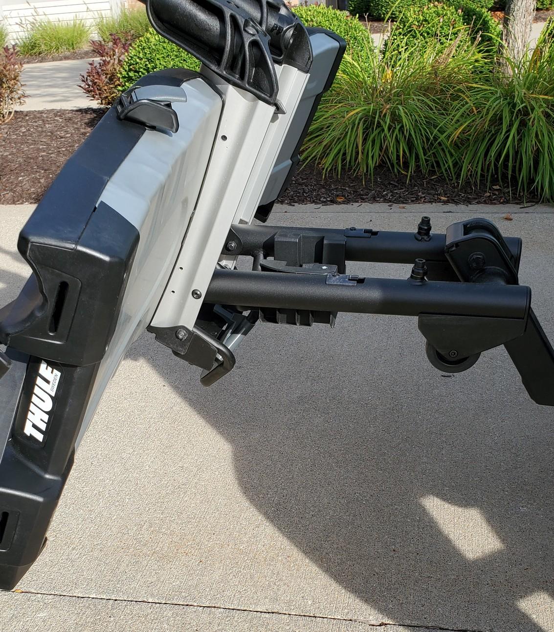

The wife and I had Aurora's but now I've 'traded' for the Atlas. I just mounted both of them on the Thule EasyFold and it went well, but when I put my Atlas in the outer position, the longer clamp arm was angled which 'pulled' the Atlas too close to the Aurora. It could have worked in that orientation but I would need some serious padding between the bikes. When I put my Atlas on the inside position everything looks good. The rack design puts the 2 bikes 9" apart which is pretty tight. Here's the pics:
