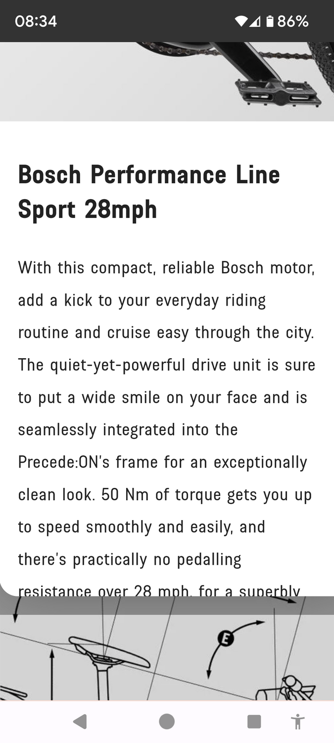

Website says 50nm. 28mph which is correct.
Bosch states that this motor gets "up to" 75 nm. So any value between 0 and 75 nm inclusive is potentially accurate. So the Canyon spec is not fraudulent.
