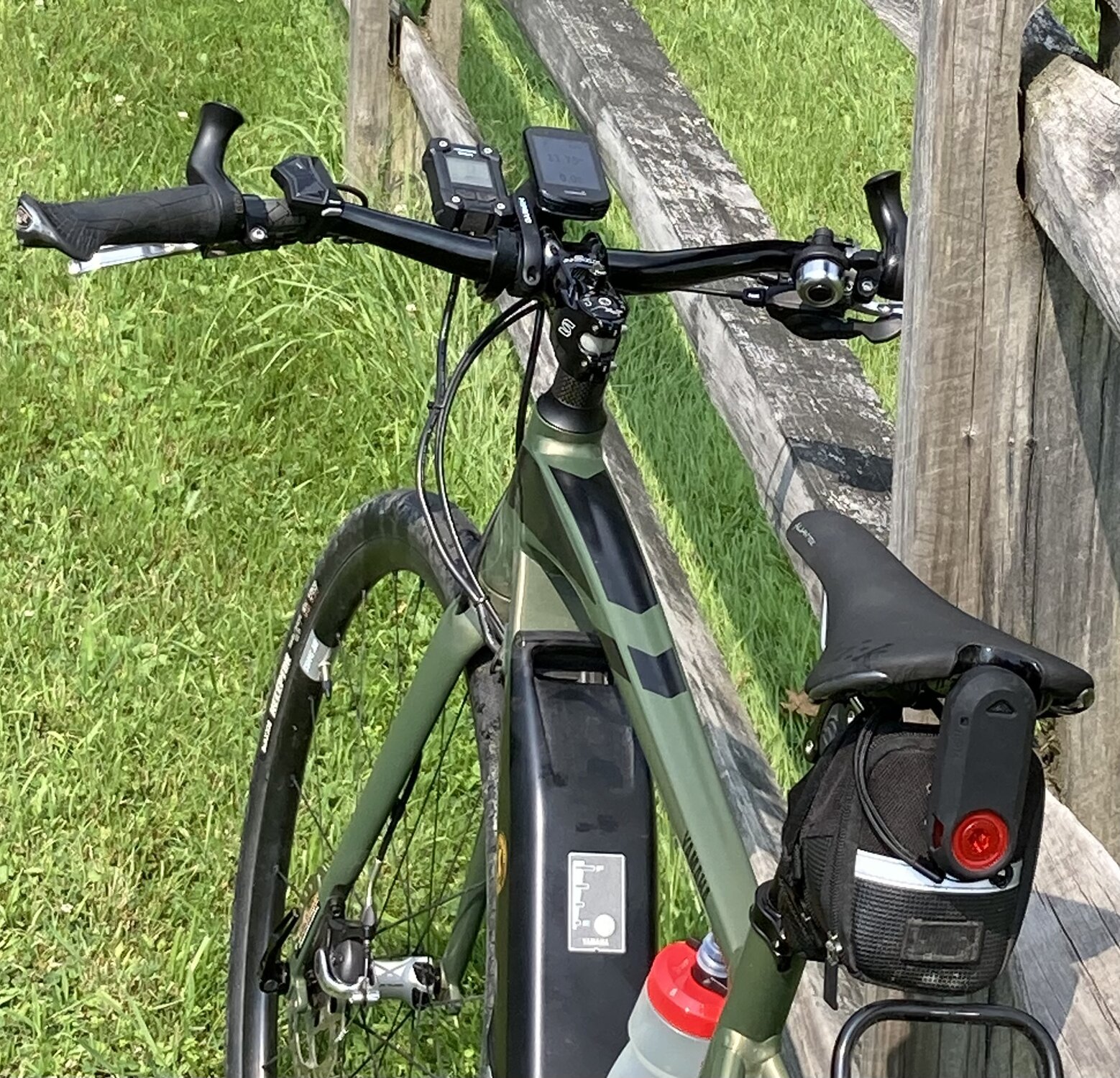

After putting about 2300 miles onto to eeSilk Carbon seat post, I moved it along to my Carbon acoustic gravel bike and replaced it with an alloy eeSilk+.
The Carbon post is and has always been silent. The alloy plus model groans and snaps a bit. I will be taking it apart and adding some PTFE dry lube to the linkage.
Aside from the groaning I do like it. I also replaced my Redshift stem with an eeSilk. I like it quite well, but I wouldn’t call it an upgrade. It is stiffer than the Redshift so I went with the softest insert and never lock it out. It is most effective when I am using the inner bar-ends. I think that it would be great on drop bars, but it is a bit stiff at 80 mm on flat bars.

A little update: I had been happy with my Carbon eeSilk, so I bought an alloy eeSilk+ for my eBike and put the Carbon eeSilk on my gravel bike. After a very short time the eeSilk+ started creaking. It’s clean and I applied some dry lube, but it still creaks and the linkage is sloppy, (it feels like the saddle is loose). I hope that Cane Creek provides more than lip service.
I decided not to put up with it any longer, so I bought a Redshift seat post. I only have one ride on it, but so far it’s great. I set it for performance but it is still more comfortable than the eeSilk+ and it is quiet and smooth. The only negative is the weight, but that’s not such a big issue on an ebike.
