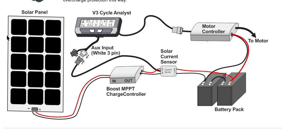

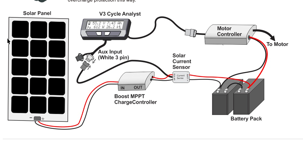

Reliable solar info.
My trike will have this setup. Parts are all here!!
Well the answer is yes and this looks more or less correct. Although I don't know what a Motor controller is.

The diagram that Tomjasz has provided is what you need. Or similar.

It what manages power for our eBikes!
I think it must be an inverter?
I plug whatever electrical item I want to use into the inverter.
So my ebike charge into the inverter then into the ebike battery.
So do you also have a battery charger?
Of course. However the schematic is how my electric vehicle is wired to the solar panel. It is not how I completely charge. I enjoyed reading your post. Living off the grid requires giving up much more than i think i could be happy with. But being old and somewhat infirm would make it difficult without a system out of my budget. I do envy you living in the country side. i admire your lifestyle and would love to live in rural Spain. Regardless of the sacrifices.
