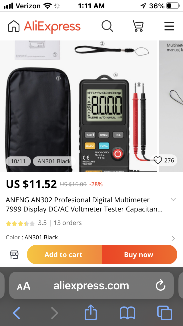

Any recommendation on which multi meter for a person who has never used one Tom? After workability and usability not cost.
i have an expensive Fluke but find a Aneng AN302 to be adequate. Auto ranging and auto off are important features for me. My Fluke uses a 9v battery and the replacement 9v are expensive compared to other battery options .
I buy from AliExpress.
URL unfurl="true"]https://m.aliexpress.com/i/33007502039.html[/URL]
I’m a retired horticulture director and had no electrical experience except with irrigation controllers. I like that this meter is smarter than me. Model numbers are vexing but any of the aneng with auto ranging and auto off will do the job. Cheap coin batteries are another good feature.
