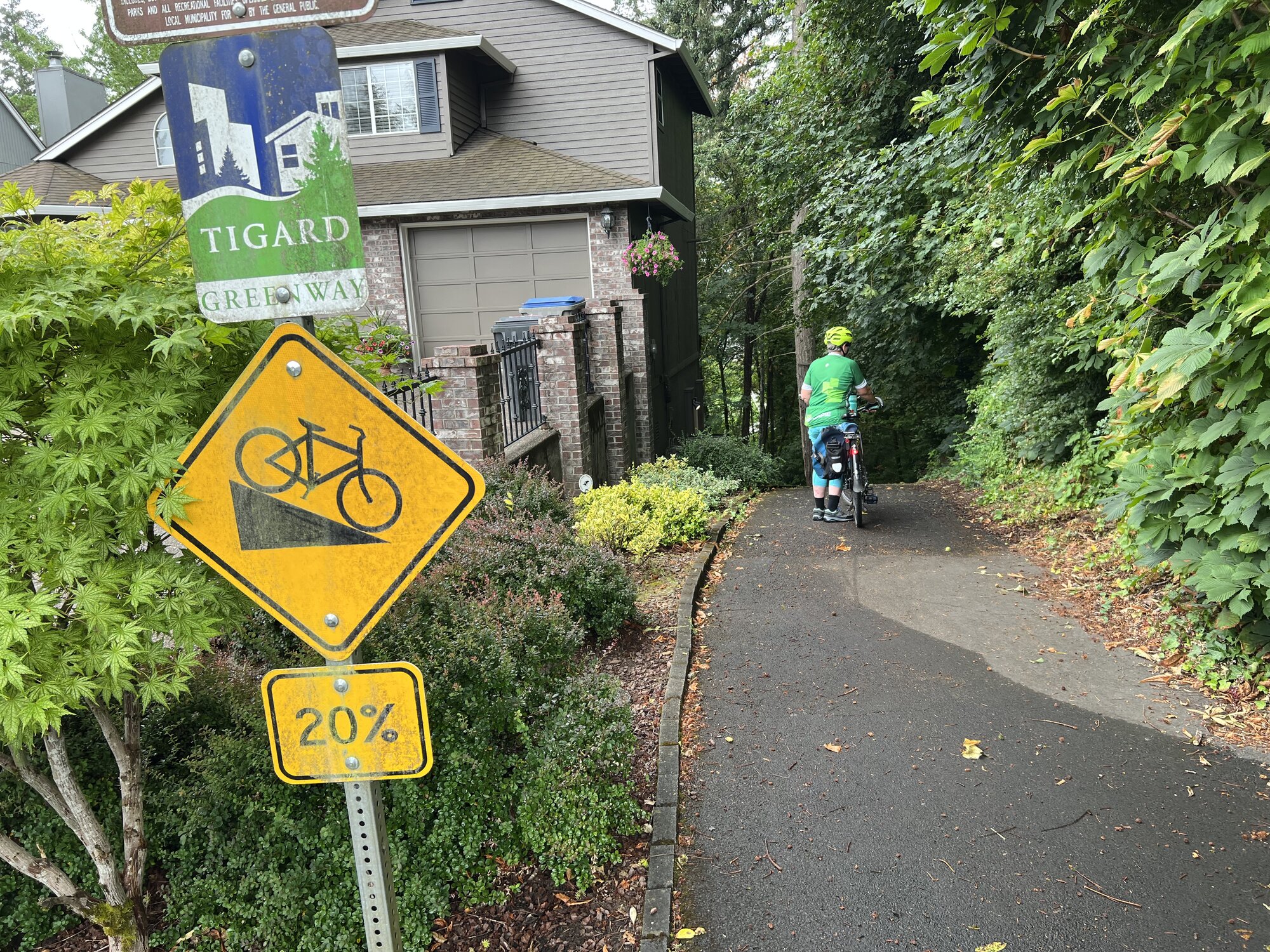

I bet not like this 90 degree turn about 100 feet. We walk this one on the tandem

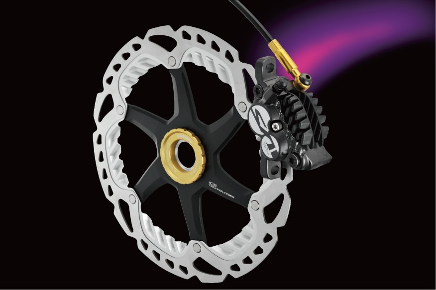

This is a useful -- if gratuitously contentious -- thread. In particular, the advice about rolling slowly to cool off brakes, is very helpful. I poked around a bit since my first post here, and on the eMTB forums, there was a very similar debate, and those folks aren't stupid, either.

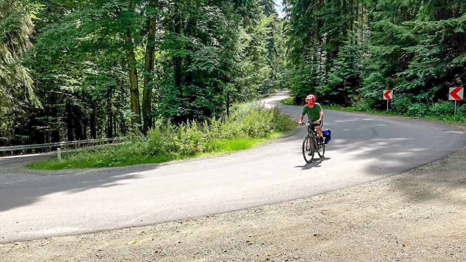

The consensus definitely favored intermittent braking, but with an important caveat for those of us who ride dirt: Sometimes, this is simply not possible. Descending Brand Park Motorway, and intermediate/advanced trail that has many patches of fine, loose, sierra sand, and VERY short stretches of up to 27%, I did notice that the steepest segments were not the problem-- I instinctively dumped speed before I hit them. What was treacherous was the gentler, 10%ish sandy stretches that are somewhat rutted and have modest amounts of rocks that preceded the steep segments, or that happened before other problematic terrain-- sharp or blind curves, deeply rutted trails, or rock gardens.
Instinctively, I gritted my teeth and used continuous braking in these situations, and it seems like there is some broader agreement on this. Your brakes will lock up much sooner on sandy terrain, you have to avoid anything like hard braking or you'll lose traction. The sand builds up under your wheels or something, only very light braking is possible, and intermittent braking won't take off enough speed. (If you're going from a sandy section into an easy section with good traction, it may not be a problem -- you can brake intermittently and let the bike float a bit, that's part of the fun. Same thing if the sandy section is predictable, doesn't have ruts or rocks.)

Hey I didn't stress my wife about it, she brought it up! As we approached the hill, I suggested she use the brakes to keep a speed she is comfortable with. I think she just applied gentle pressure on both brakes to keep at a pace she was comfortable with. It was after the ride that this discussion occurred.
Anyway, seems this little hill ain't much, and the likelihood of us causing brake problems is almost nil. But this has been informative and useful, thank you all. O and @Jason Knight that "tacking" suggestion is great; splashing water on hot rotors to cool them off not so great.
