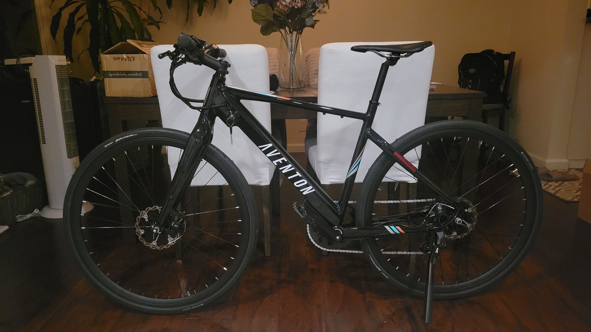

My wife are I are avid cyclists. We have our high-end carbon fiber framed road and mountain bikes with their obligatory high-end components. Almost a year ago, my wife underwent surgery to correct a fairly lingering sciatica pain. Since then, she's been eager to get back in the saddle. But I warned her that our cycling disciplines won't be kind to her 100% recovery that will take beyond a year. So it was decided to get her on an ebike. My criteria was simple . . . decent quality, light weight (for an ebike), looks like a bicycle, and finally a low price (again, for an ebike). The Soltera 7 checked all my boxes. Its price point was much, much less than each of our non-ebikes in our current stable! Luckily, we have a local dealer nearby and after a demo ride, we were sold. So much so that I decided to get one for myself . . . especially dedicated to hauling around around a pet trailer. I've since upgraded some components. My bike received a low rise bar (also, removed all stem stack spacers), a lighter saddle, low profile pedals, Continental urban slick tires, floating brake rotors, and soon to be installed Zoom HB-100 cable operated hydraulic brake calipers. My wife's bike received the low profile pedals, and a 14-34 freewheel to further assist her climbing up our hill to our house. It'll be a while before she can get out of the saddle and power pedal, pounding the cranks. I can't say enough how we're so pleased with our ebike choice from AVENTON!
I'm probably late to the Soltera party but now I'm here. I think most of the pros and cons are very accurate feedback. No doubt range can be extend greatly going to zero PAS on level ground and coasting on declines. I'm amazed at how well this bike scoots along on not so steep declines. This is important because I want to do some short, 3day, mini tours. The battery is light enough to carry a spare. Although I like the stock tires on paved surfaces Ill probably go to a gravel tire, tubeless. If I have any complaints it would be the apps glitchy behavior when trying to record a route. I will probably switch out the twist shifter for an index and perhaps a granny cog. A 25mile jaunt on this bike is effortless compared to my fattie 26er.

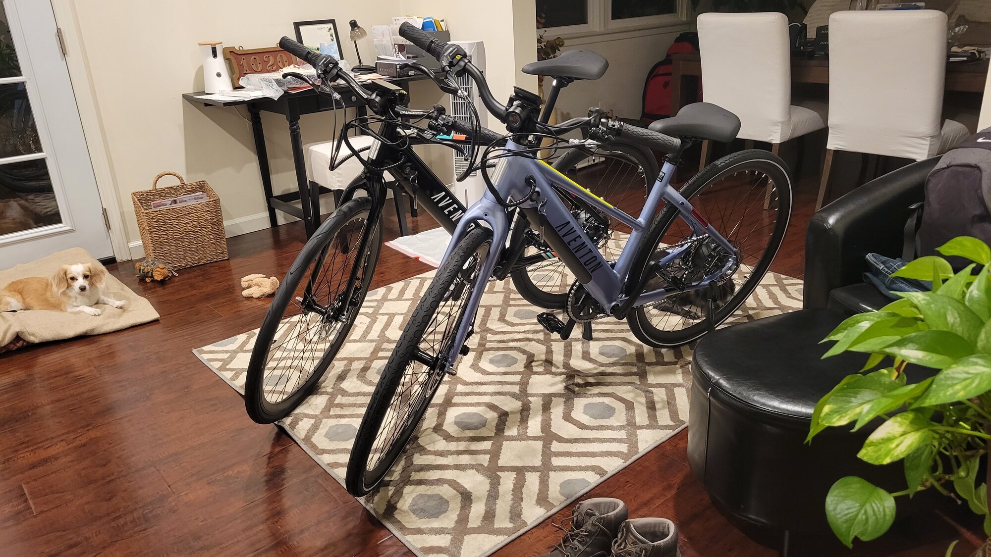

Arrived today and built:
