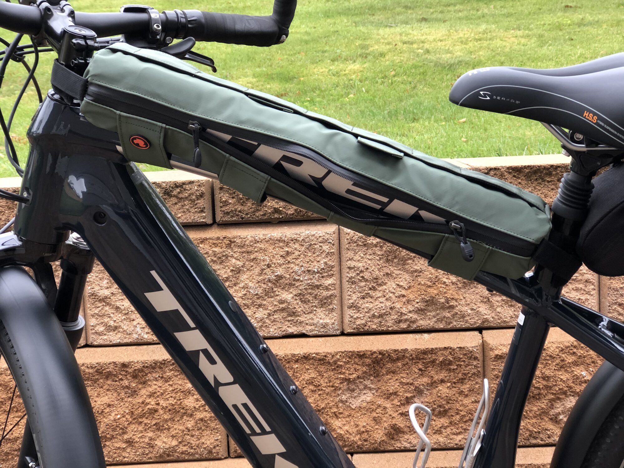

Is it possible to plug my spare Powertube battery I’m carrying like the picture into my Allant+7 and have them both power the bike like Range Boost option?

- In your above photo, what’s the top tube bag’s mfg/model. It’s just what I’d like for containing an spare removable integrated battery rather than a range booster extender to make space for a frame bag.

I really like the bag but honestly haven’t used it much yet as I’m still waiting (after 8 months) for my 625wh spare battery. BTW, I did a little careful surgery on the largest bag (to remove the foam insulation) to allow the RIB battery to fit. Not sure the Domane +HP battery is the same size as my Allant+7 batteries.

BTW Do you remember the mfg name of this top tube bag?

MSH was a total disaster area when I first saw it. I ordered the 625 from my Trek dealer. The Amazon link I sent you has all the info you need.
