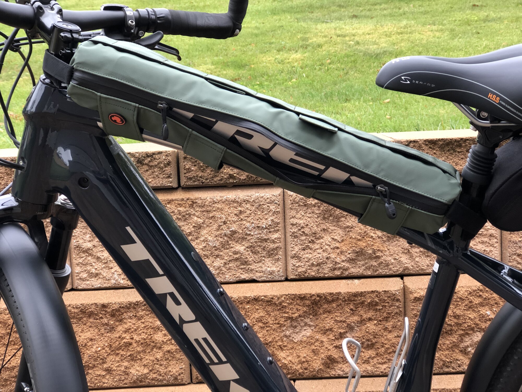

On my Trek Allant 9.9s with a 635 internal battery and the external range boost that hosts a 500 powerpack, both batteries are charged in the same manner.
