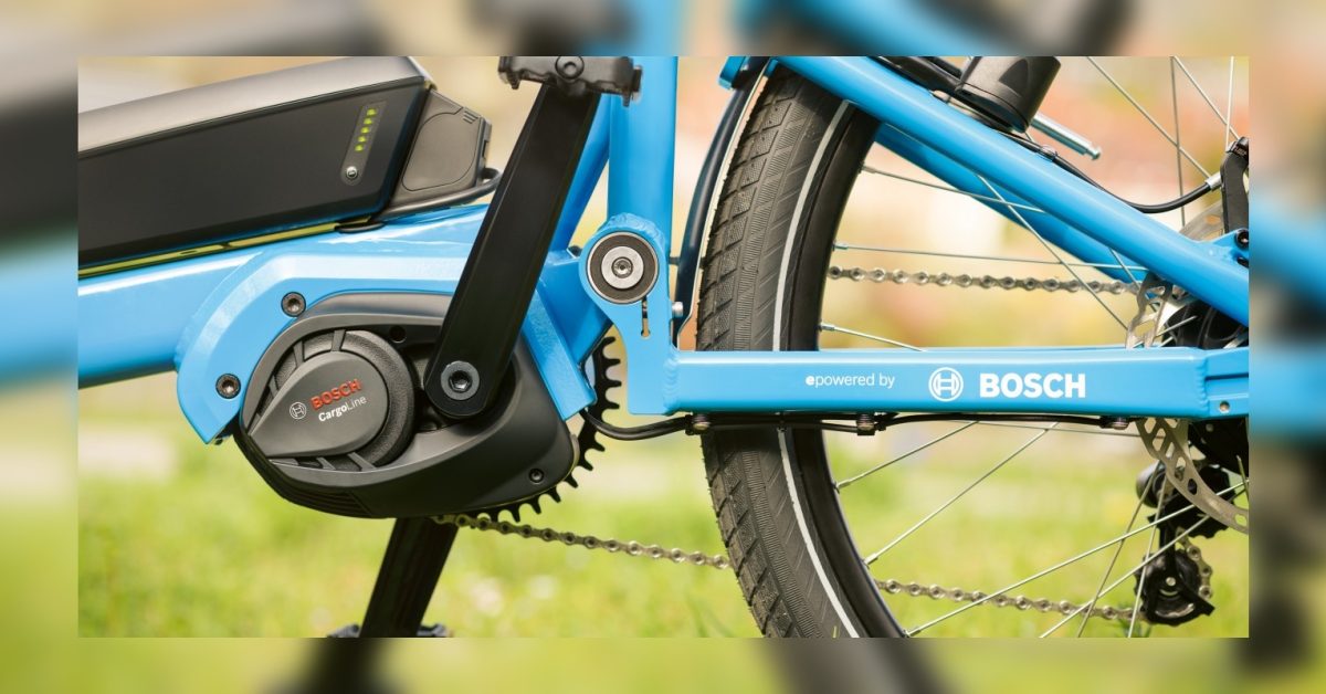

Bosch has released an update to their motor systems. All bikes from Zen will include this update.
Key changes and what does it mean to the end customer?
  1. Increase in torque ratings to 85 Nm while still retaining very compact form factor and very low weight.
  2. Changes to the motor software for example, "Extended Boost" makes it even more intuitive when you need the power. This is extremely useful in technical mountain biking conditions.
