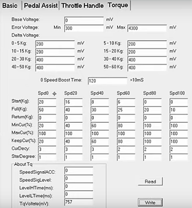

Thanks for posting that. For comparison:
Bafang's stock settings:
eBikeaholic's settings (per youtube video):
Here is another one posted by "Tjeska" on ES (his suggested MTB/Trail settings):
Would be interesting to compare to what Biktrix uses. Such a wide variation out there I'm guessing it really depends on user preference.
