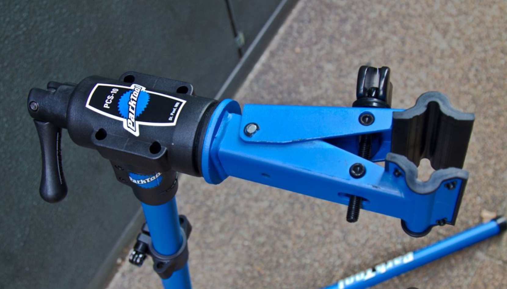

I take the battery off to make the bike a bit lighter, turn the clamp jaws to a horizontal position and clamp it to the frame's top bar.
Yes it does, but if you look at the clamp in the photo you'll see it has thick rubber pads on the inside of the clamp, so the cable is not crushed when the clamp is tightened.

The PCS 10 clamp has a channel for wires and cables so the user can clamp to the top tube.
