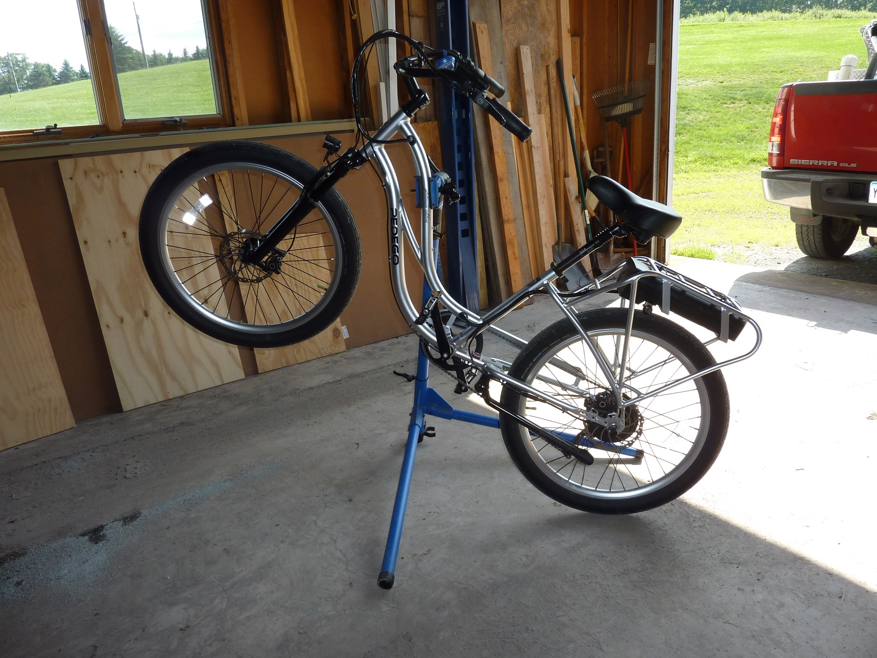

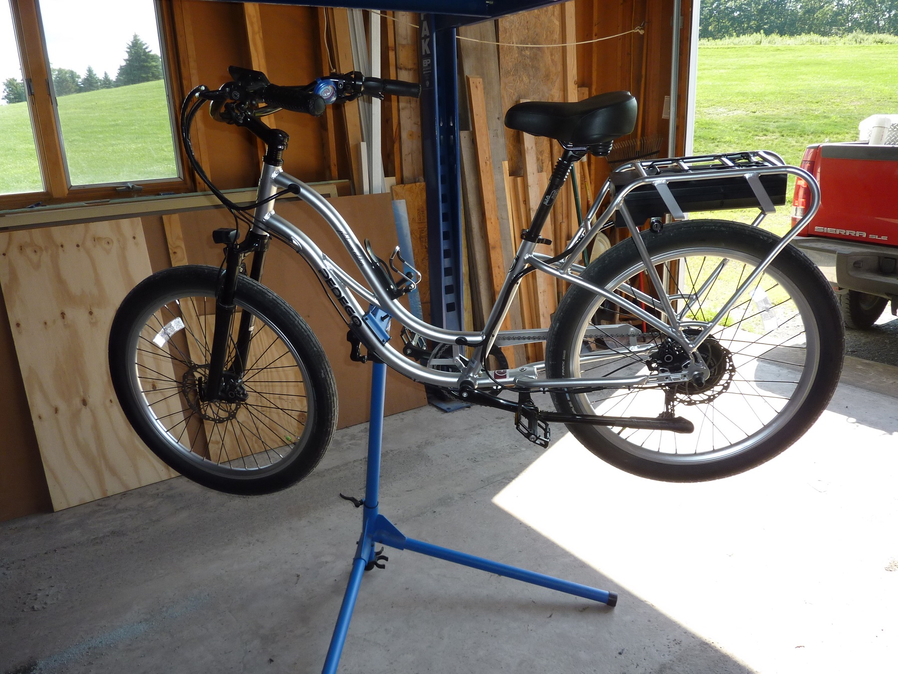

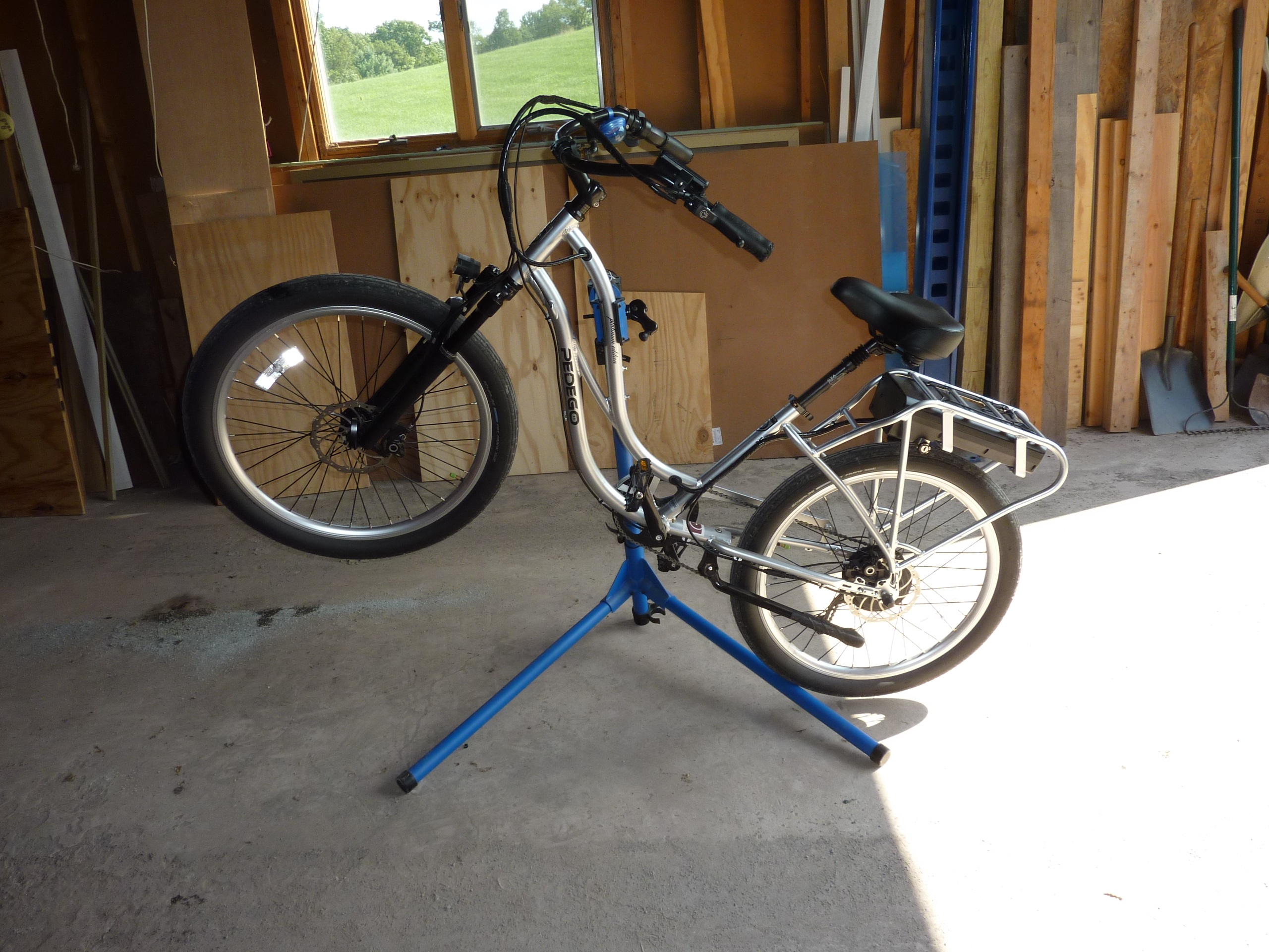

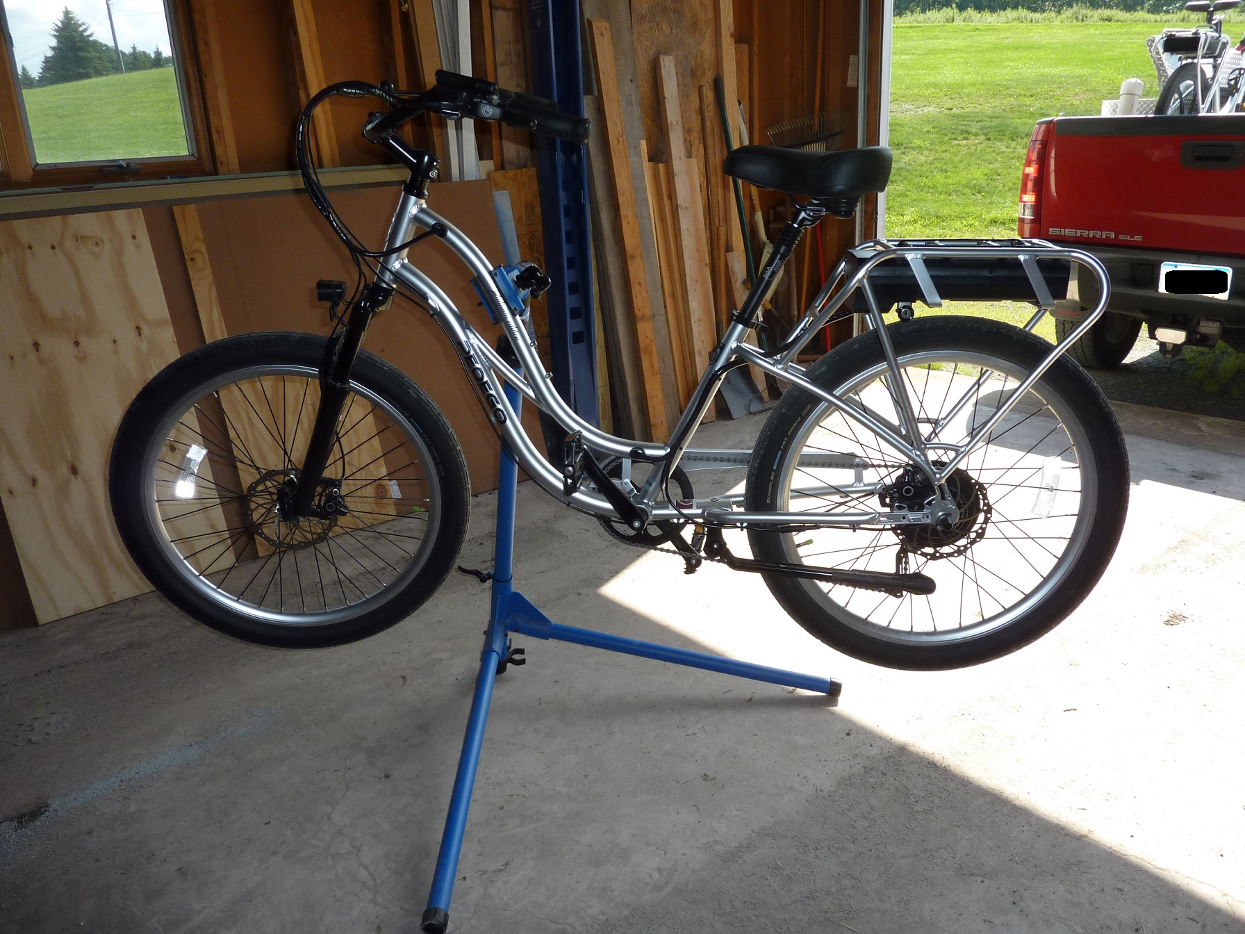

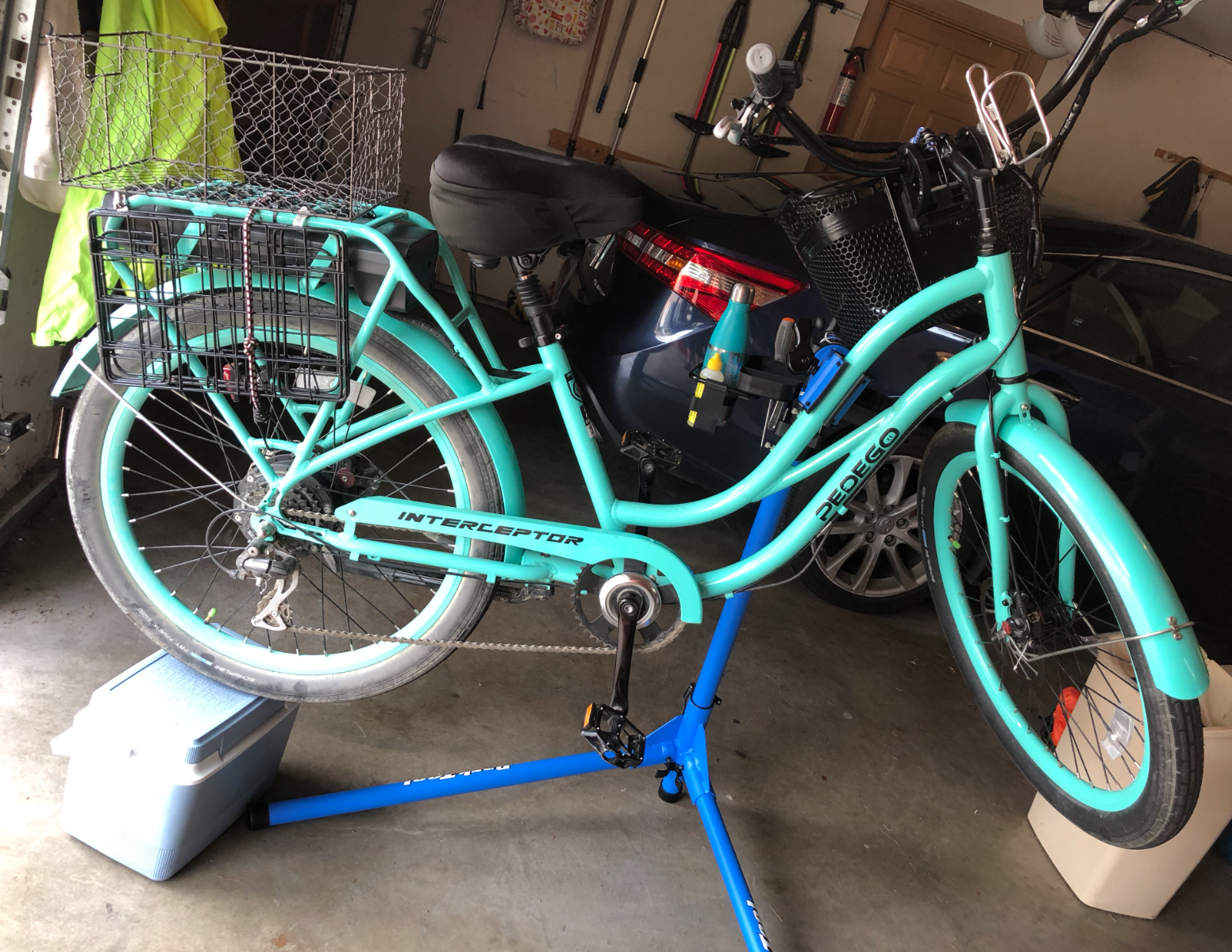

The Pedego Interceptor can be clamped on either of the down tubes:

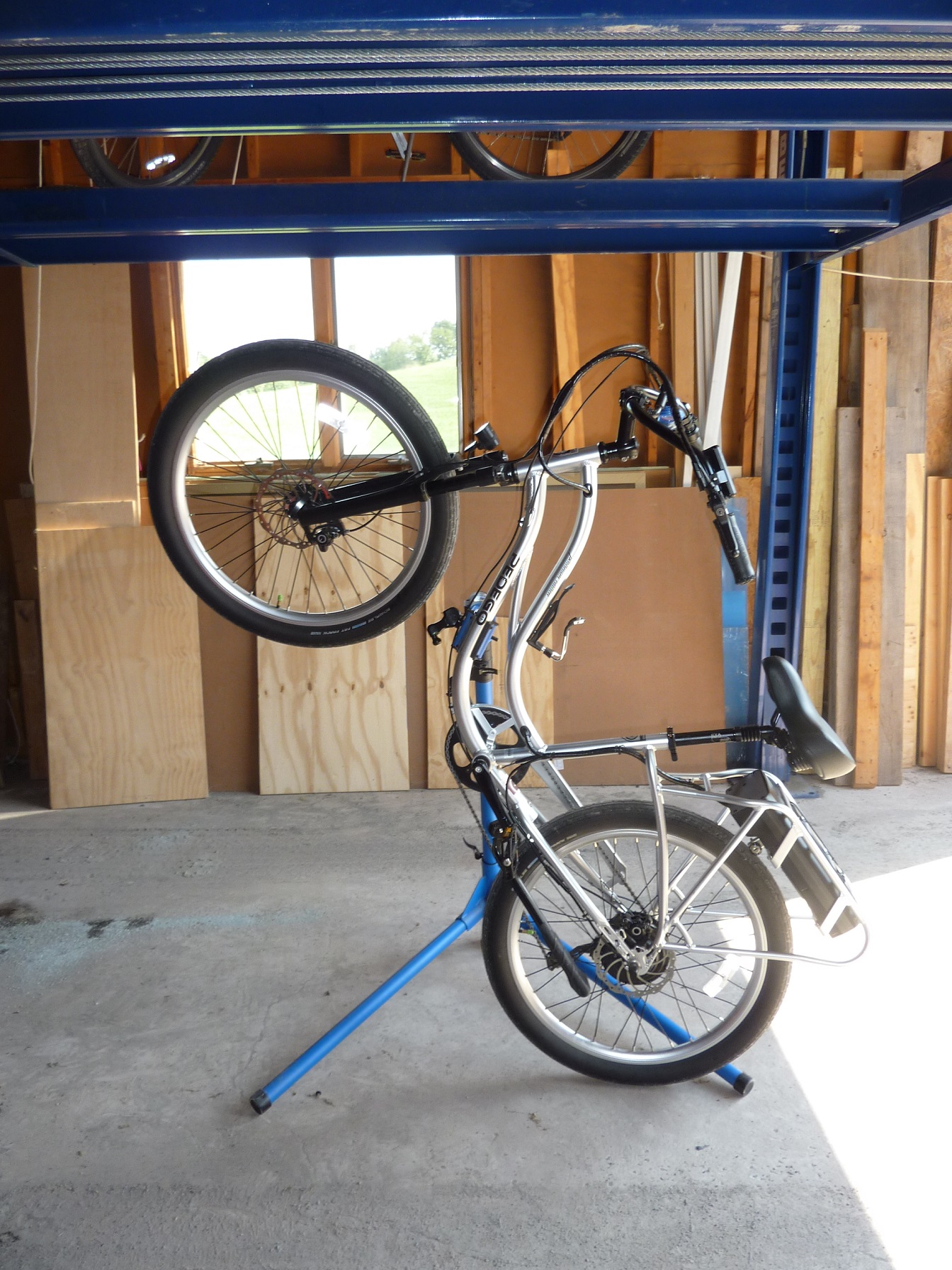

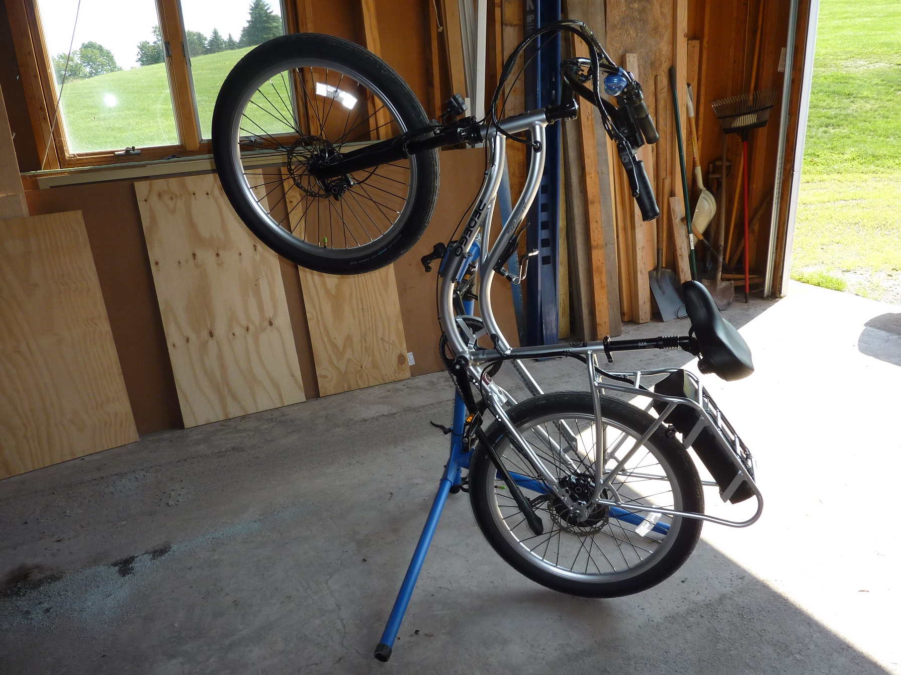

Unfortunately, I couldn't take a shot of the bike flipped upside down. Without thinking, I set up the PCS-10 under my grease rack and there wasn't enough clearance to do so. (pic 1)
It is only necessary to lift about 25 of the 62 lb total weight since most is in the rear.
Of course this will vary depending on the bike configuration.

@6zfshdb , your photos are super helpful, especially since we also have three interceptors at our house. Our bikes all have fenders, so I'm wondering about mounting the bike a bit lower, using your method of lifting the front and clamping, then rotating the clamp. That wouldn't make it possible to rotate the bike to upside-down position, though.

I think if you clamp the Pedego as in pic #1, the rear fender should just clear the floor. You should then be able to rotate the bike counterclockwise to flip it 180 deg. The front fender should clear the floor when you swing it. With no fenders on my interceptor, I can't test it to be sure. Be very careful with the bike flipped over though. The stand is a bit unstable in that position.

You do have to tighten the pivot clamp quite a bit. Try taking the gear off your rear rack and position the clamp a bit closer to the cross tube over the water bottle cage bosses. Also remove the seat & post and straighten the front wheel to put more weight forward.
Sometimes, oil or grease gets in the PCS-10 pivot clamp making it more prone to slipping. You might check that as well.

Yeah that's way off the center of gravity. MUST move more towards the rear.
