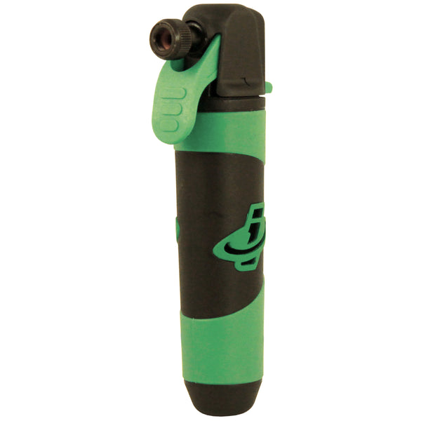

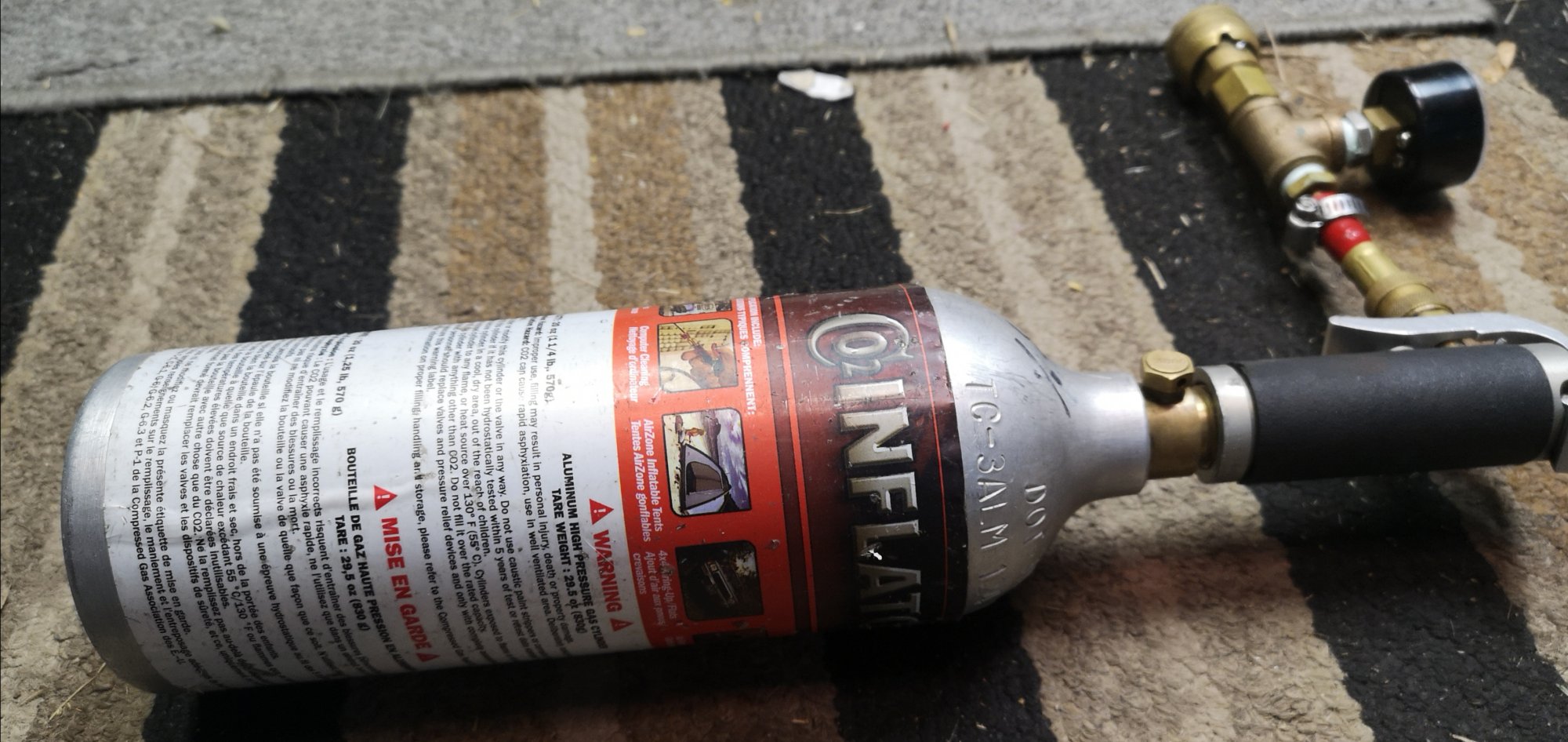

I already have some small CO 2 bottles I carry on my regular bike. I do know the 3” x 20” tires on my new upcoming purchase will require more air than I’m used to putting in. So -if I top off or just use a manual air pump to begin with, what’s lighter to carry/ use ?. what do you guys carry ? I would either have to carry in the rear basket or on a stand alone mount. I’ve seen many of the small rechargeable compressors, I think I’d rather go old scool w/ a type of manual unless I’m convinced otherwise. Can’t say I’ve had any flats while riding on the street. My new adventures will include some dirt trails and amongst the trees/ shrubs/ etc my odds increase to get a flat.
You could also consider a CO2 Inflator with a 9oz or 20oz paintball CO2 cylinder.
A 9oz cylinder can fill 10-29" x 2.5" tires to 35psi. The liquid CO2 at approximately 800psi occupies less than 1% of the equivalent volume of compressed air. So a 9oz CO2 cylinder is equivalent to a 27L compressed air tank. A 9oz cylinder weighs approximately 700g when full, and measures 2" diameter by 10" long. the Inflator attachment adds about 4" to the length and is approx. 1.125" diameter plus the nozzle.
