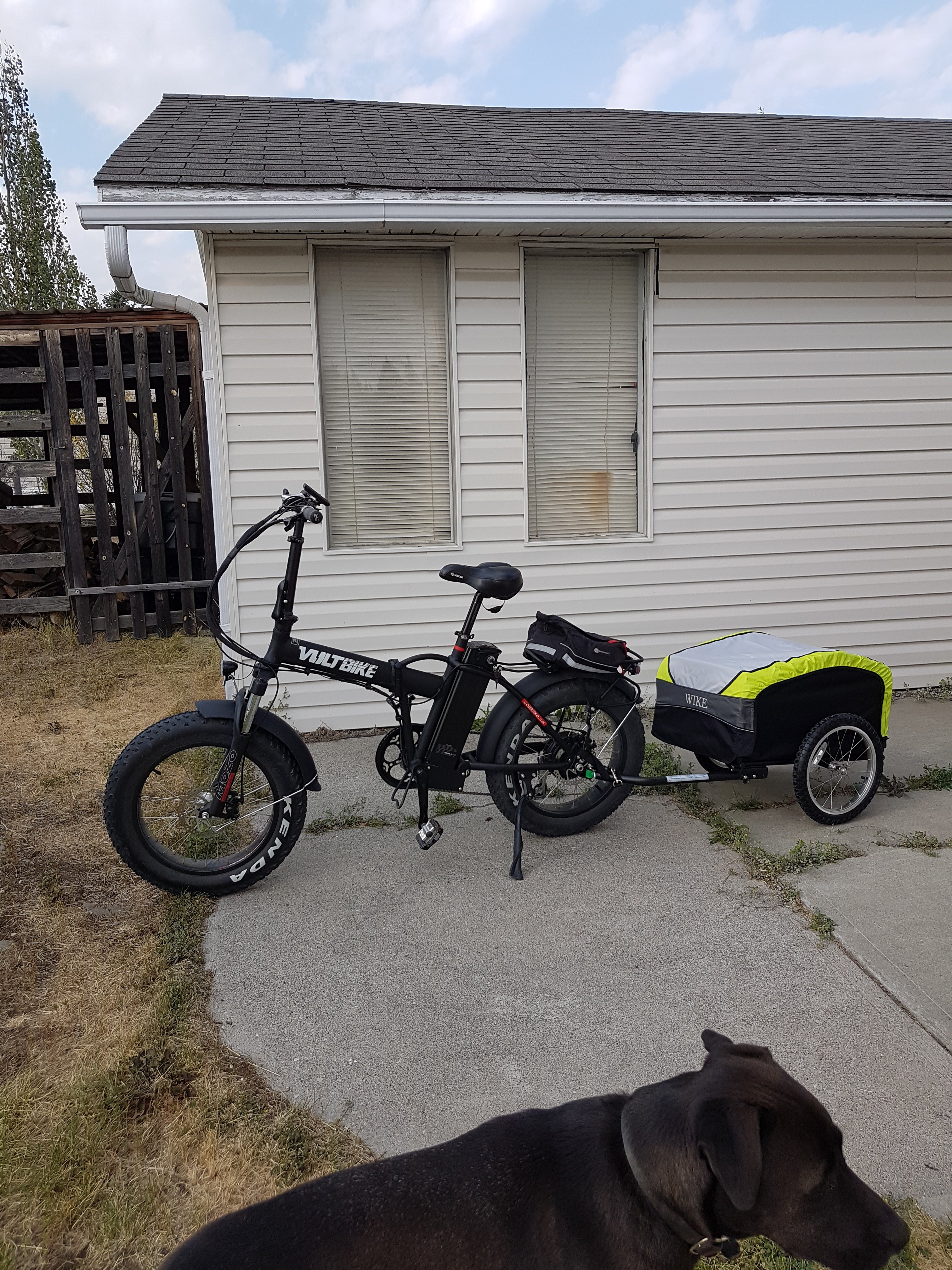

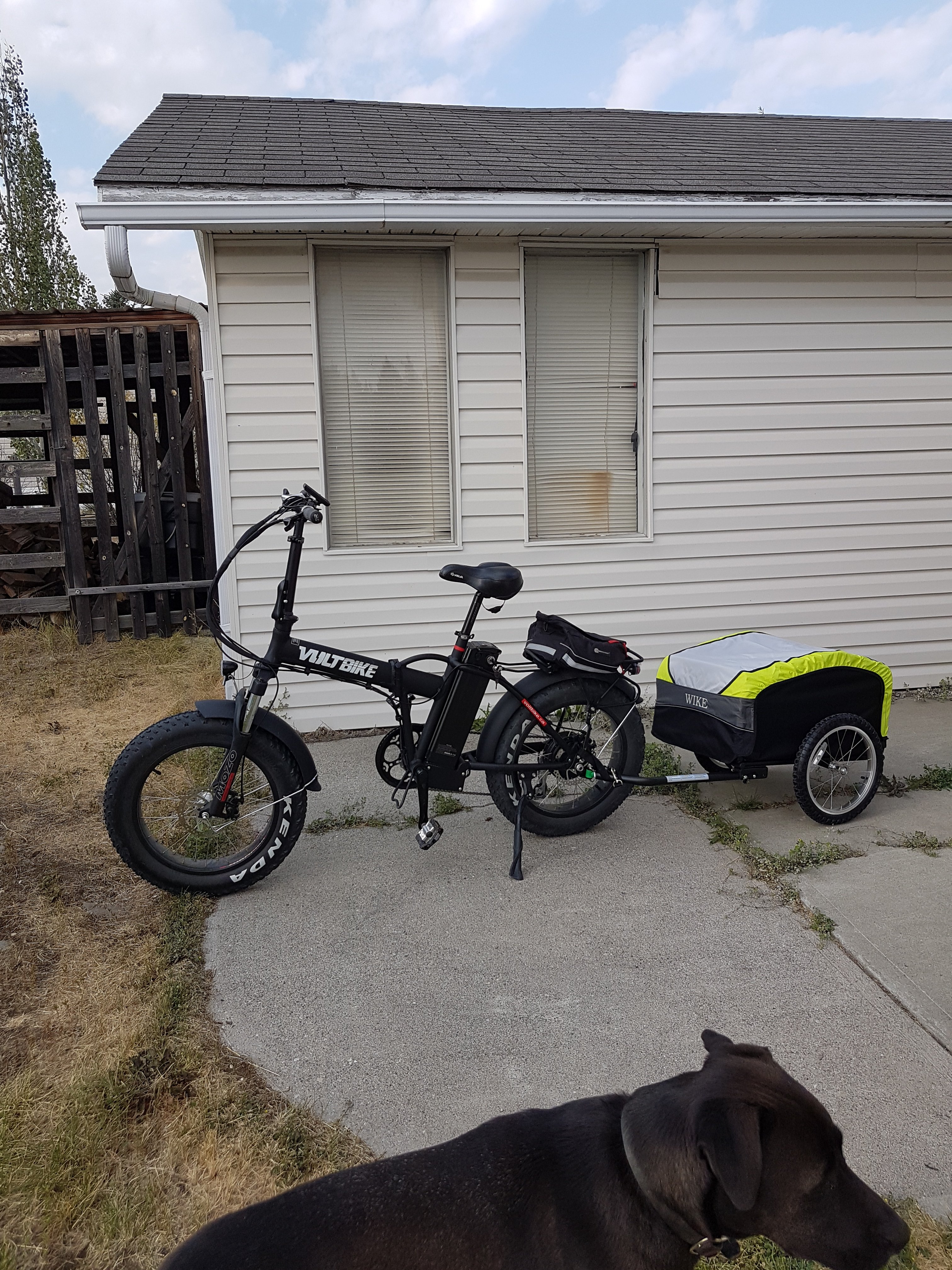

Hello I'm a new member. I ride a Voltbike Mariner and pull a Wike city cargo trailer. I ordered it from the Wike website and so far have been quite pleased with it. When loaded with groceries I do feel a bit of a drag but nothing really substantial. For me using the bike for basic chores just adds another dimension of fun.?

Hello I'm a new member. I ride a Voltbike Mariner and pull a Wike city cargo trailer. I ordered it from the Wike website and so far have been quite pleased with it. When loaded with groceries I do feel a bit of a drag but nothing really substantial. For me using the bike for basic chores just adds another dimension of fun.?View attachment 25627
Your dog looks too big to hop in the trailer, or am I wrong?

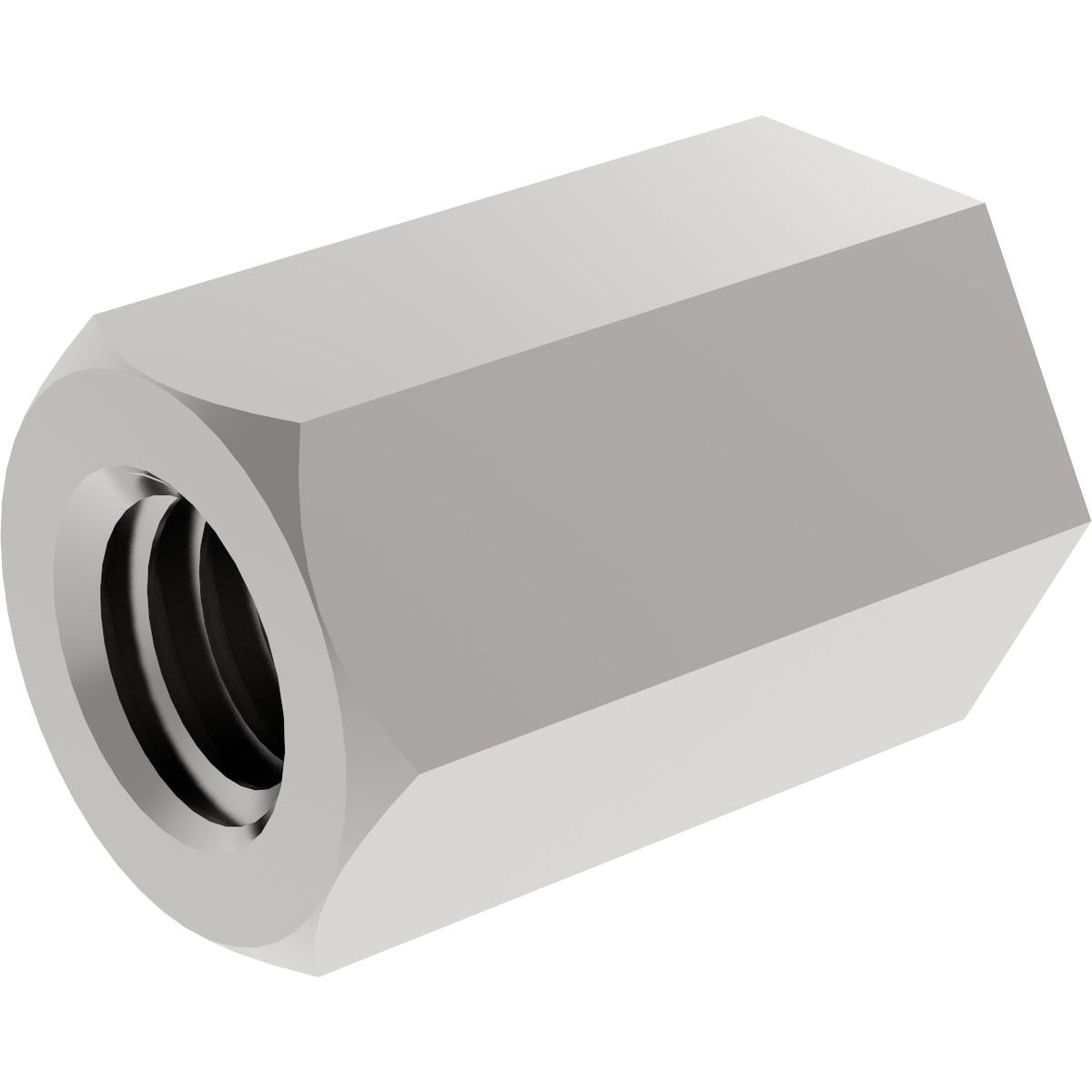

I can think of one way that seems like it might work. Use connecting nuts for your motor axle, they are essentially long barrel type nuts that would extend the threads of the nut beyond the end of the axle. You could then thread in some 12mm bolts of the same thread pitch using a bench grinder to take off the threads down to 10mm only where the trailer attaches. Hopefully that makes sense.
This is what a connecting nut looks like, they come in various lengths.
