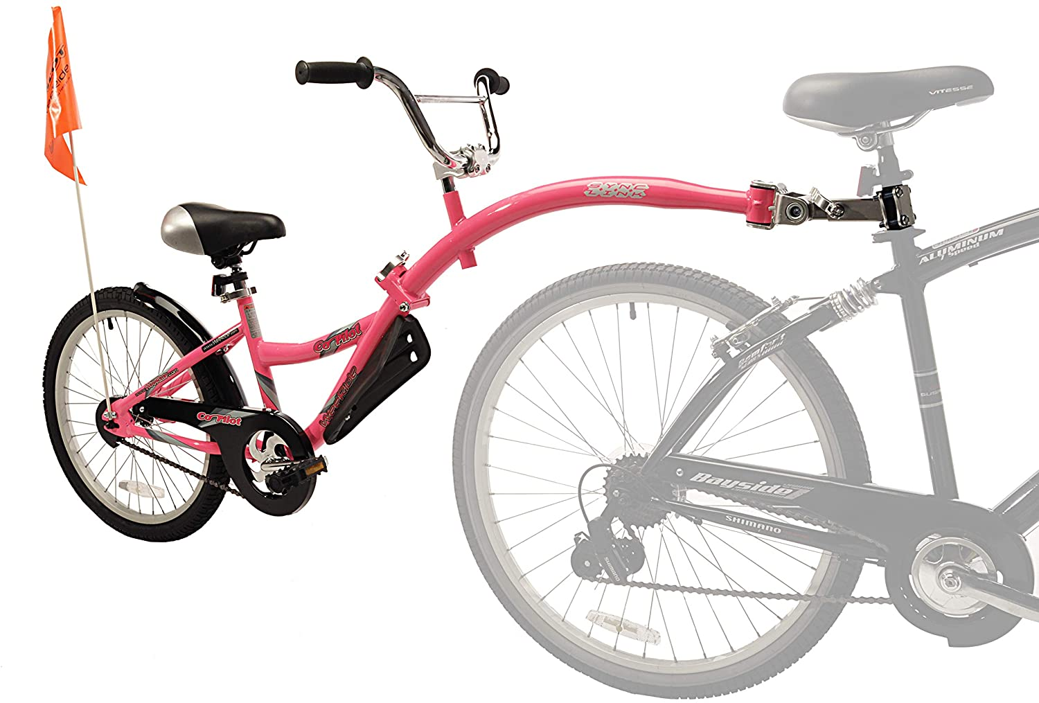

To end up with something like this?
It looks like it would be a lot of trouble trying to work out the details and might not be happy with the results. Unless you are wanting to do a project, I get that.

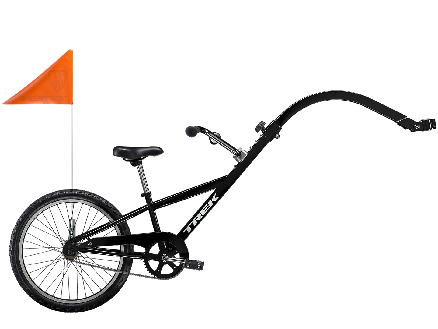

That tag-along bike is what I ended up with. Trek brand. Used.

Cool, do you use it for a child to tag along or just as a trailer?
If just as a trailer you could pull the crank/chain/handlebars/seat to drop a few pounds.
It's for use as a cargo trailer only, so absolutely. I might keep the handlebars on, though, for helping secure the packs. :) I'm also going to install an extra attachment, using a shopping cart wheel.
P.S. I might even install an extra set of handlebars to replace the seat.
The piece which attaches to the bike seat post is something I don't like in the condition I got it in. It moves left and right in a clumsy fashion, which is why I've got the shopping cart casters to add on and make the attachment to seat post non-moving.
One of the worst features is it makes using a suspension seat post difficult or impossible. That needs some more thought on where to attach to.
