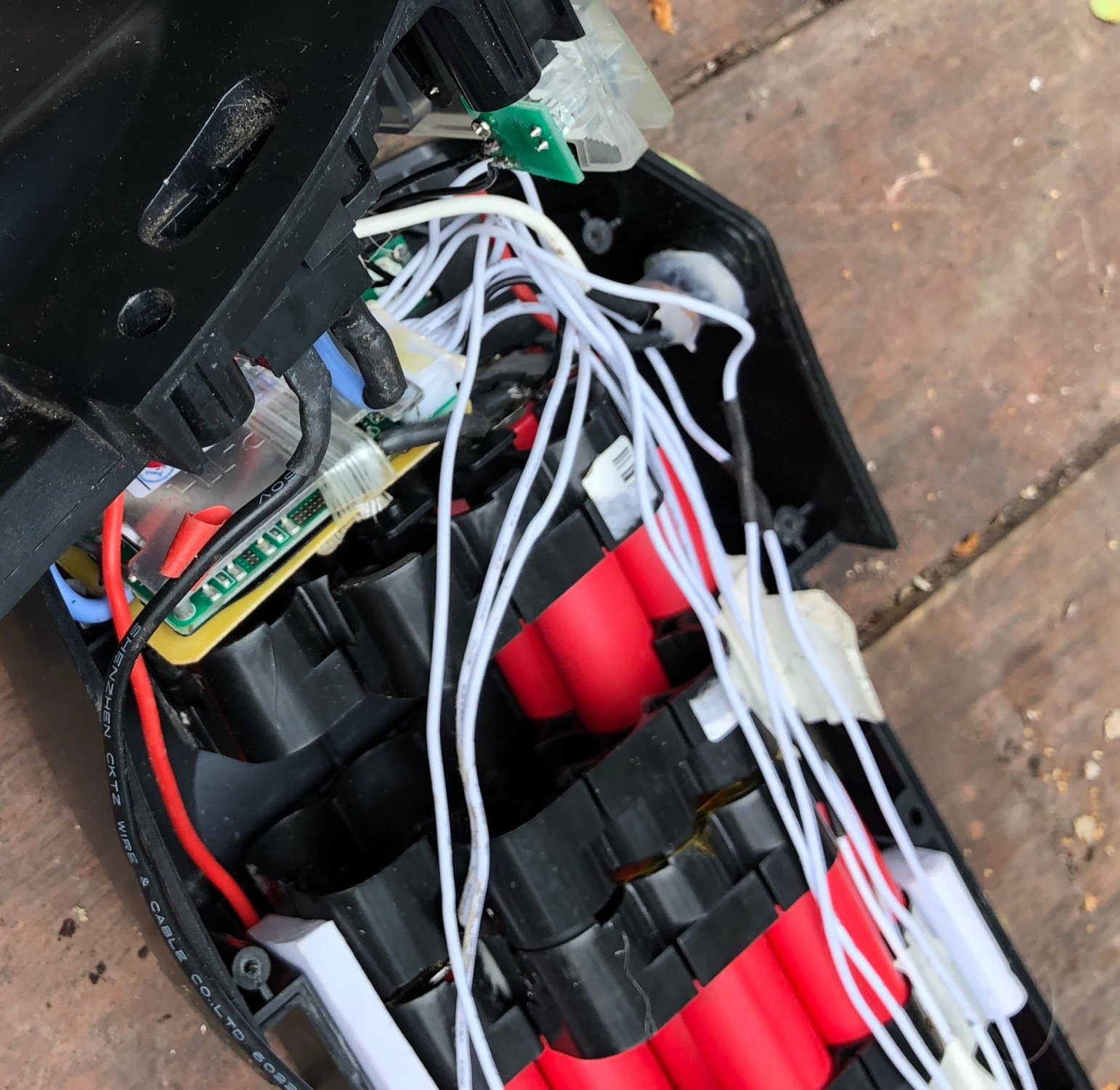

the latest manual [link] [thanks pcebiker] will be helpful although it wont actually say how to turn battery on LOL. the controllers it shows are not like mine, mine is just a PCB resting loosely inside the case, at least i think its a controller, can anyone confirm that pls from the photo above

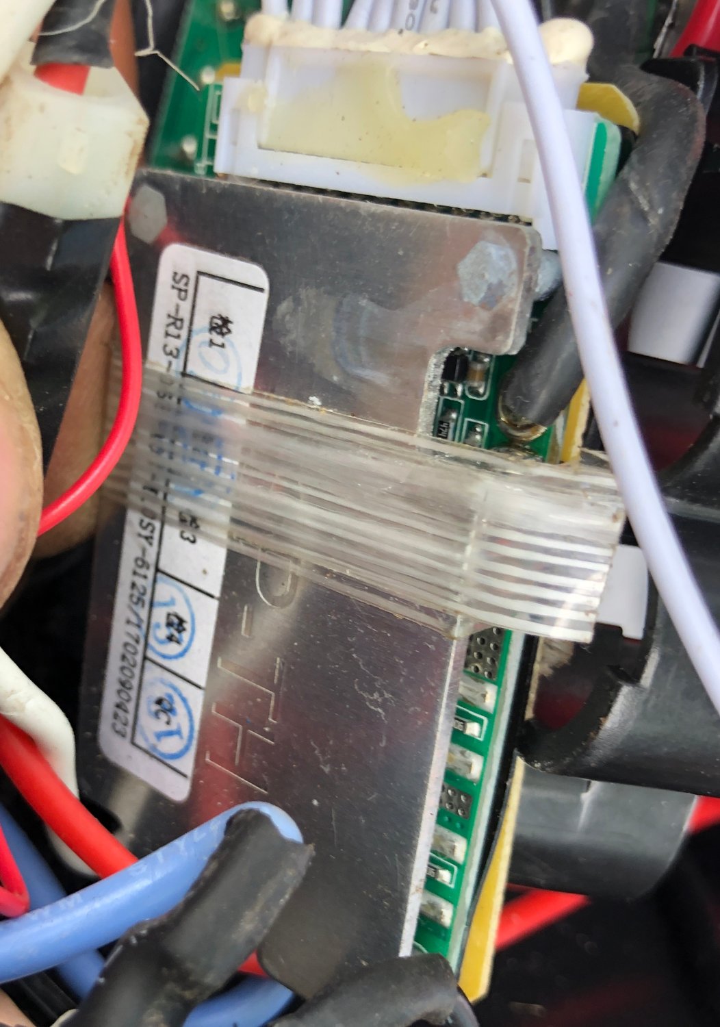

I'm pretty sure that is the BMS (battery management system) circuit board that protects the battery.
Normally, the power goes from the battery, to the controller, then to the motor.
See if you have another "control box" somewhere between the battery and motor.
Your controller is only a 250 Watt controller, so it may be built-in to the battery case?

If you follow any wire such as to the display, it will lead you to the controller. It is the junction box and motherboard. Could be under the battery. Follow another such as from the speed sensor and it is where they meet.

i found the controller its in batt box at back
