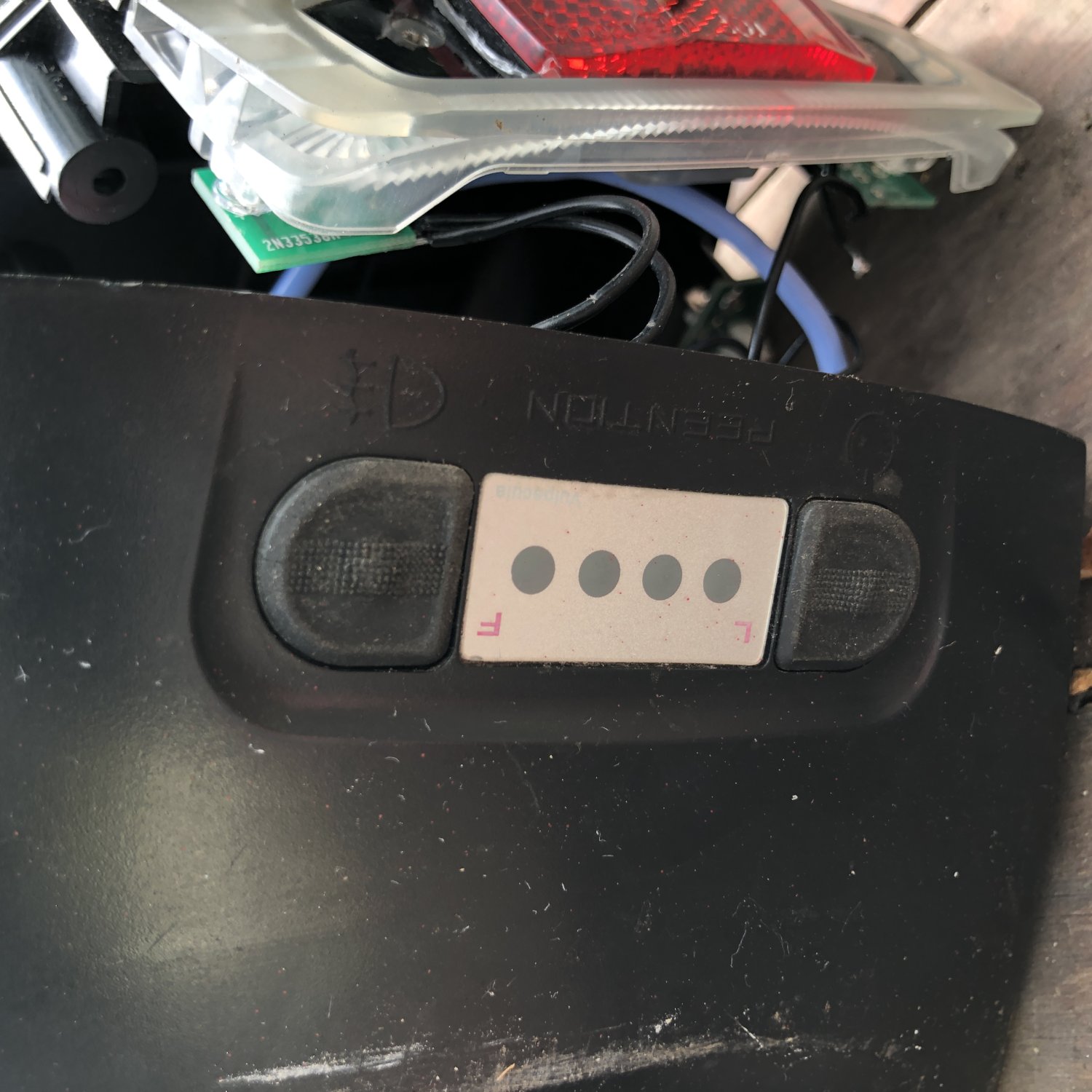

the on/off switch is a mystery, if pressed different things happen depending on whats been done previously in the way of operating it, like turning it on, long press or short press

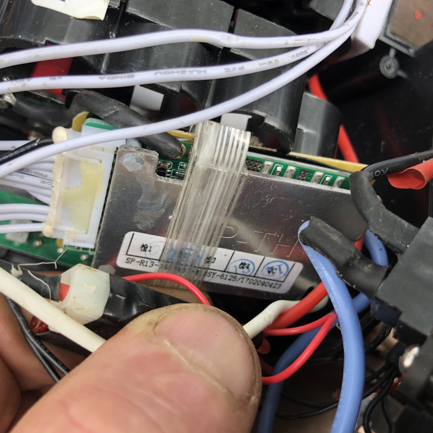

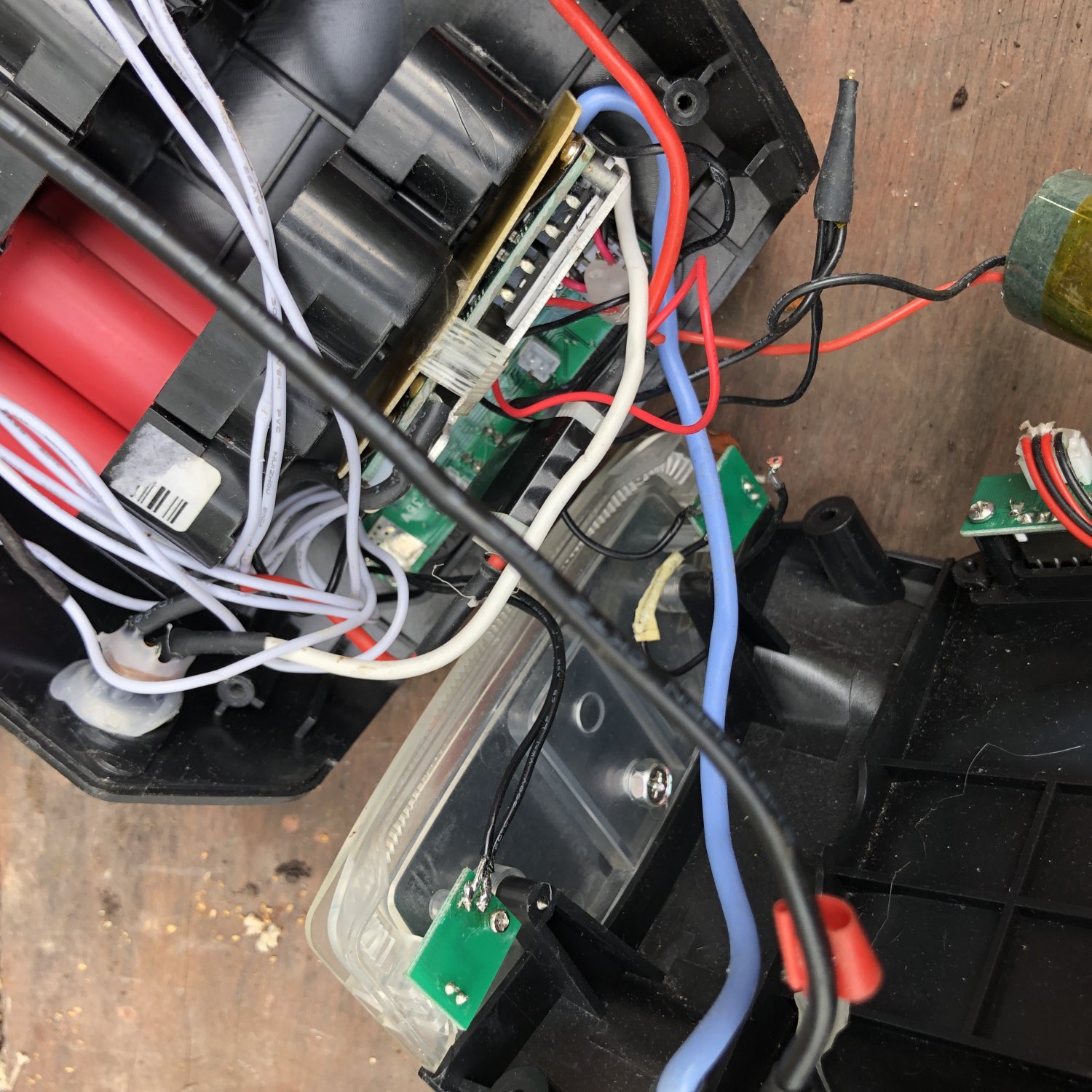

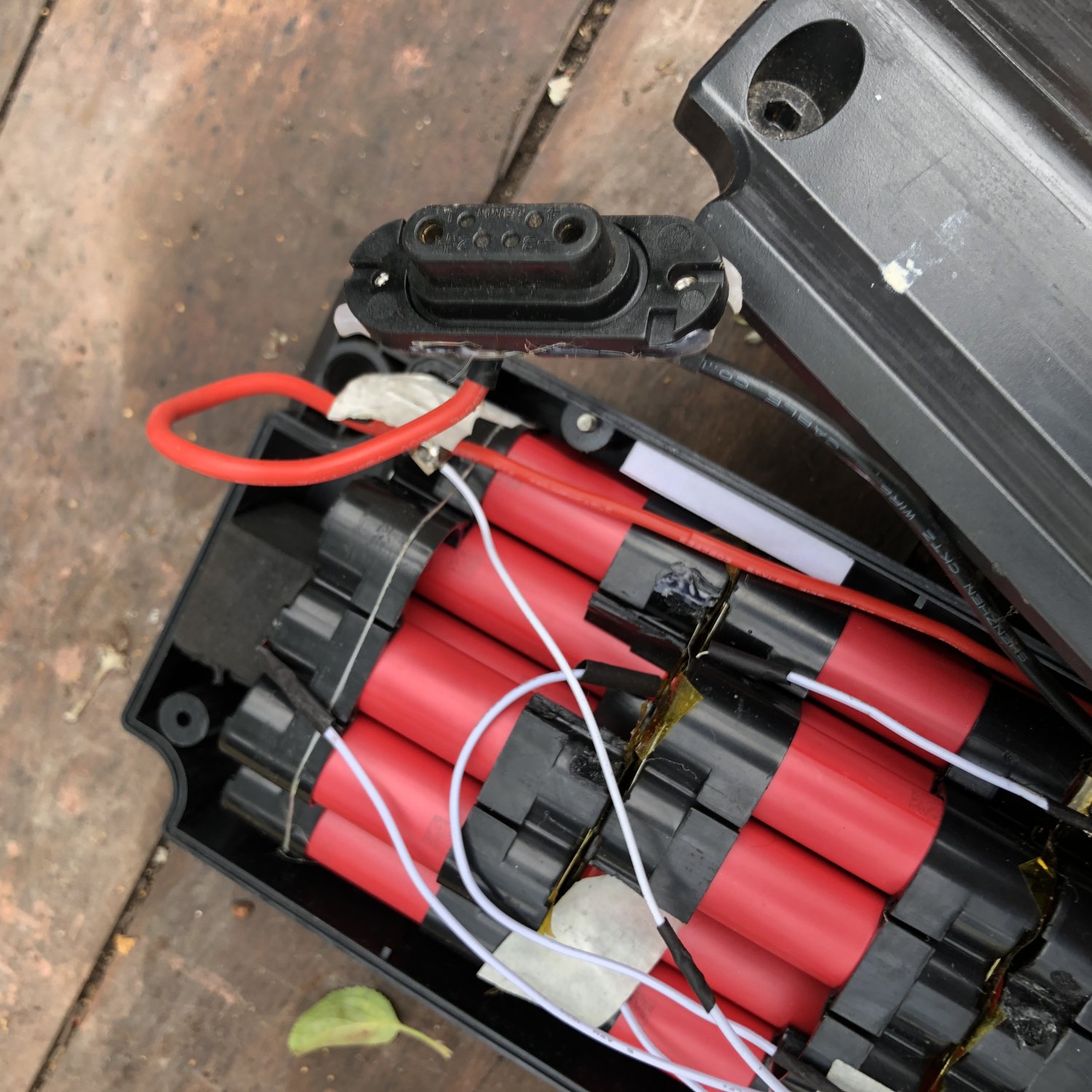

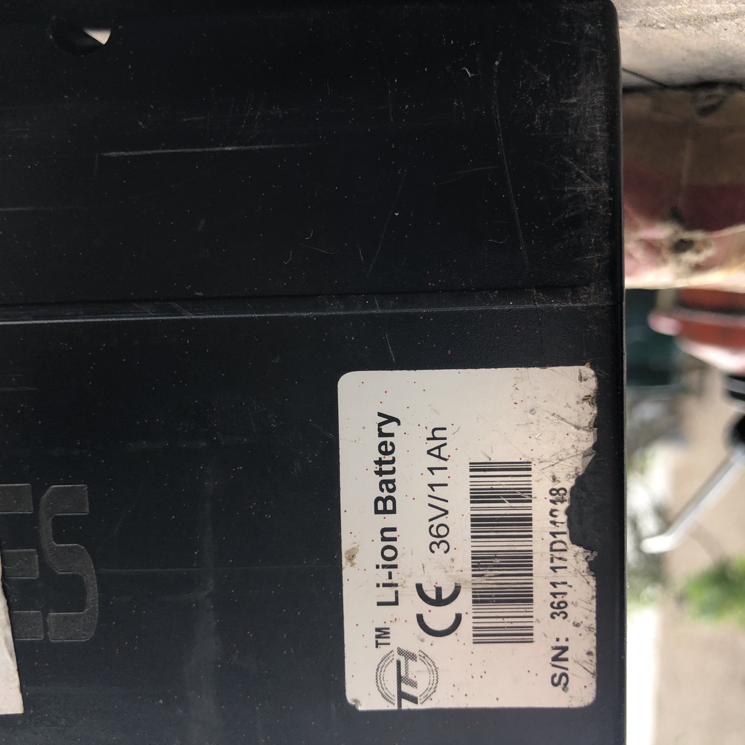

the batt has recently been re built vat great cost, its a tfi li-ion battery in a carrier [for carrying things] with 2 rear lights and 2 switches . i can still measure voltage if required, and disconnect the controller [am not ignoring the advice]

A long press is almost always needed to turn on, markqaz. Hold it down for 5 seconds and then release it. And, yes, the display needs to be awake / alive for your bike to work. It communicates with the bike’s power controller, which has to be enabled for the motor to provide any drive.
You may need to remove the battery just to make sure the battery itself is switched on. That depends on the bike.

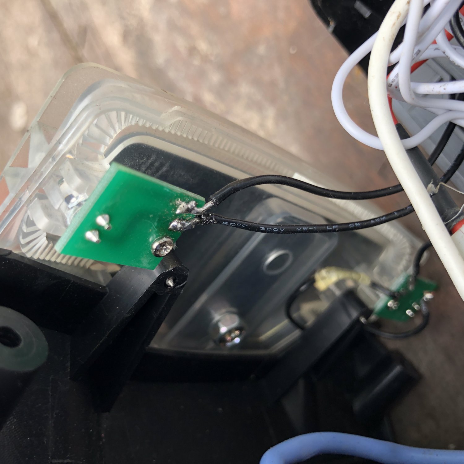

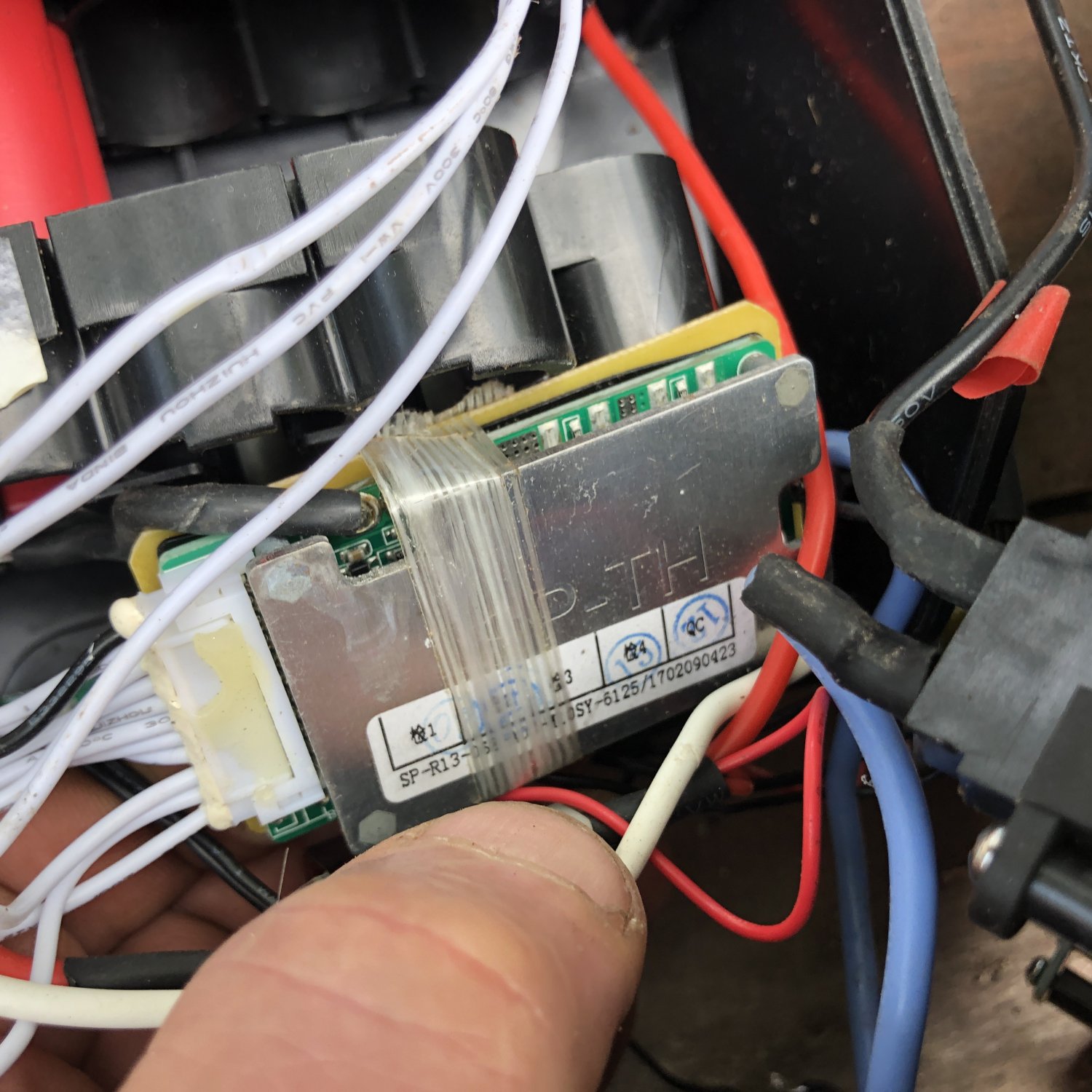

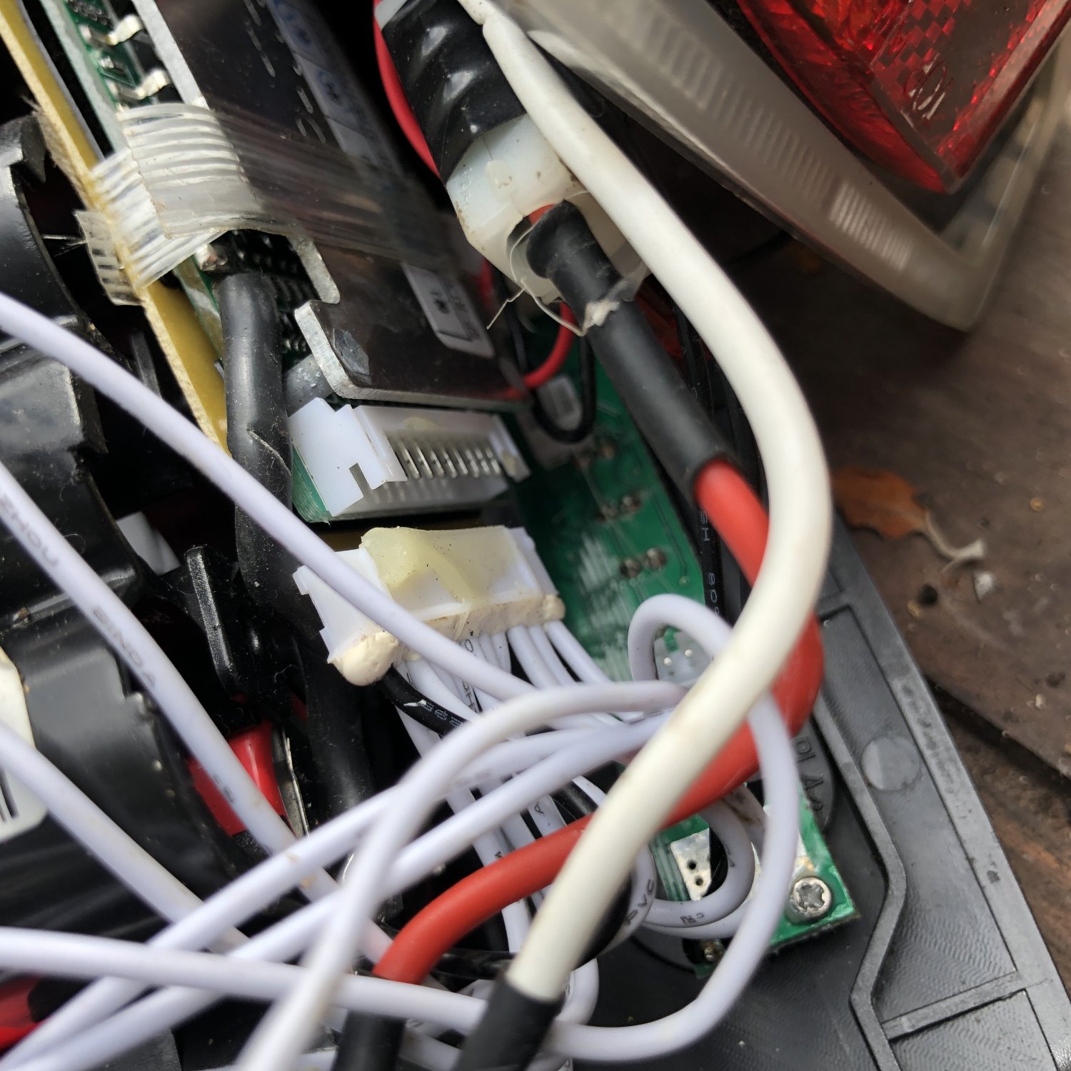

ive disconnected controller now and batt reads zero, if i connect it the reading is 45v. but strangely if i then disconnect controller again and reconnect it the batt reads 4 [four] volts
with controller disconnected i don't get any life by pressing the switch
panda is not trading so i don't think theres a manual available
its a 36v batt
i'll try to attach sum pix in case they can help
thanx
If the battery is indeed on 4 V than it is in deep discharged state.
45V? The max voltage allowed on a 36V battery is 42.0 volts. If the re-celler did it right, it can't go higher, Voltmeters do read too high when their internal battery is weak, Replace it. Probably a 9 volt, Then check your 36V charger. That will be 42 volts with nothing connected.
Ebike batteries have isolation circuits that switches them off if the cells inside drop too low. When you see 4 volts, that's just charge leaking onto the pins, You can't see the actual voltage on the cells. All you know is that they are too low,
Suggest you get the voltmeter sorted out so it reads right, It's reading too high now, maybe your new battery needs to be charged some more,
when finished charging the green light is on, do u mean maybe i should leave for longer?
is this mater of inaccurate meter just academic or do we need a correct reading.? i measured a 1.5v batt with it which read correctly
haven't replaced the meters batt yet but did measure the output of the charger with nothing connected and its 46.5v. will get new batt in morning
