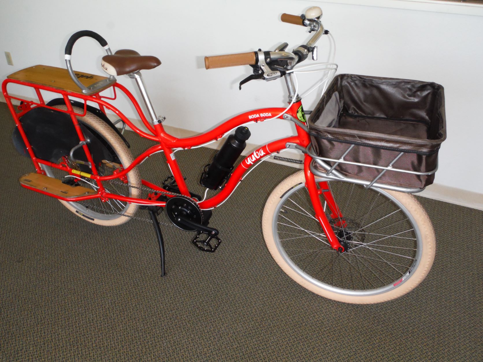

Not sure it is available in your market, but look at blix packa . Other stretch frame cargo bikes, xtracycle, yubabike (mine shown left) pedego stretch, m2s, magnum, giant momentum, euronau. Expensive Reiss & mueller. Tiny wheel cargo bikes for the toothless, tern.

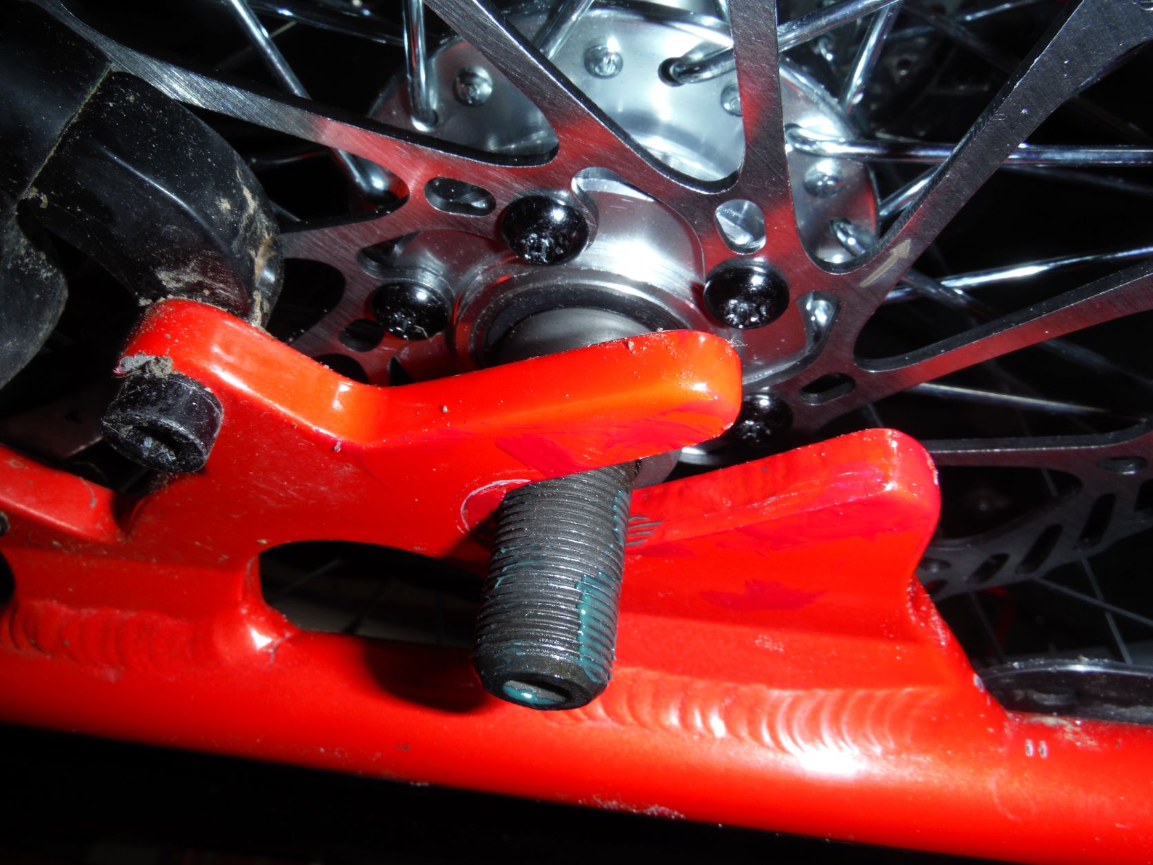

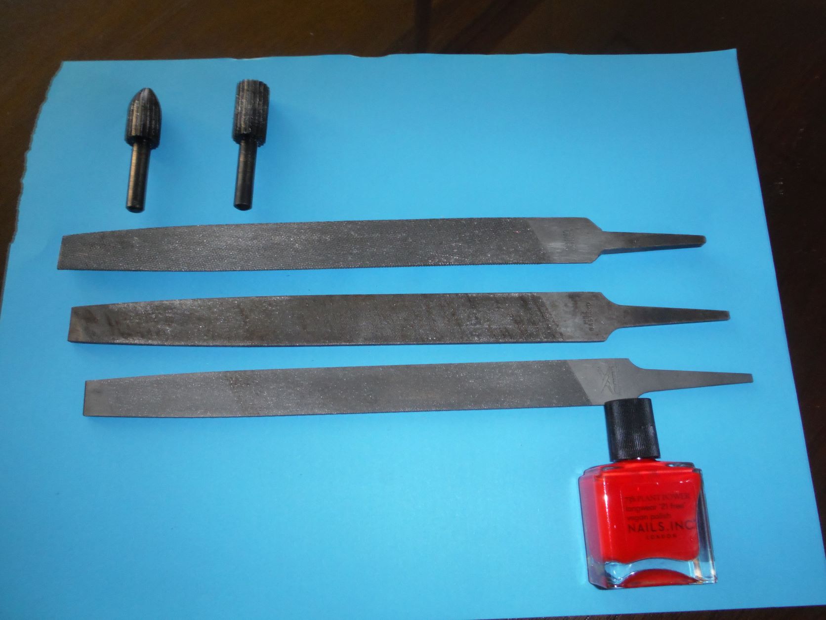

@m@Robertson, I love this quote, "Lets call this a Mission Statement: DIY Does Not Have To Mean Half-Assed." I have a Mundo with a dead BionX that I got for $400 including a spanking new regular Mundo rear wheel for it. When the project is completed it will be worth a good $2250 to someone.
Check this out: I milled 10mm Boda dropouts to fit an extra-strong Mundo rear wheel with a 14mm axle. Now you know how. If I only had half-an-ass to spare?
