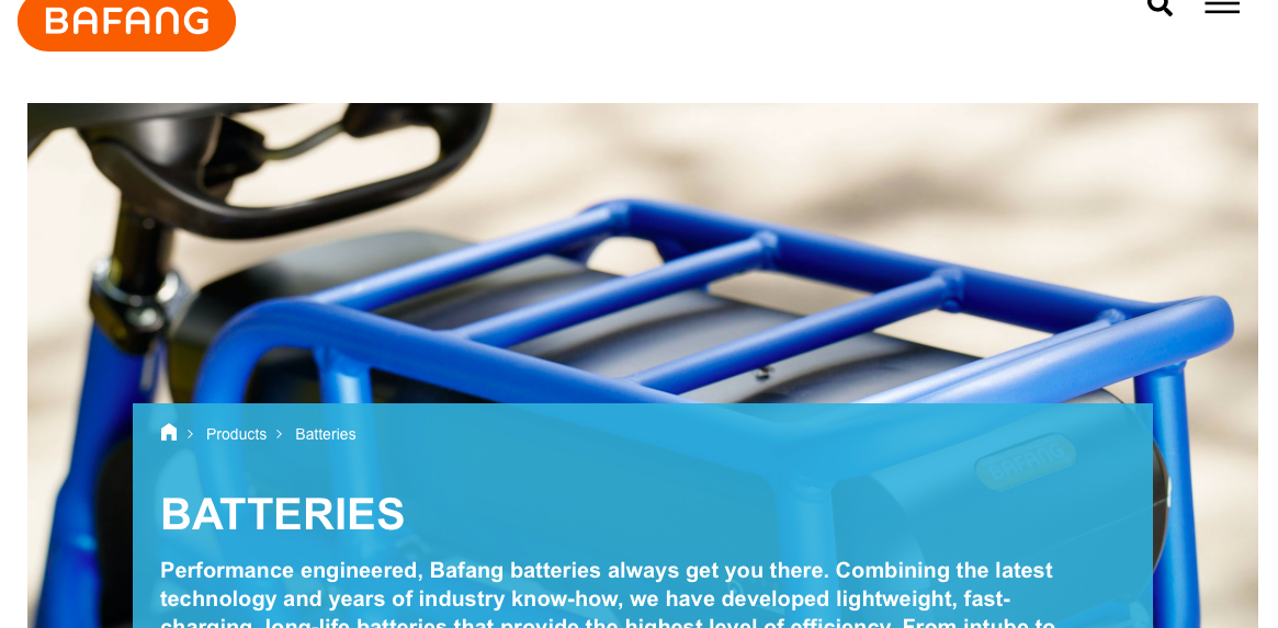

As Asher said ecosystem is everything. And batteries are a key part of that. Bafang not making or selling batteries is a hurdle.

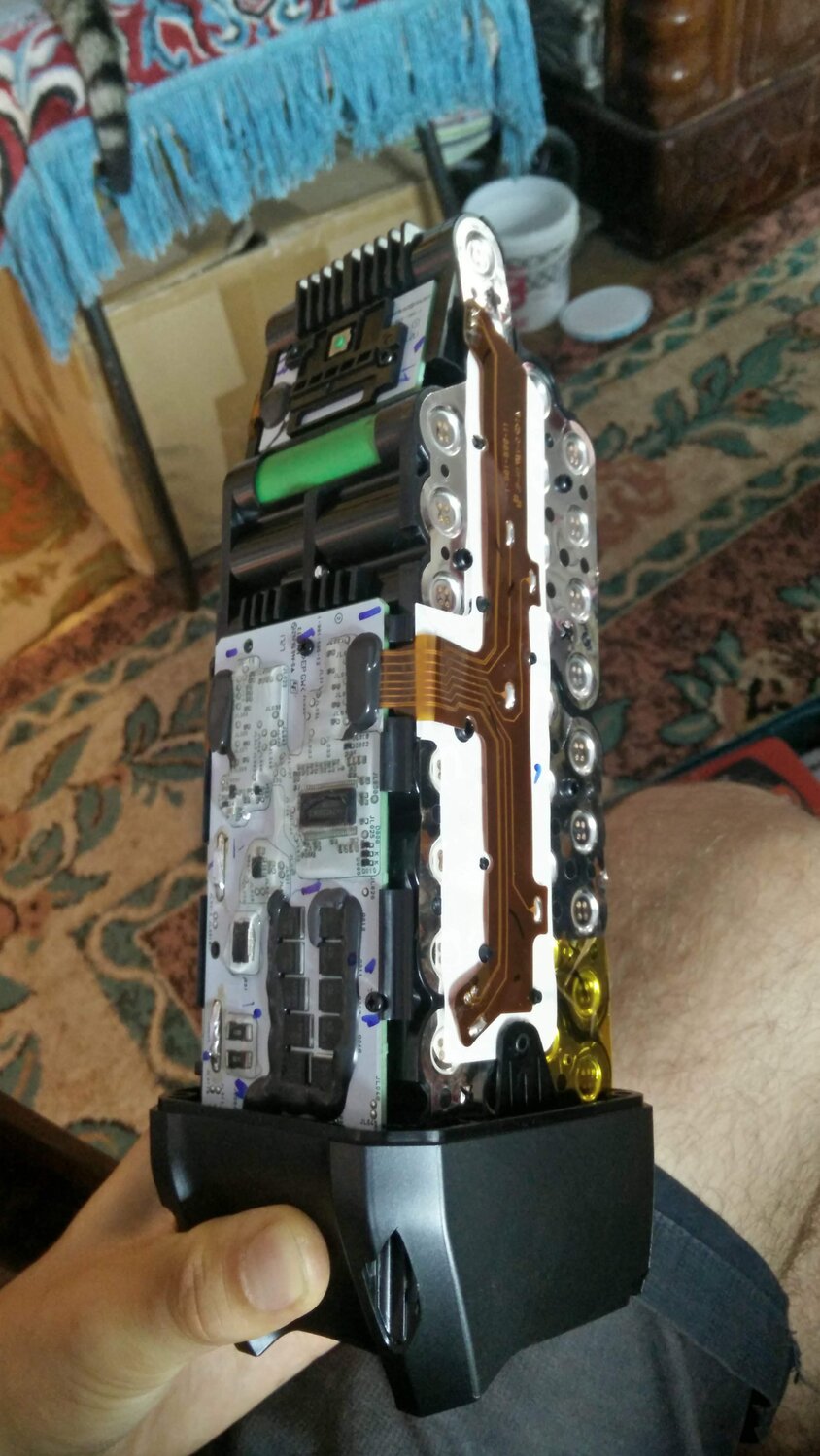

Don't assume all the vendors you listed have high standards of construction. I opened cases and packs from several vendors. Surprisingly several were IDENTICAL to UPP builds and used low-quality nickel-coated steel connections (prone to rust) and $5 BMS.
