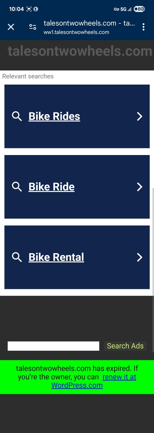

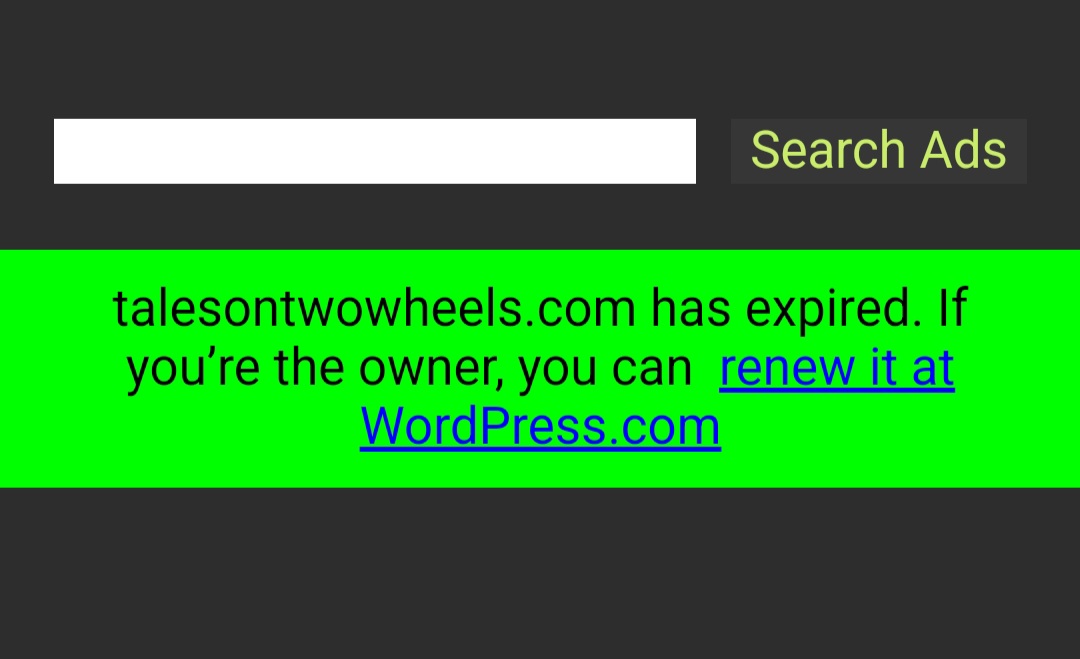

We might be able to raise enough money to have his website renewed??
Dani is probably the rightful owner now or Matt's wife, so there's probably some way to raise enough money to pay WordPress.com ??
WordPress has a free tier and expensive tiers. Certainly something can be done .

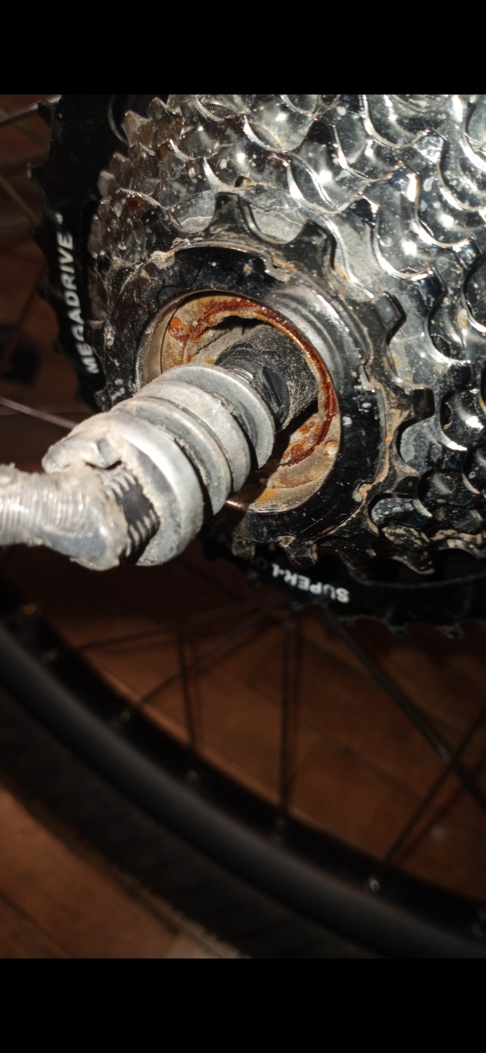

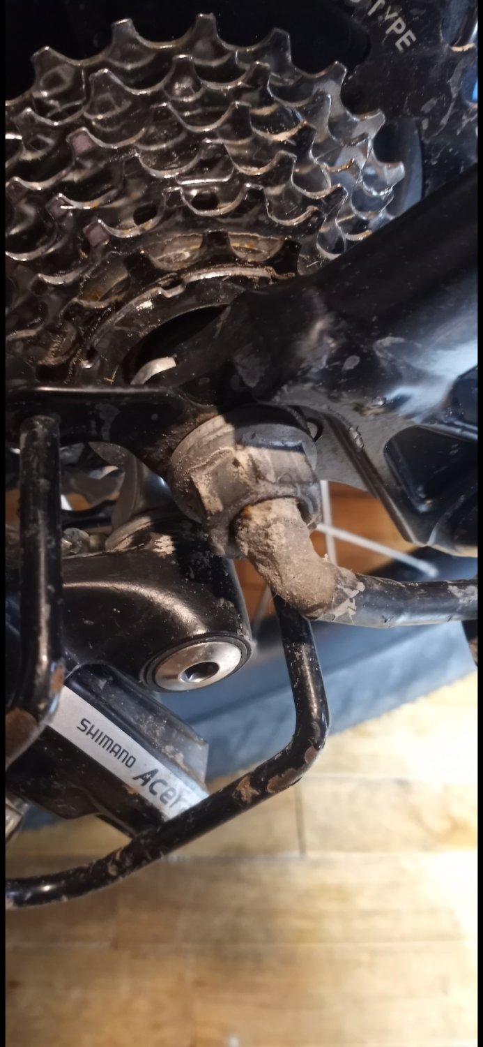

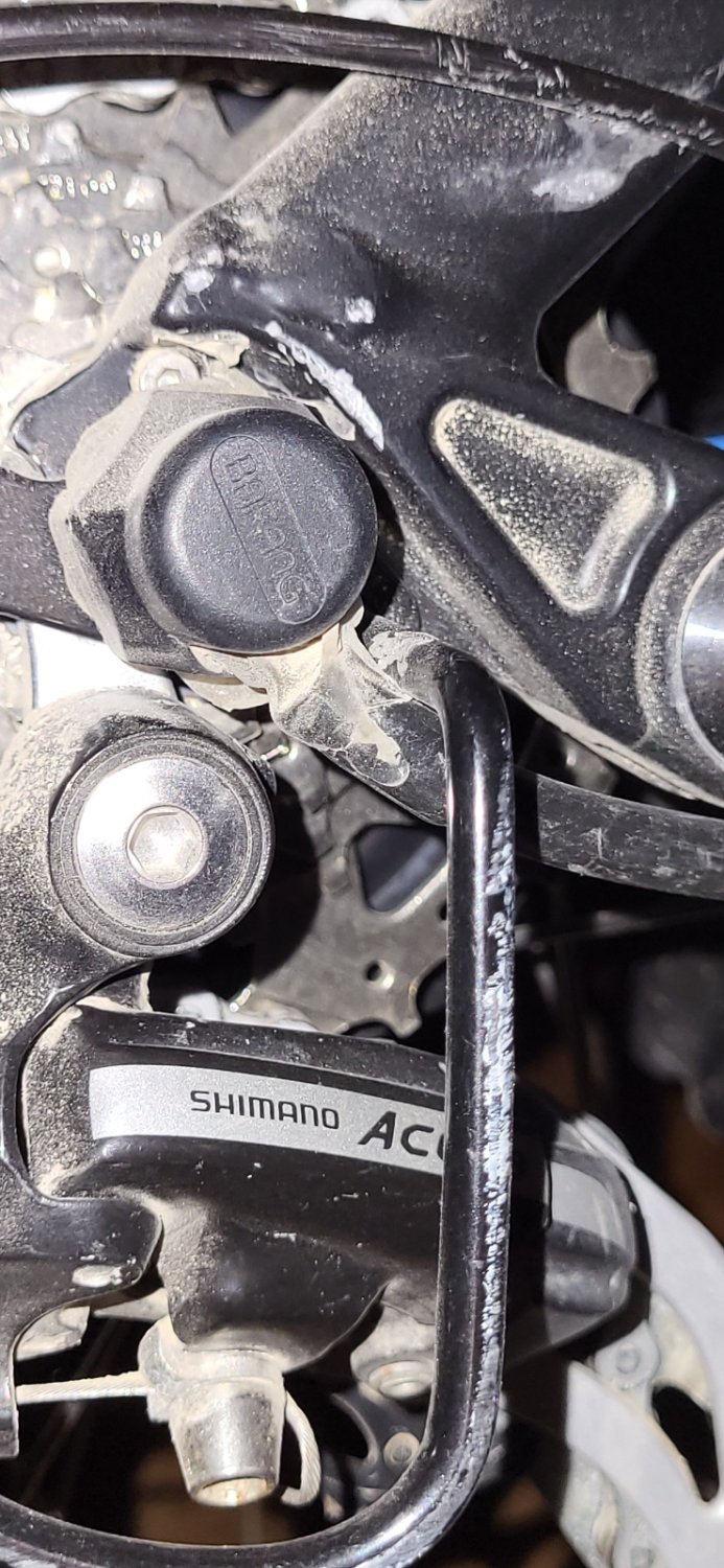

"It can come in thru the axle hole for the cable. I opened up a motor once and it was all rust inside."
After learning about how water is conveniently channeled along the motor cable and fed directly into the hub motor, I sealed up the wiring with silicone where it enters the axle,..
It seems to have worked, because it was rust free inside the motor when I opened it up to grease the gears.
When I put it back together, I squirted some airplane grease into the axle hole first, then some silicone in the hole, then some silicone in the little hub cap and stuck it on.
I made sure to not clean the cap first so I can remove it again without using my angle grinder or a bolt cutter. 😁

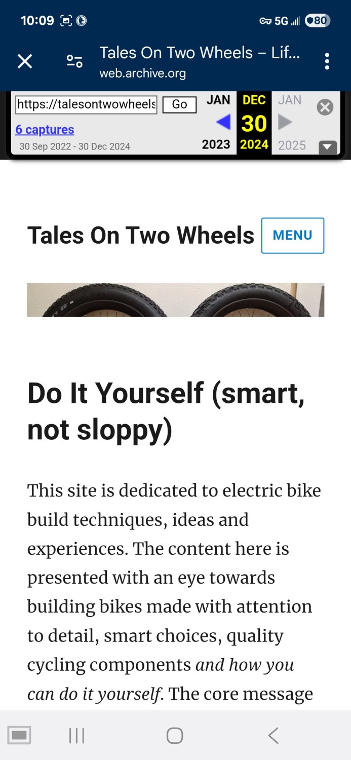

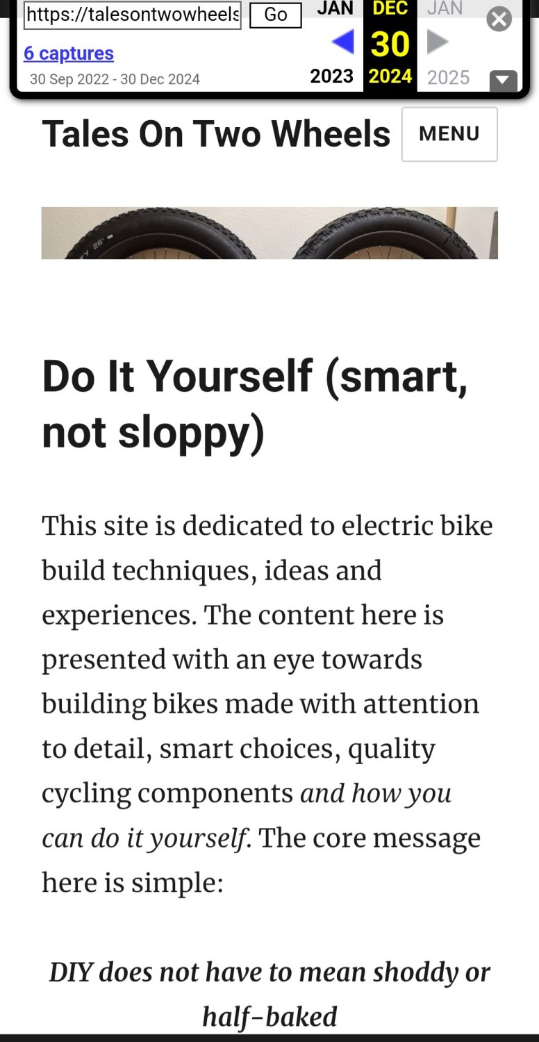

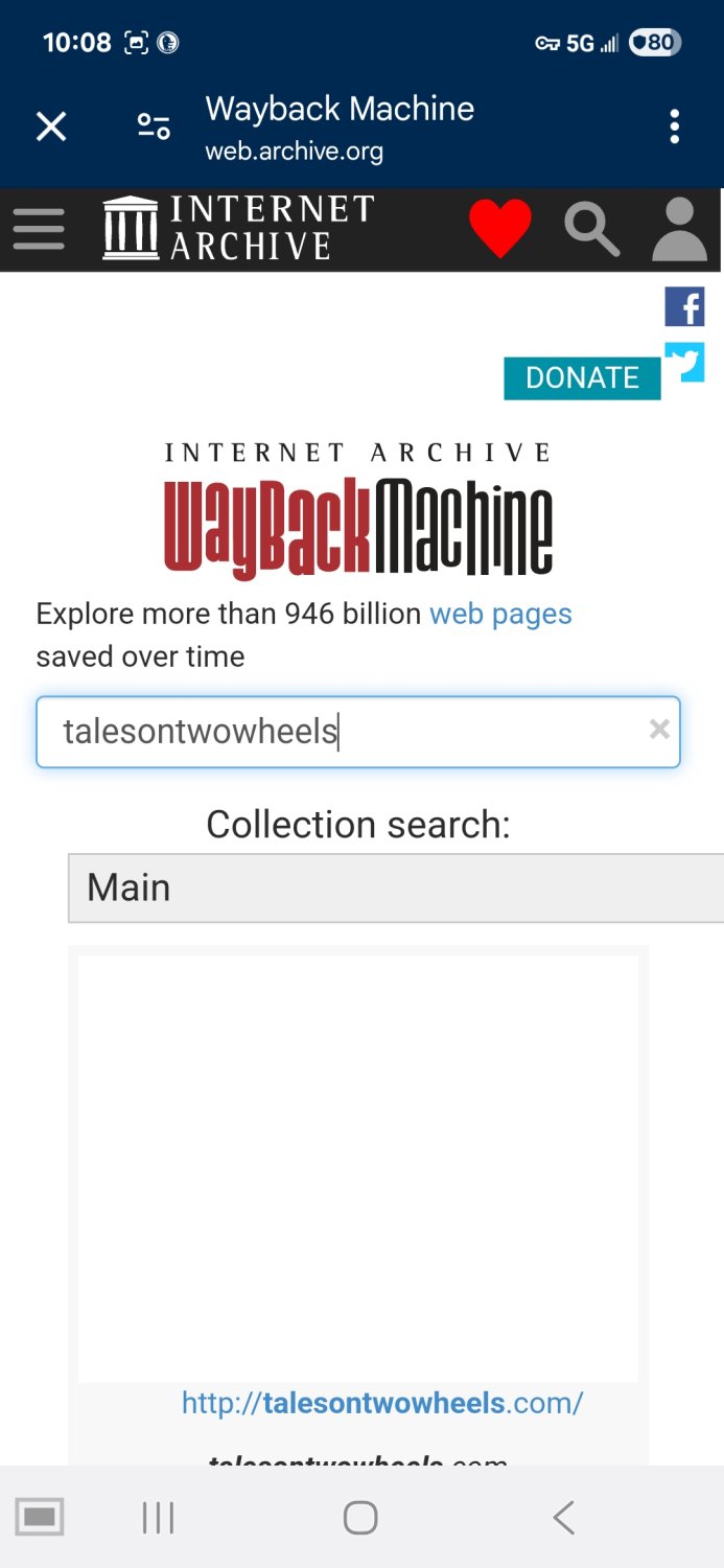

With the password you can get the entire site in a neat zip file, Iirc.
We could look at doing something with all of his content. Do we know who is the rightful owner of said content? We are not looking to steal his content, but it is also sad if it just drifts off into the Internet Abyss and is never seen again.
The only thing that I can think of is to send an email to the address associated with his ebr account and hopefully his daughter will pick up on it. We exchanged some pm, but not email.
If you check the OP supposedly a family friend Cody was to keep the website going.. so maybe that's still in the works.
Perhaps @tomjasz might have some personal contact info??
