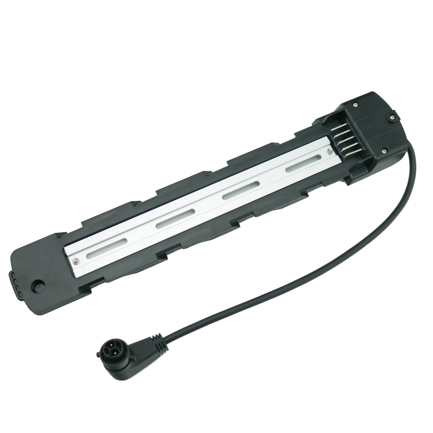

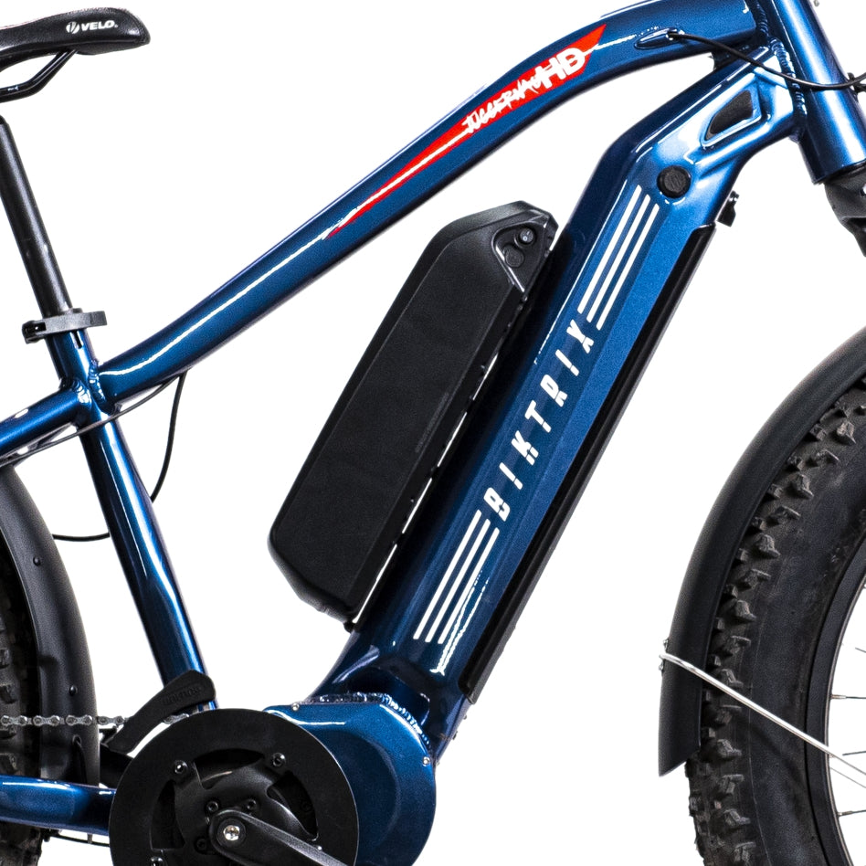

Sorry for the newbie question. It is a Juggernaut FS Pro 2. Stated it is a Reention Dorado that fits the bracket. I got a range extender bracket that fits on the frame for the second battery and just trying to source a battery...
The range extender battery for the Juggernaut uses a connector which could be difficult to find on a "generic" battery.
Biktrix offers two different range extender batteries for the bike. The OEM version, which uses quality Samsung, LG or Sanyo cells, goes for $749, depending on the capacity you want. They also have an off brand, lesser quality battery from Sinowatt for $549.
If you're comfortable with a lesser quality battery, assuming you can find a generic with the right connector, you probably won't find one for much less than $549.
I'm spending your money here but if it were me, I'd stick with one of the batteries sold by Biktrix.
James
This is the plug for the Duo series of battery brackets,
https://www.panmtrade.com/.../battery-connector-power-cs...?
On my Jugg 4 bike, it is wired Red to red and Black to black,
on the bracket and in the bike, no other wiring used/seen.
This is the bracket/plug on the Juggs 4 bike.
Make sure you use the correct plug type for these brackets, depending on your bike, as there is at least 3 different OEM types..
I made a 3' extension cable, so I could move the battery back to the rear rack and can use 1 of my 48v Wart Hog, 17.5a battery's as a back up if needed, for the long rides I like to do.
Another option is, make the extension cable and use a 5 flat pin plug, female Hailong end to plug into the bracket. (Amazon or Ebay for these Hailong plugs.)
I also found out that you can move the bracket up 1 screw hole and use the OEM washers, this also opens the step thru space quite a bit.
This extension plug opened the step thru space, so I don't trip myself. I hate falling over...as it's hard to get up when being tangled up in the bike and pucker brush...lol HTH's
