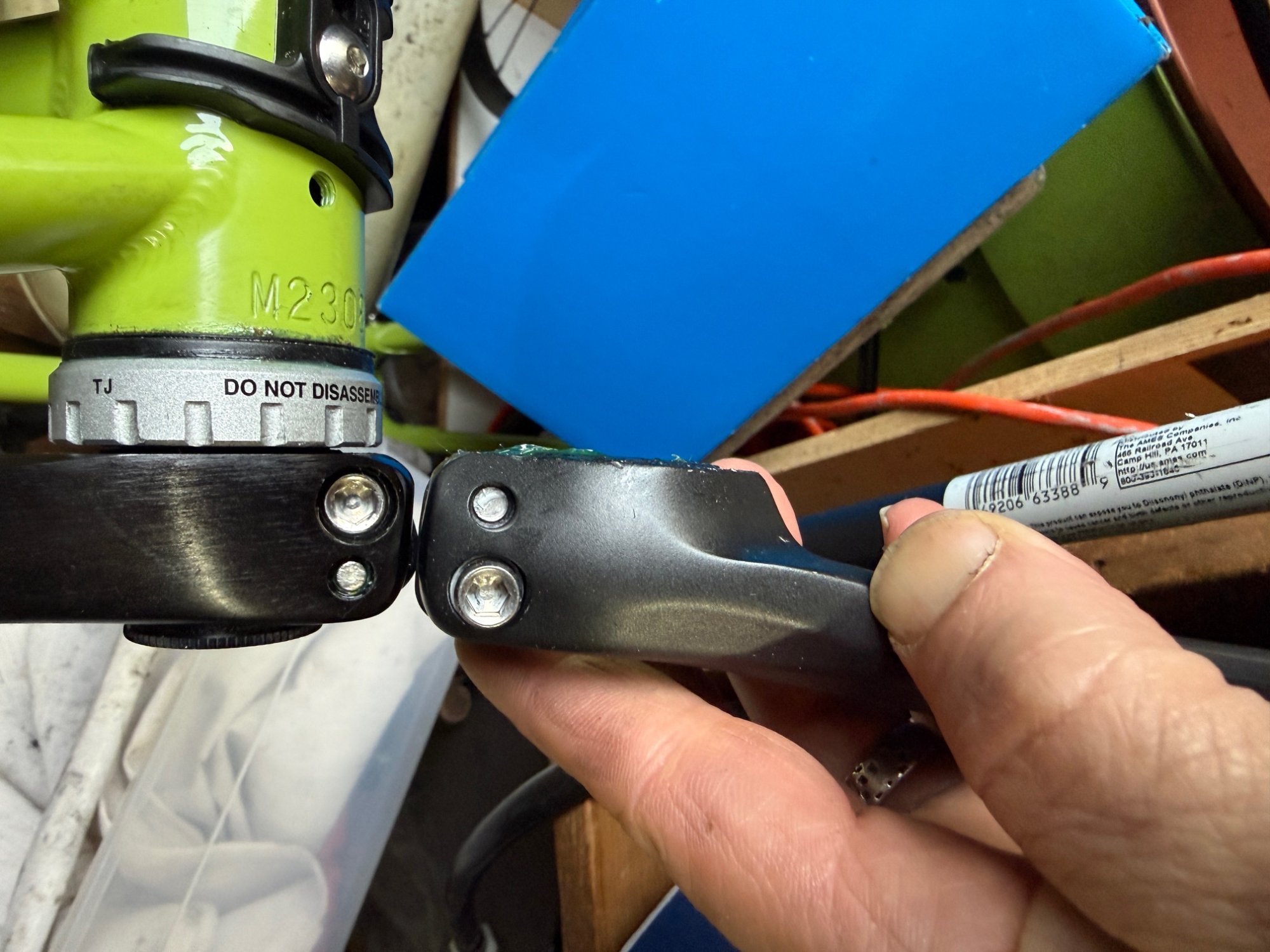

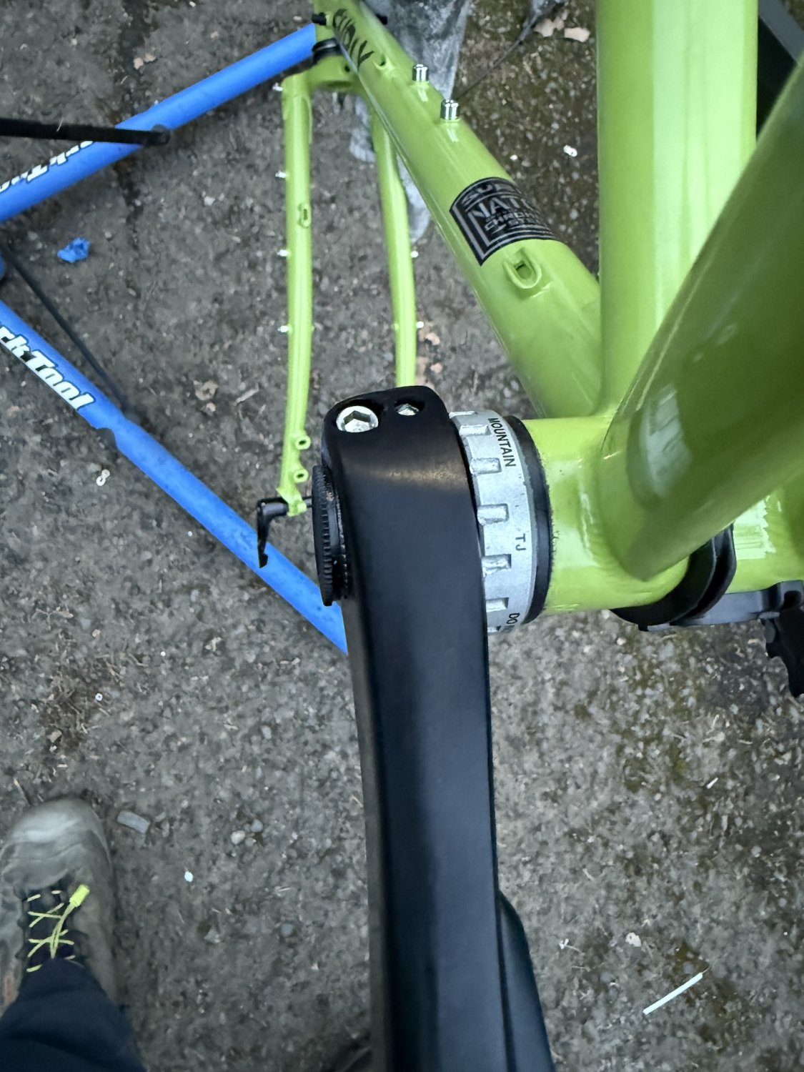

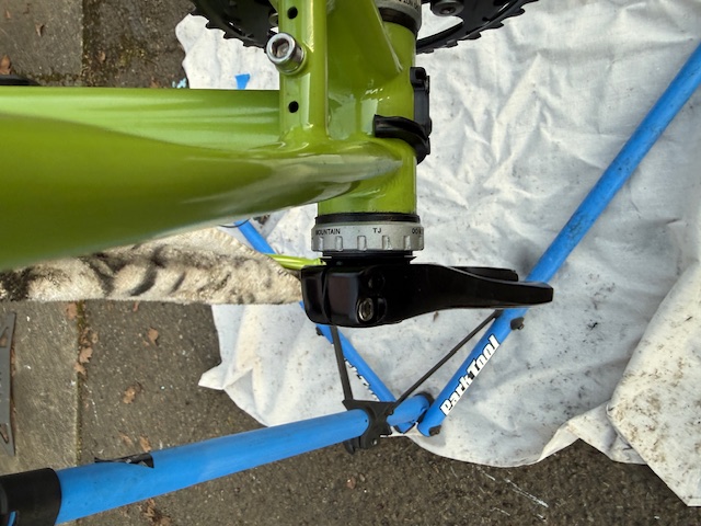

got the bottom bracket on. the left arm is a little thinner as it's a 105 arm so the screw does not quite sink in even with all the washers on the bottom bracket. think I need to put a washer behind the arm?

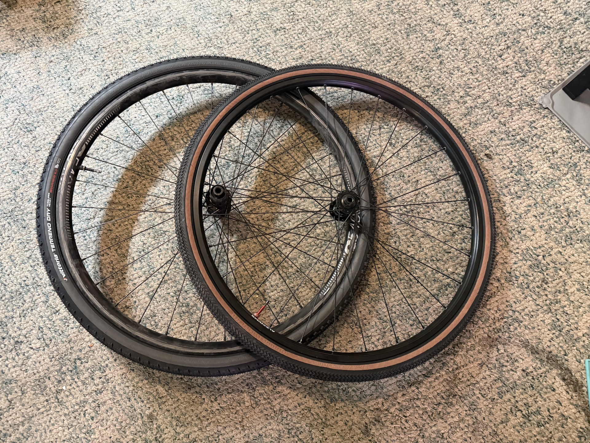

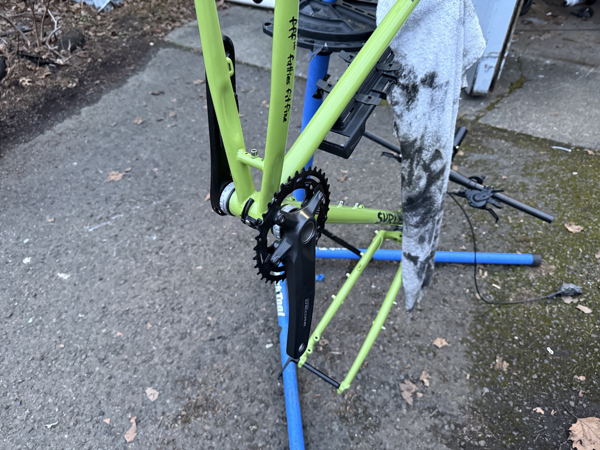

got the wheels all set up. I used the tires I had on hand. I got the specialized tires for 1/2 off. I was able to return all the spare tires I had for the trek.
Specialized's Sawtooth is THE adventure tire of choice, developed to handle any road surface and to be tough enough to withstand the rigors of exploration. The tread offers sharp angles and edges...
