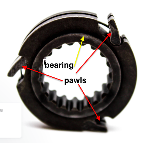

You can examine the clutch. Pretty simple to test. Just pay attention to the orientation when replaceing. If the pawls are stuck or the internal bearing doesn't spin freely, it's up for replacement.

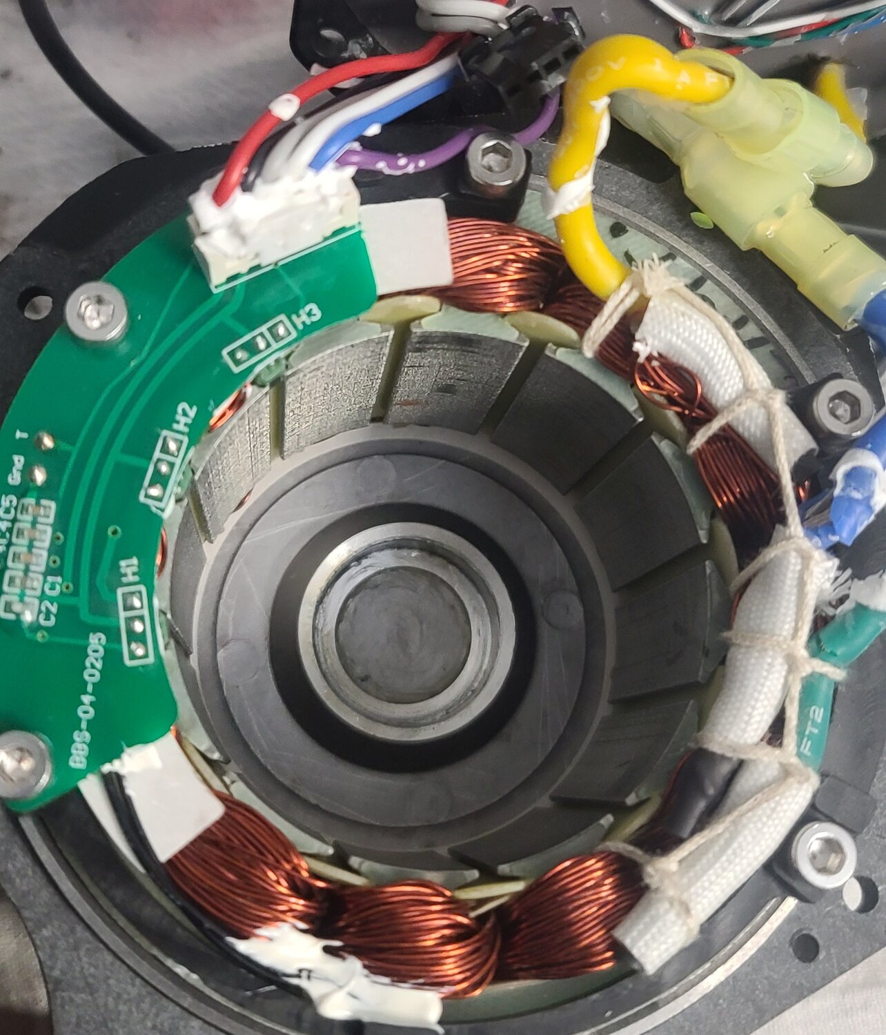

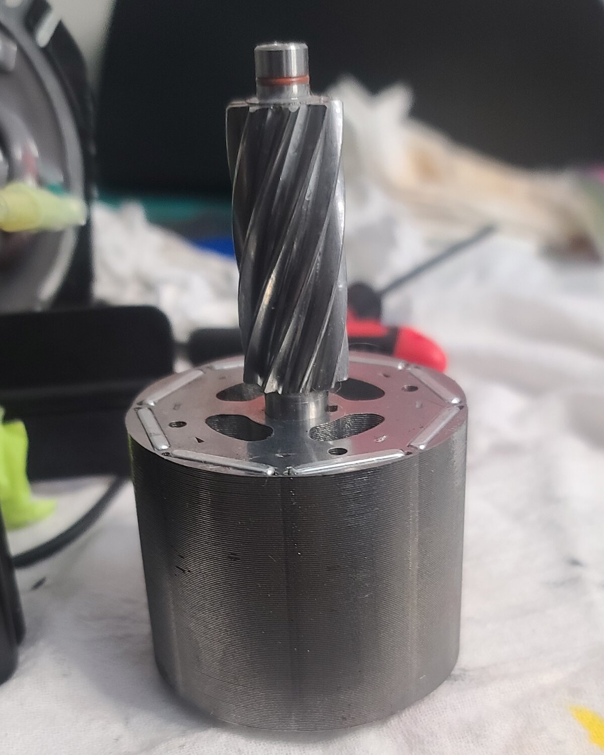

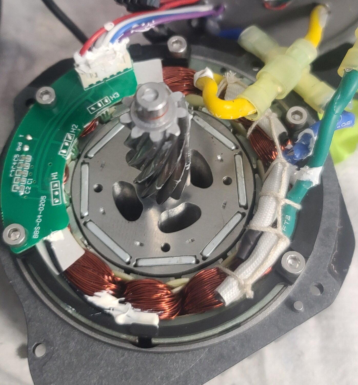

Yeah I did check the clutch and it looks in a very good shape. I opened the motor core to look at the rotor and I believe that's where the problem maybe. Because the rotor shaft is not spinning you can hear a hissing spin it's quiet but the actual rotor shaft doesn't kick in to spin especially on the low PAS. On high PAS it sometimes kicks in and spins with the loud noise which is to be expected since it's all open. So I took out the rotor to inspect and it seems fine to me. Unless there is something specific to look for I don't see any obvious sign of a problem. Some am stuck, could it be just the rotor or could it be the coils and all that stuff? I can't figure out how to attach videos on here otherwise I would post shot clips of what am trying to explain.
Thank you for helping. I do need all the help I can get.
Those are the pictures. I can seem to figure out how to post a shot video that would have been helpful in explaining what's going on.
