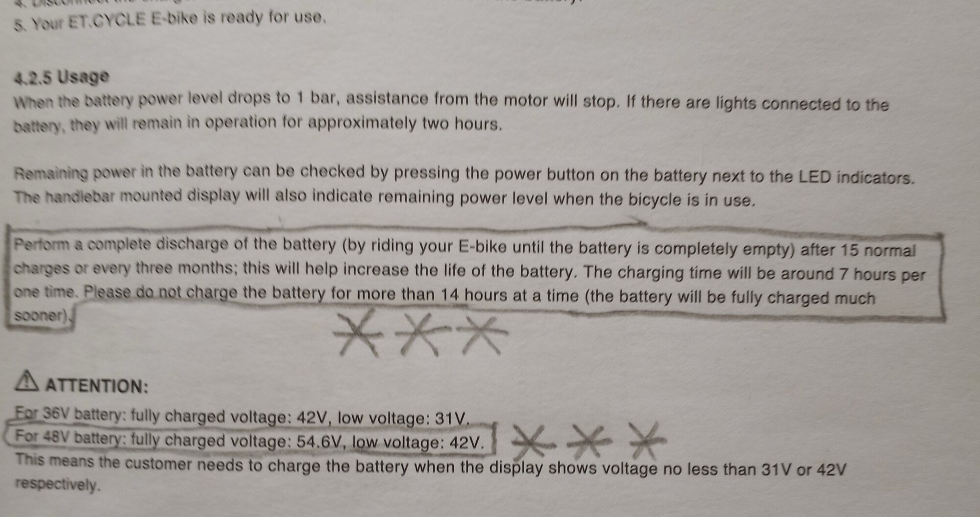

If your owners manual mentions that you should unplug your charger after a certain amount of time and leaving it plugged in for a while after the light turns green is OK, then you should be OK to try and balance the cells.
My owners manual (for my Das-Kit powered Et.Cycle T1000) says that the battery is fully charged after 7 hours but should be unplugged within 14 hours.
I don't want to give any bad or even dangerous advice, so if @harryS or anyone else thinks that this is a bad idea, then please say so.
I would suggest doing a long charge with the battery and charger in the safest place you can find, where a fire won't burn down your home.
