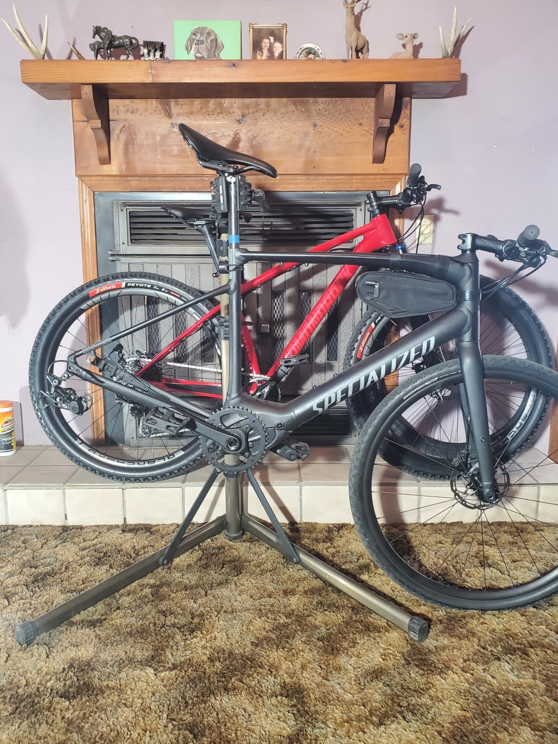

'21 model with 4,400 miles, battery 100%. The Deore 10s developed stiction in the clutch which chewed up two tension wheels before I figured out what was going on. Tinkered with the clutch and got disgusted, I want to retire it and hopefully upgrade.
Help a snowbound Arkansan here - HG driver, 10 or 11s, 11/42t higher maybe but no 10t, model preference GX, XT, NX
NX 11 with the SunRace 11-42t appears to be pnp (please confirm) since Spec used this on some models and I do consider NX an upgrade, but shouldn't that same SunRace work with GX 11 mech? If not, any other options within criteria?
